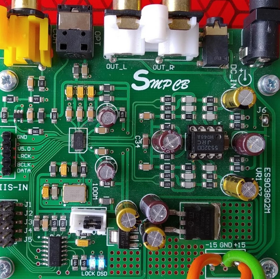

Hi, if anyone interested, I can provide gerber data / schematics / BOM for an IV stage based on the experience gathered in this group. It can be used as an IV addon for the usual ES9038Q2M boards, and it contains also a few low noise LDOs for every auxiliary functions. As I designed it, I realized, that the only thing I need from the original board is the ES9038Q2M chip itself... So finally I also placed the footprint of this chip as well on this PCB...
Only drawback of this design, that it's not DIY friendly: only for experienced guys with good soldering experience. (SMD only).
It's a small PCB, with 4 layers, 63x92mm, so, quite cheap to produce at JLCPCB (I paid 7$ + postage for 5 pieces).
I have produced one piece for myself, transferred the ES9038Q2M from the original board to this one, sounds quite good, however I cannot measure it without proper equipment. I just run it on DSD signals (AK4137), cannot evaluate PCM.

meszarosa,
Nice. Please do share the details. I'm sure some people will be interested, perhaps all the more so now that ES9038Q2M can be obtained from Mouser.
Not yet. Interested to volunteer?
Maybe. Most of my layout experience is with Cadence Virtuoso. So a little different from PCB.
I bought pcbCAD720 but it is a bit too different from what I would like in a CAD program. I was considering trying KiCAD a second time. Then there is also Eagle.
Any suggestions or recommendations? Three op amps with nice bypassing, ground plane and good capacitor and resistor choices should be a reasonable starting project.
Some people are saying kicad is getting pretty decent these days. Haven't tried it myself though.

Hereby I try to attach schematics and layer structure of his PCB. Check, if it suits your needs. If needed, gerber data / excel BOM can be added as well. Let me know.
View attachment ivstage.pdf
View attachment ivstage_layers.pdf
