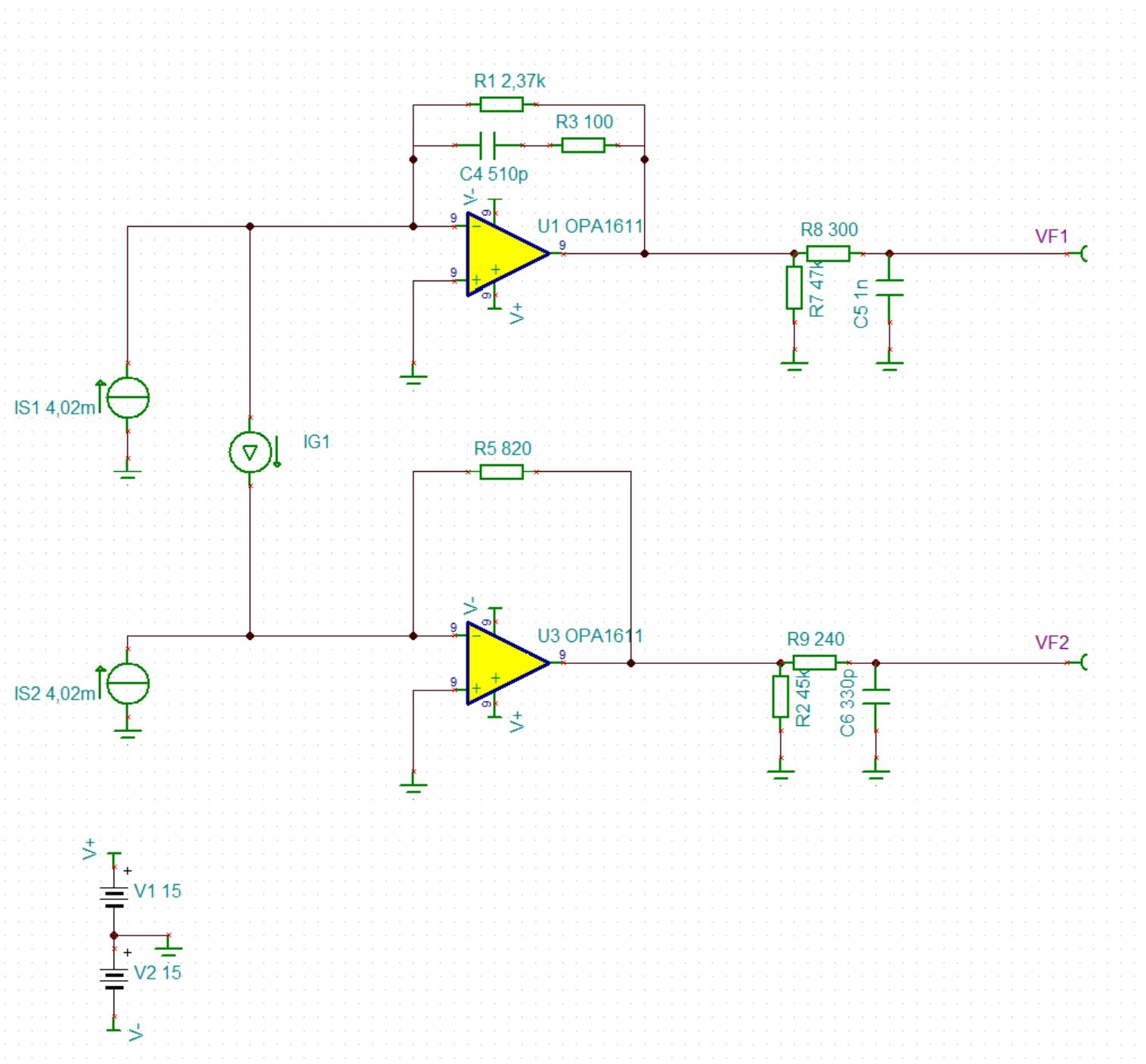

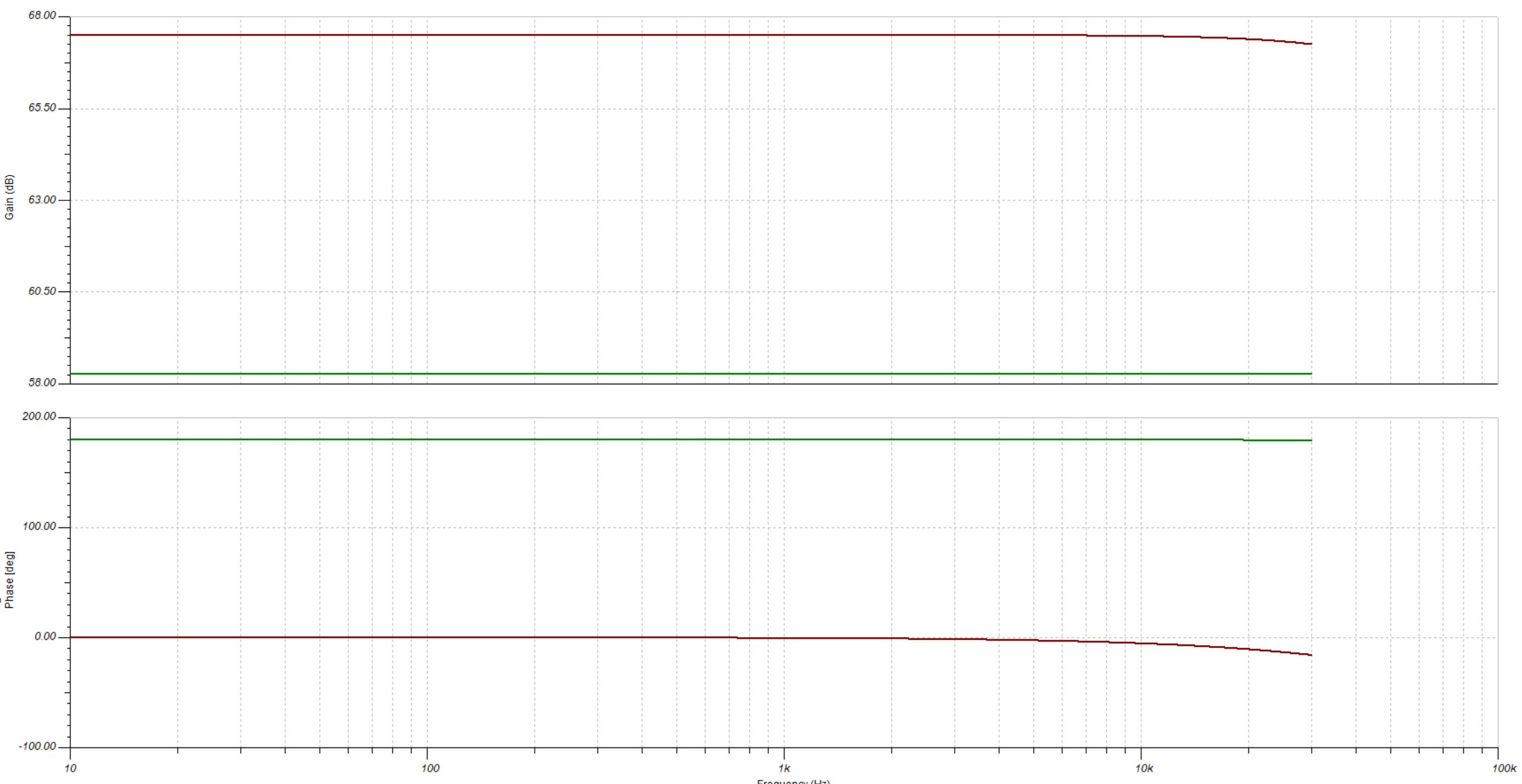

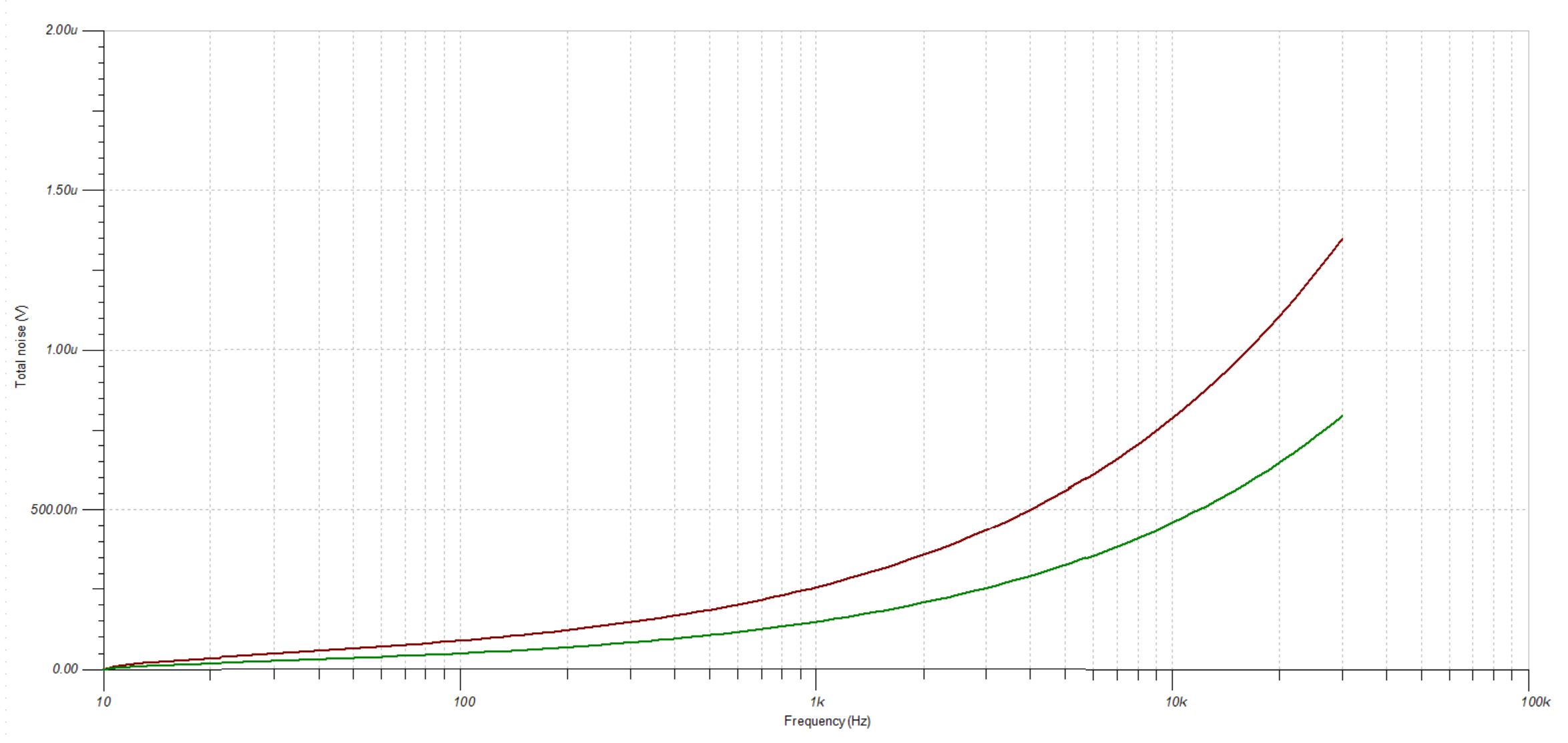

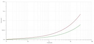

Great... Before into deep in registers. I did some simulations with I/V. Green is single resistor.
The suggested values give bad performance compared with a single fb resistor. Pls see attached files. What is the downside of this if we ignore small gain penalty?
Rdac= 774 ohm If avcc = 3.3v then Vopp = (0,906*3.3) = 2,9898v so p2p output current is ( 1000 x 2,9898 ) / 744 = 4,019mA

We need to deal with multiple problems in a dac output stage, not just noise. Sigma Delta dac chips produce some RF on their analog outputs. Some of it is clock pulse related and some of it is broadband frequency-shaped random noise. In my view, others may disagree, the ESS hump distortion is caused by the RF mixed in with the audio signals as all that junk passes through the I/V stage and then the differential summing stage. We need to attenuate all that RF garbage enough while its still in the dac box so that it won't negatively affect performance of downstream preamps and or power amps (not to mention some people's concern about possible effects on extended frequency tweeters).
Also, I sincerely hope you will spend some time learning how to listen so you can recognize when at least some problems become audibly objectionable. There is more to getting this right than you probably imagine now. Doing sims and measurements can catch a lot of things but I don't believe it catches them all, at least not the way it is commonly done now.
