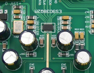

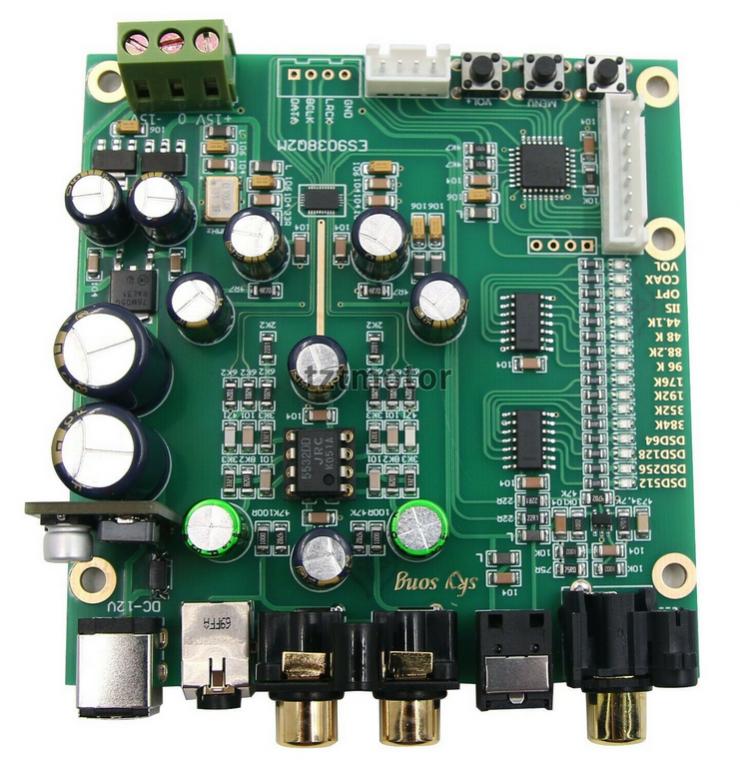

For example, I have attached pictures of a $50 ES9038Q2M. It would be helpful for me to understand where it is deficient and what needs to be improved. Is it the op amp on the output? The layout around the op amp? Grounding? Capacitor placement? The capacitors themselves? Is it the layout around the ES9038Q2M? The bypassing of the ES9038Q2M? Is it the power supplies? Are they too noisy?

The pics you posted in your last post are of a board I would not want to use. The ground plane on the back of that one is all broken up with traces to light up the LEDs. Too bad about that one.
Regarding the ES9038Q2M board we typically mod in this thread, they need a lot of work to sound better. First couple of mods that give the most improvement are a new add-on output stage, and a new AVCC regulator. Schematics for those can be found attached to post #3003 in this thread. I can give you a link to my dropbox if you want to see an example of how to build the output stage and attach it to the dac board.
After those two mods, dedicated voltage regulators for each of VCCA, DVCC, the clock. Also, a clock upgrade is useful at that point.
Another mod to do at some point is to take control of dac chip registers using an Arduino or other MCU of your choice. Sound quality can be improved considerably by reducing DPLL bandwidth as much as possible, as recommended by ESS. Most cheap dacs leave DPLL bandwidth at the rather high default setting.
Power supplies for the output stage and for the AVCC regulator need acquired. R-core transformer is recommended to powering preregulators, or else maybe sufficient CRCRC filtering, prior to the final output stage, and dac chip and clock, regulators.

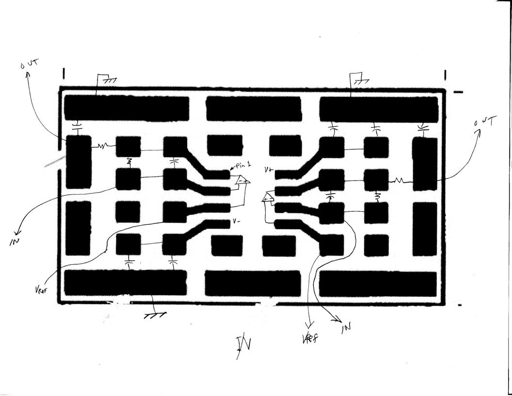

Also considered building the same output stage as above only in SMD. A couple of attachments below may illustrate the concept.
Did anyone do a layout with Eagle or pcbCAD720? It would easily fit in the super cheap 100mm x 100mm size limit specials.
