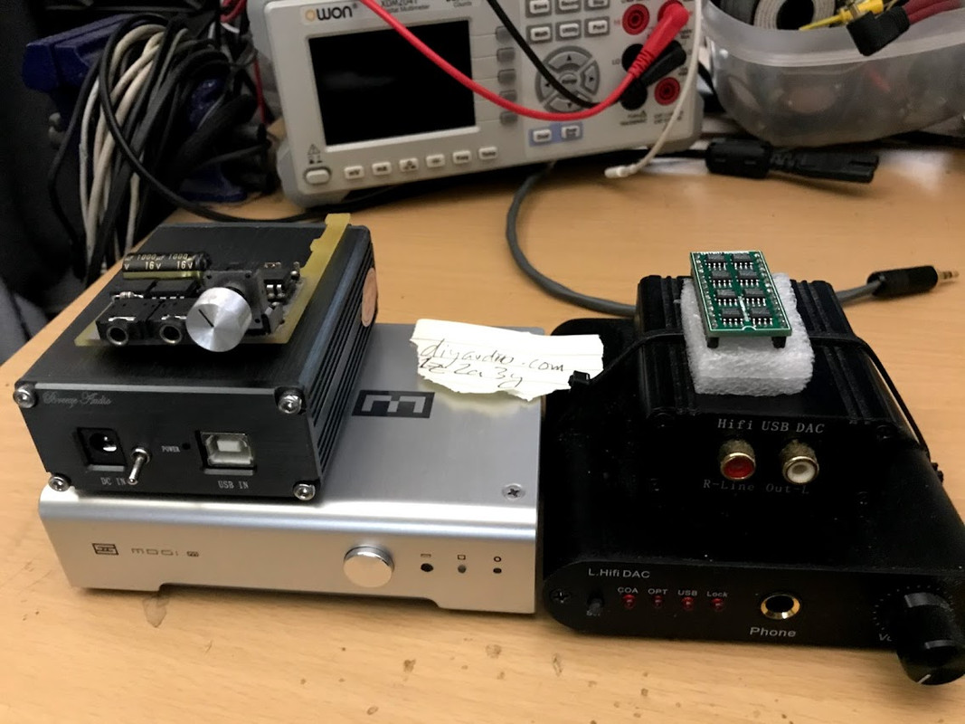

Just thought I'd authenticate my own efforts into some of the subjects of this thread with these snaps ... I also have much other stuff like the aforementioned q2b-based hifime DAC (dongle).As opposed to your pointless one.

In which case what pray was the relevance of introducing a pic featuring a TDA1387*8 module? Plus multibit boxed DACs too?

I own several other devices that I could also share images of, including a Denefrips Ares II (discrere r2r ladder dac), Fiio m11 pro (akm4497 DAP), etc., etc.
Meanwhile, indiv. like you and rfbrw have contributed NOTHING related to the 9038q2m. Rather, you use this thread to vent childish emotions, curious allegations and other off-topicals and non-sequitur. Alas this is a long thread and I may have missed one of your ON-TOPIC posts ... if so provide those links here:

The other dacs were shown in the same photo as the 9038q2m-based Breeeze Audio device as: (a) proof of ownership of multiple dacs; (b) as proof of interest in multiple devices with myriad dac topologies (S-D, multibit, OS, NOS) to compare the 9038q2m with.But it was clearly you who introduced that topic into a thread which is ostensibly about developing a DAC based on ES9038q2m. And I cannot think why I might 'choose to vent'. Can you think of a reason?
