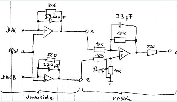

In addition, I wanted to post the output stage schematic I used for my board that goes along with the pictures shown with the modding descriptions, so that is attached below along with the dac chip pinout. There is no schematic of power regulation mods, but I can describe those in more detail if needed.

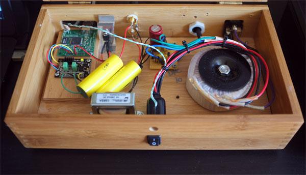

I wish the article had some pics with the case cover off.
Don't know about that particular model, but there is picture of one version out there I will post below. No wonder it doesn't sound like DAC-3, or a modded Chinese dac for that matter. I would say it looks closer to one of our modded dacs though. One difference is I couldn't use a wooden box for my modded dac because the LME49720 opamps are probably best put in a steel box just in case of any DECT phone base stations nearby. 🙂
