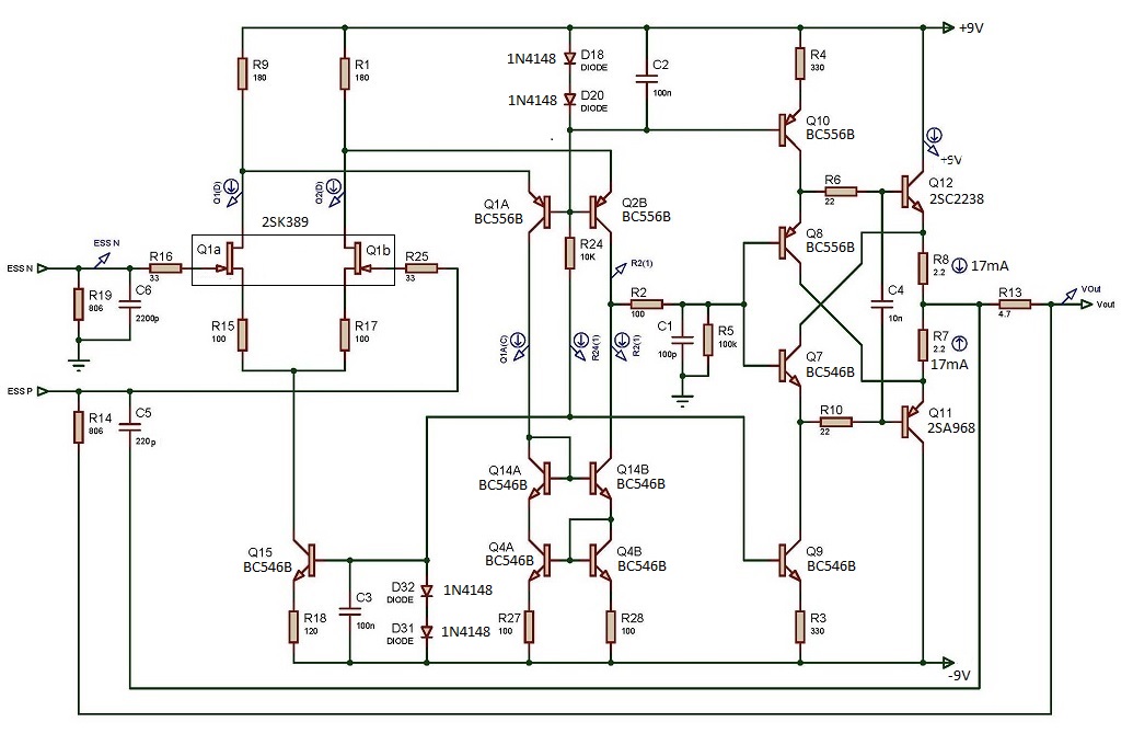

Hello Blackfear, Wow, I am amazed that you took on something this complicated and got it to work, especially after having to fight oscillation problems. I really have to admire your work ethic and willingness to take on something like this. Don't know how much you know about oscillations and how to troubleshoot them, but it is possible we could have given you some help along the way if we knew what you were struggling with. So long as you figured it out, credit to you for doing so.
What I would say next I don't know if you will like hearing or not, but I feel like I should say something about it so you know, and so other people reading along can maybe learn about output stages at the same time.
It looks like you have made a discrete opamp and then configured it with some resistors and capacitors to work not exactly as a voltage output stage, and not exactly as a current output stage, but rather something in between. R19 sort of nearly matches the output R of the dac output, so that makes the non-inverting input impedance right in the middle between voltage and current modes. R14 and the opamap gain makes the inverting input see a similar load as the non-inverting input. Nowhere is the +1.65v reference voltage from AVCC used for anything, just another observation.
While I am still in awe that you would do all this, I am sorry to have to tell you that I think you could get the distortion down much lower and better SQ if you would not use this output stage, and instead change it to a normal ESS recommended type of 3-integrated-opamps-per-channel, I/V-and-differential-summing-with-filtering type of output stage. While I feel bad having to say that, I don't think it would be an option for me not to say it in case you don't already know about it, and in case you would like better sound quality. On the other hand, if you are happy with it as it is after all the work you have put into it, well, that's cool too, I guess.
Regarding AVCC, I am not sure what you are asking about with regard to increasing AVCC capacitors. My AVCC capacitors at the dac AVCC input pins are 47uf, but there are LME49720 opamps under the PCB that regulate voltage into the capacitors, so 47uf is a good value in that case. If I could see a schematic of what you are doing for AVCC, I could perhaps give better advice about capacitors for that case. If by chance you are using the original AVCC circuit that comes with the dac board, and you want to leave it that way except for capacitors, then the more capacitance the better. Victor said he used 3 x 1800uf per channel soldered to the AVCC cap pins on the bottom of the board, as one example of what you could do.

Hello Mark, thanks for your response and kind words...this schema was designed by one person who reccomended to use discrete output stage instead opamp one, especially this basic one onto china board, what i can say abot this class A stage is that sound is very detailed open but not "hard" rather soft and smooth but also stay dynamic...basic opamp stage SQ was more transparent, unbalanced like with some distortion on high middles and highs...as i said from start i fight with some oscillation and reducing feedback capacitor helped and also softened sound...(seems that high oscillation caues high distortions)Hello Blackfear, Wow, I am amazed that you took on something this complicated and got it to work, especially after having to fight oscillation problems. <snip>
But your idea to use simple output stage (recommedned by ESS) with 3 opamps is not bad and i could compare SQ against my stage... which schema shall i exactly use, and which opamps would you recommended ? regarding Avcc voltage, i was only asking if i use 2 separate power supply 3.3V-3042 for each channel of china board (remove regulator or interrupt feeding of 3.3v of each channelonto desc) so it should help with better SQ and also increasing capacitor directly behind china PCB parallel to original one (100uF are there if I am not wromg...)...thanks Vita
