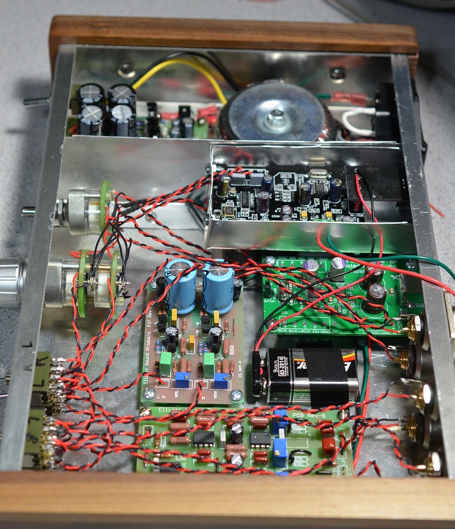

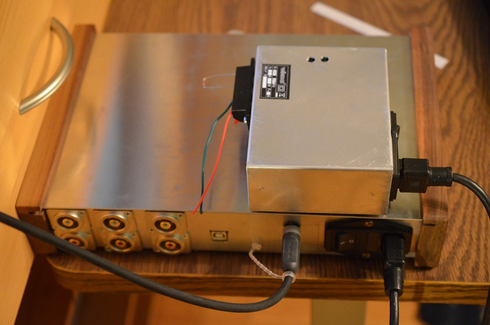

I thought I'd share my implementation of the DAC. It's part of a preamplifier/ control center containing an Elliott Sounds Products (ESP) preamplifier, ESP active X-over, ESP 15V power supply and a Twisted Pear USB DAC. It's enclosure, made by me from aluminum sheet metal, is above some fuses and power wires. I'm using a TOSLINK input module powered by the 9V battery. Notice my Velleman benchtop power supply sitting on top of the case. Of course, this is temporary until the power supply boards arrive.
The sound? I'm listening to Windows lossless files through my computer. I'm using Carlos Mergulhao's DX Blame driving a pair of Vandersteen 3's.
I don't have a good reference to which to compare it, as my Twisted Pear mysteriously stopped working months ago, and I've gotten accustomed to my computer's analog out🙁.
First thing I noticed was that sound was a bit muffled and lacked detail - maybe rolled off at the highs a bit? Next thing I noticed was that many notes and drums seem to have more "punch" like maybe a faster attack. Then I noticed a big improvement in channel separation. It's hard to give subjective impressions when I'm accustomed to listening to bad (computer's analog out) sound, and don't have anything good to which to compare it. Also, note that I still haven't replaced C8 or C19 yet.
That's it for me! I'm looking forward to the power supply boards!

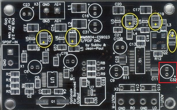

Can anyone point me to where i can find some information about the balanced version. i still have 6 board to play with 😀.
Any major benefits from the balanced version?
I made a small change and relocated the 3 x 51R (R7,R8 and R9) to a small adaptor card to allow unplugging of the s/pdif section when I wanted so I can connect a USB-I2S module here.
Also did anyone try using small value film cap with less than few uF at C9 and C32 ? How's the result ?
