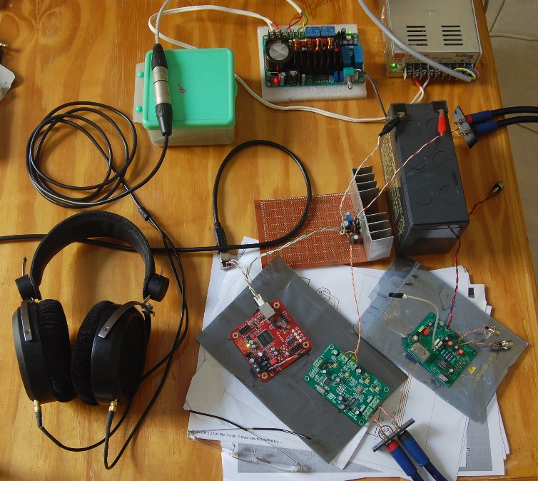

Currently I have no speaker (stereo speaker I mean) after my two speaker systems each have one channel dead; too bad I know... but unfortunately they could not be mixed... to differ on sensitivity with one 93db and 86dB on the other one. So, the best I could use is my headphone system below:
WinXP with Fidelizer with Foobar 0.8.3 -> Luckit WaveIO async USB to S/PDIF -> JP/Subbu's DAC -> HiFiMe T2 (rev 1) Tripath Tk2050 -> HeadDirect/Hifiman HE-5LE orthodynamic/planar headphone.
The Wave IO and JP DAC is powered through SLA battery (12V, LM317 regulated to 5V). The Wave IO is also conencted to my PC only using the USB data pins, the power is taken directly from the regulator.
The T2 is powered by Meanwell S-350-36 36Volt.
This modest system (except the headphone) acquisition actually happen since I made known each of them from DIYAudio forum. So, thank you DIYAudio forum for enable me to get this very high quality audio in very limited budget. The HE5LE headphone was in heavily used condition with one arm already broken and replaced with DIY metal rod. This HE5LE is the very unit that is reviewed on headfonia.com; it has traveled to many hands before settled down to me 6 month ago.

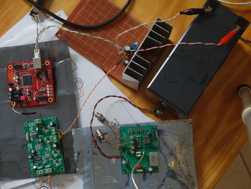

One more closer picture showing the DAC and the other parts...

just realized that the pictures did not come up properly....
