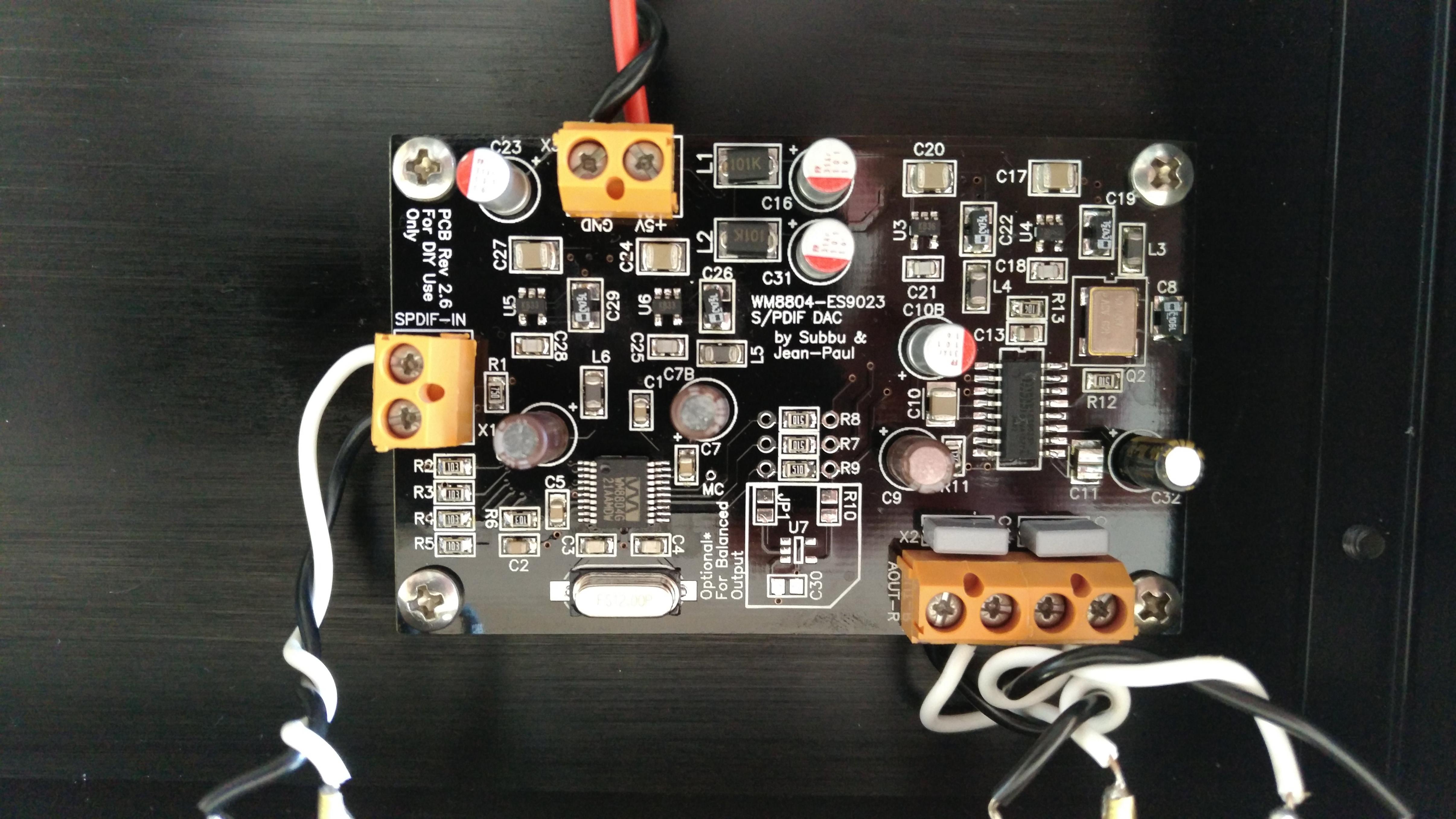

This project got sidetracked... life... back in the saddle. 😀 First smd project - enjoyed working with these little critters. Finished the boards except for receiver and dac chips. Waiting for chassis... will test voltages before chips are soldered. JP, just noticed your comments re ceramic output caps 🙁 will replace later. Any comments welcome. :up:

Please take note yours is a V2.6 which has different part numbers but it is very similar. It seems you soldered C32 in reverse ! I recall the + being wrong on the PCB. Measure it to be sure and replace the cap in case I am right. The pin it decouples has a negative voltage. Replace C8 for a tantalum 10 µF 10V or 16V. + to the upper side of the PCB. The ceramic caps after the MIC regs might make the regs oscillate, please use tantalums there.
After much investigation we also found out that it does not sound optimal without chips 😉 BTW how will you be soldering those on the board now ?
Belated thanks for the advice Jean-Paul, especially regarding the chip requirements ;-) Chips soldered with an smd reflow workstation. Finally got this project finished. On power up, only getting sound out of right channel, left completely silent. Any help appreciated.

I can not see the output wires well enough but it is not the 2 middle pins that are GND. It is output-GND-output-GND. *This was changed in V3*. You can see this easily when you turn the PCB upside down. Or measure continuity from the power supply GND to the 4 output pins.

First measure if the right output is shorted to GND (very thin solder whisker or something like that). Then if that is not the case you could play back a sinus test signal and measure straight at the output pin of the chip. This to check if there is a PCB track or via cut.
If the chip is OK it should be a simple issue.
All voltages are within spec except for:
C20 4.37V (4.80)
C11 -1.7 (-2.20) 1.75 (1.25)
L-Output - 0.23 KOhms
R-Output - OL
With test tone: Both pins of ES9023 show tone freq on multimeter. Will pull board out tonight to check outputs soldering.
Sweet music! 🙂 Thank you Jean-Paul for your assistance. Traced signal from output pads back to output pin vias of dac chip - no signal. Cold solder joint on pin 8. Listened for a few hours last night, what a huge improvement on the Zero dac I have been using for the last few years. Respect to you and Subbu for a fantastic project.
