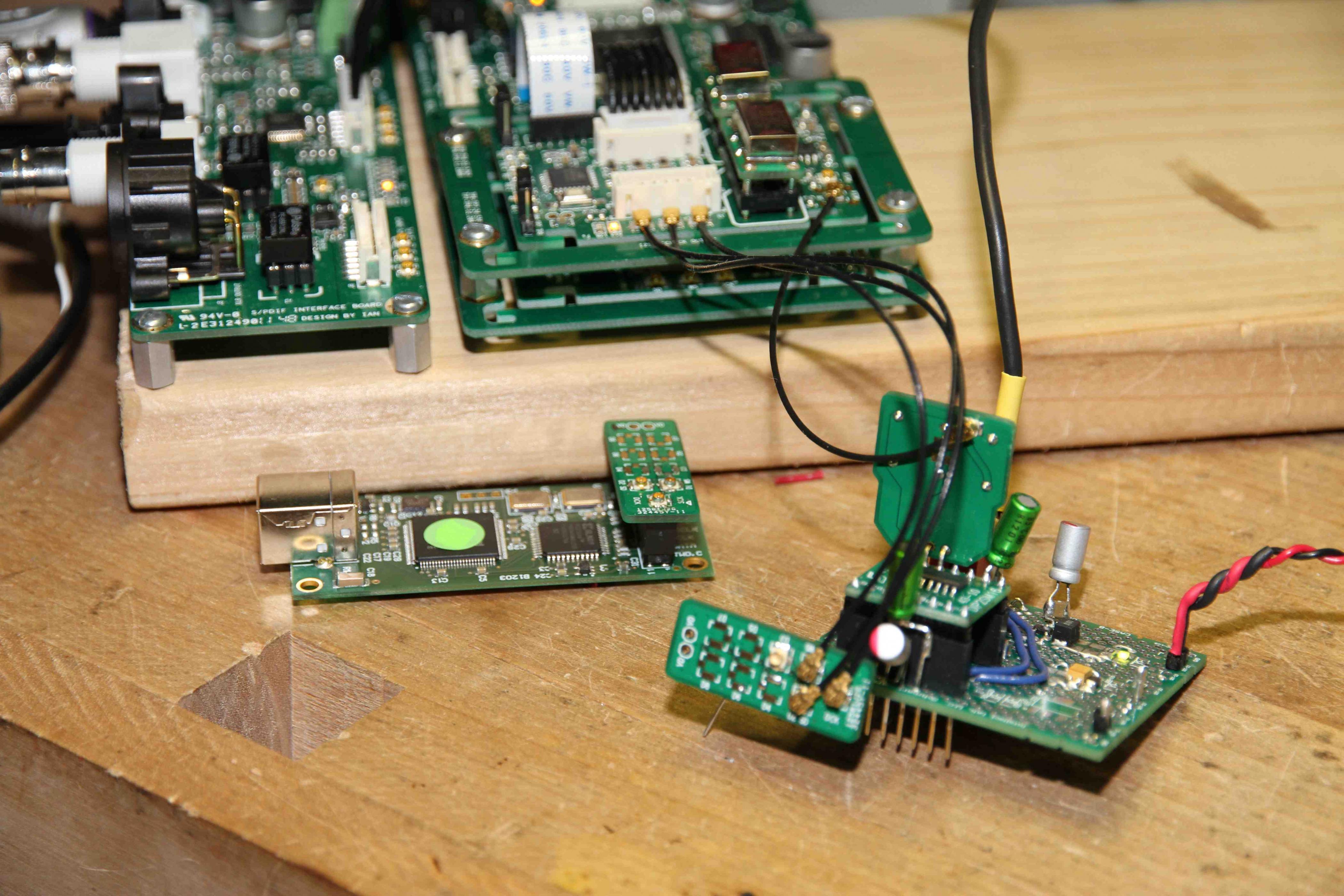

This is not my final layout and case is just a temp one, Git JG buffer and another usb to I2S coming, plan to rip it apart fot another case.

I am going to use the Amanero USB to I2S interface just need to figure how to switch between different I2S sources.

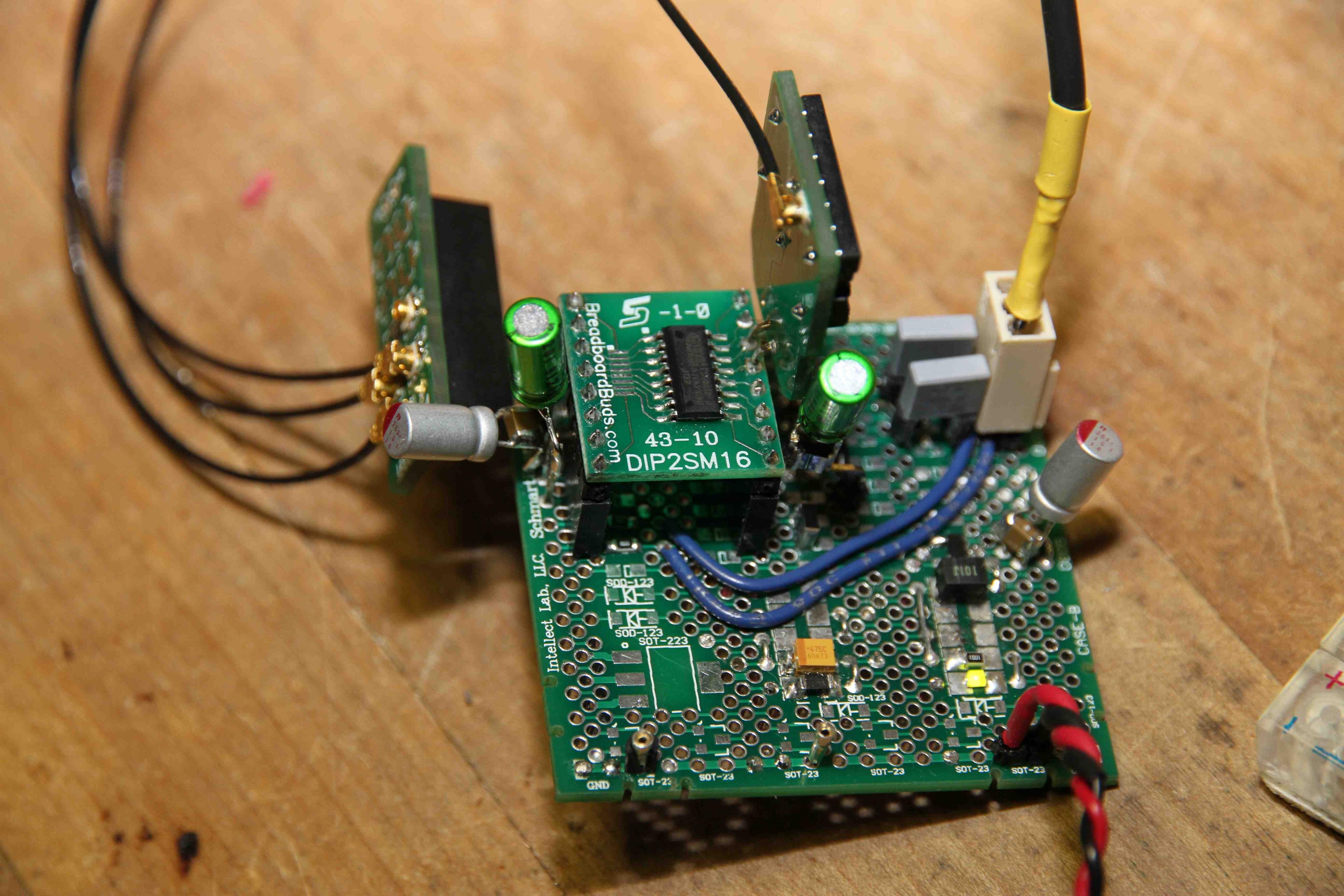

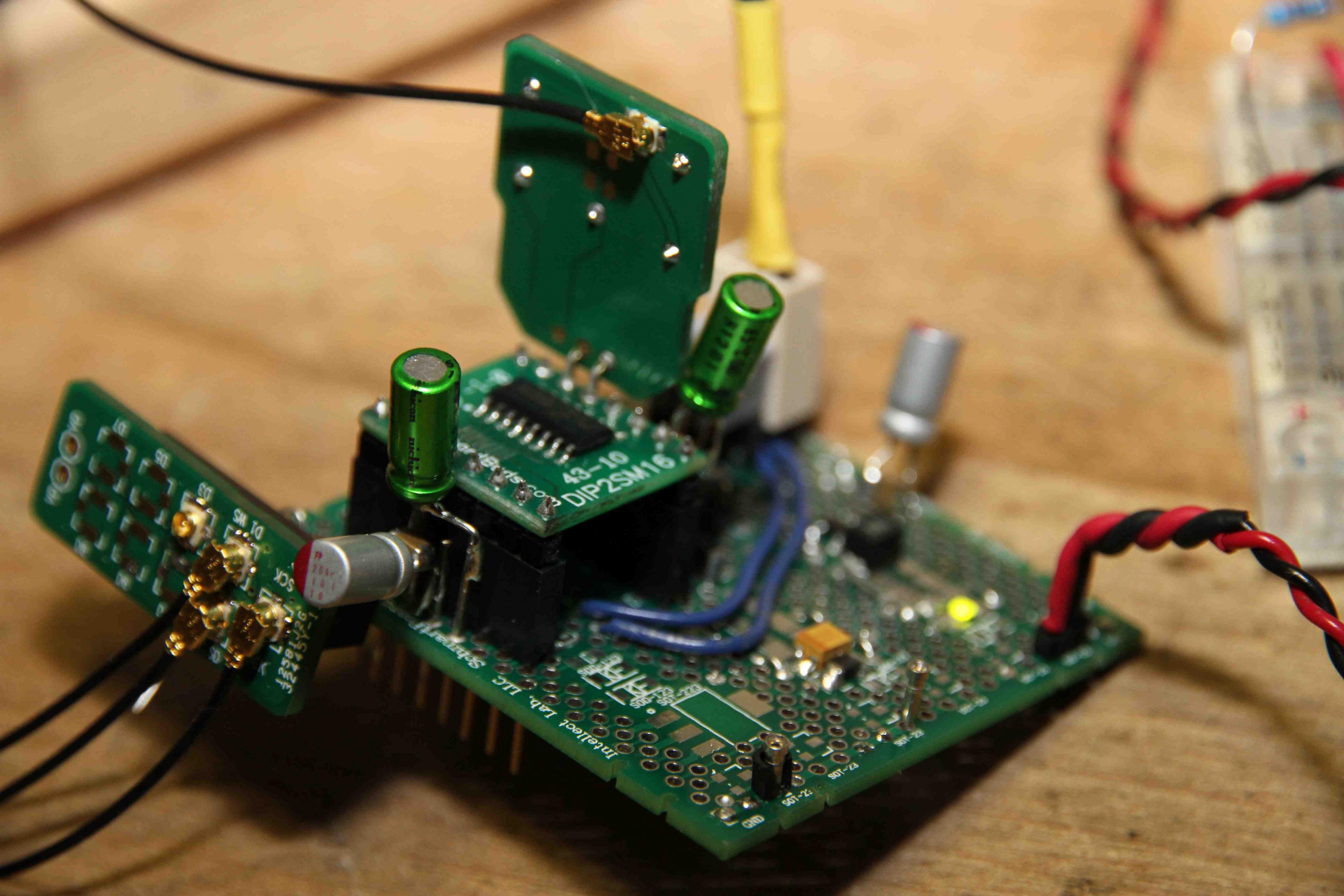

I see we've got the same goal, I'm trying to connect Amanero's stick using I2S too 😉
From what I've understood, in PCM mode, 5 pins are concerned :
3 - Data Stream
4 - Clock
5 - Frame Sync
6 - Master Clock
8 - Ground (don't know if concerned)

Yes you need ground connection, ideally you will keep the ground return path as close as possible to each of the individual signals.
I thought we only need to connect the followings:
Fsclk
Bclk
Data
Based on what I read from HifiDuino, please correct me if wrong. You also don't need Mclk if connecting to the Subbu DAC.

You are correct, you won't need mclk because you are using the es9023 in asynch mode. Sorry for the confusion, I am using a different es9023 with synch master clock.
You will however need grounds connected.

I've tried without connecting Gnd pin and I could confirm that, in my case, it need to be connected.
Terrible & persistent "Hum" appear when unconnected 😉
Can't go further my experiment, my old test laptop can't provide enough power to the USB device 🙁
The device in well recognised in W7/64 with Amanero's drivers.
I was using another DAC for which MCLK use was necessary (WM8740/41)
My ES9023 has got a WM8804, not configured in I2S mode.
