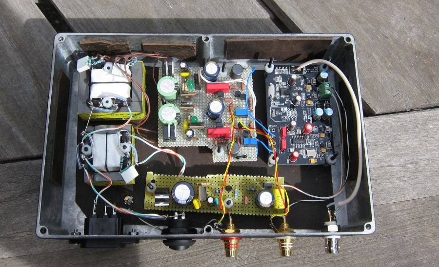

looks like a fun build, but i've gotta say, that huge film cap could not act more like an aerial if that was your goal. twisting the wires in this case does not help, if anything if it was part of a wide band amplifier it would easily cause it to oscillate. see you are twisting the same signal with an earlier version of itself, not ground or negative as is usually the case when twisting pairs.
no problem, have fun 😉
syklab: why have you got the case laid out like that? why not put the dac and its reception tower, erm caps ( 😉 ) all over on the right side right next to the outputs, leave all the power supply stuff over on the left side and connect DC from the regulators over the longer distances.
the dac has on-board regs anyway so if any connection can afford to be long, its those ones.

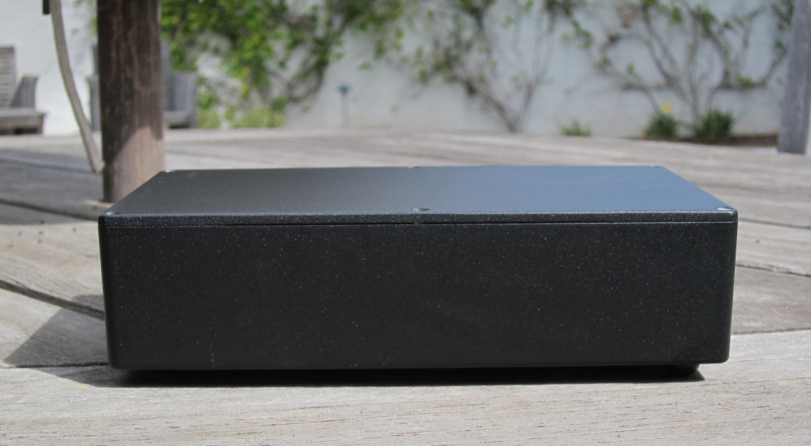

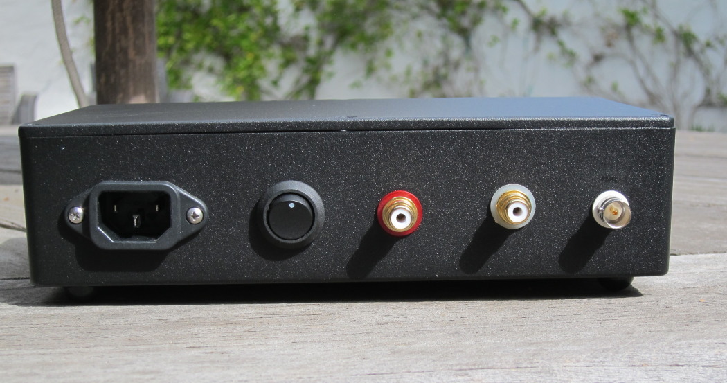

pictures of my build
I've now gotten my DAC + JG style buffer cased up and more or less completed. I housed it in a Hammond cast aluminum box, approximately 220mm x 145mm x 50mm. I managed to scrounge up some 1uf 50v BG NX and 100uf 6.3 BG N caps, so I included those in the build. The sound continues to impress me - kudos to JP and Subu. I like the sound slightly better with the JG buffer but there is a lot more cost and work associated with building it this way. One needs an extra transformer and power supply and nearly twice as much room. But the resulting DAC still is reasonably compact and I think it's worth the effort.
---Gary
