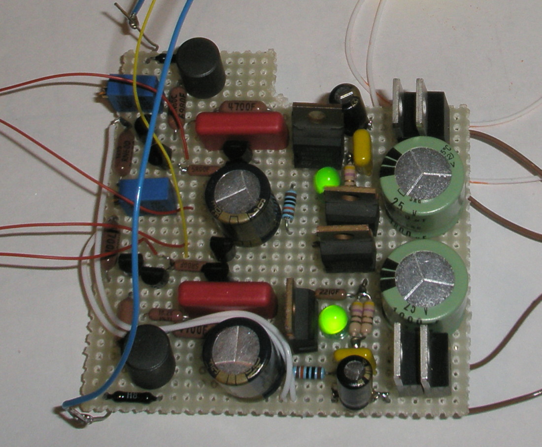

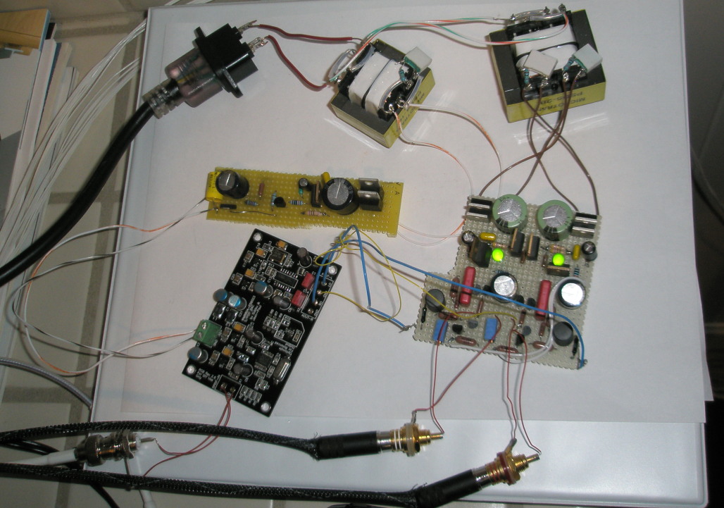

addition of JG buffer

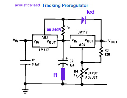

I just finished building a version of Joachim Gerhard's buffer for this DAC. This buffer has been discussed in another thread and there's been a group buy under way. I'm not the most patient person in the world, so I built a version point to point on a perf board. It's powered from a 14v+14v x 0.42a transformer. The power supply uses a LM317 with another LM317 as a tracking preregulator along the lines discussed here: Using 3-pin regulators off-piste: part 4.
Two of these give +- 14.5v. The buffer uses 2SK170BLs cascoded with J111 jfets and has an LC prefilter. When I first hooked it up, I was expecting a big improvement over the simple ES9023 and it did sound better, but still not what I was hoping for. So I decided to dig into the DAC and see where there might be further room for improvement. First, I changed the clock cap (C8) from the ceramic caps of the original build guide to the 4.7uf tantalum that have been strongly recommended recently. This gave a small improvement but still wasn't as good as I expected. Then I studied the schematic and discovered that C32, the cap on the NEG pin of the ES9023 had the wrong orientation, as mentioned in my earlier message. Changing the polarity of C32 gave a big improvement in sound quality and I am now quite pleased with the sound. Now I need to take a listen to the other version of this DAC that I've built without the buffer and with the polarity fix for C32. But I'm short a few parts, so that will have to wait a while before I can do that. Until then, I'll just enjoy this version of the DAC, which seems to be sounding very good right now.
---Gary
---Gary
