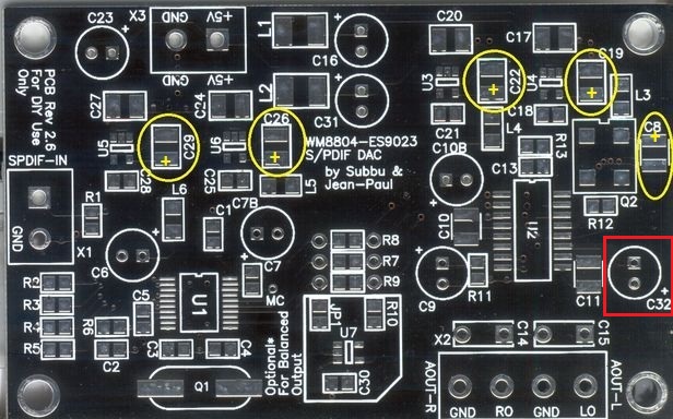

I decided to bring a newly finished "all BG NX" ES9023 DAC

Could I populate U7 - C30 - R10 if I won't use BAL version ?
It seems that JP1 switches the BAL circuit on, and it won't be active as JP1 stays opened.
