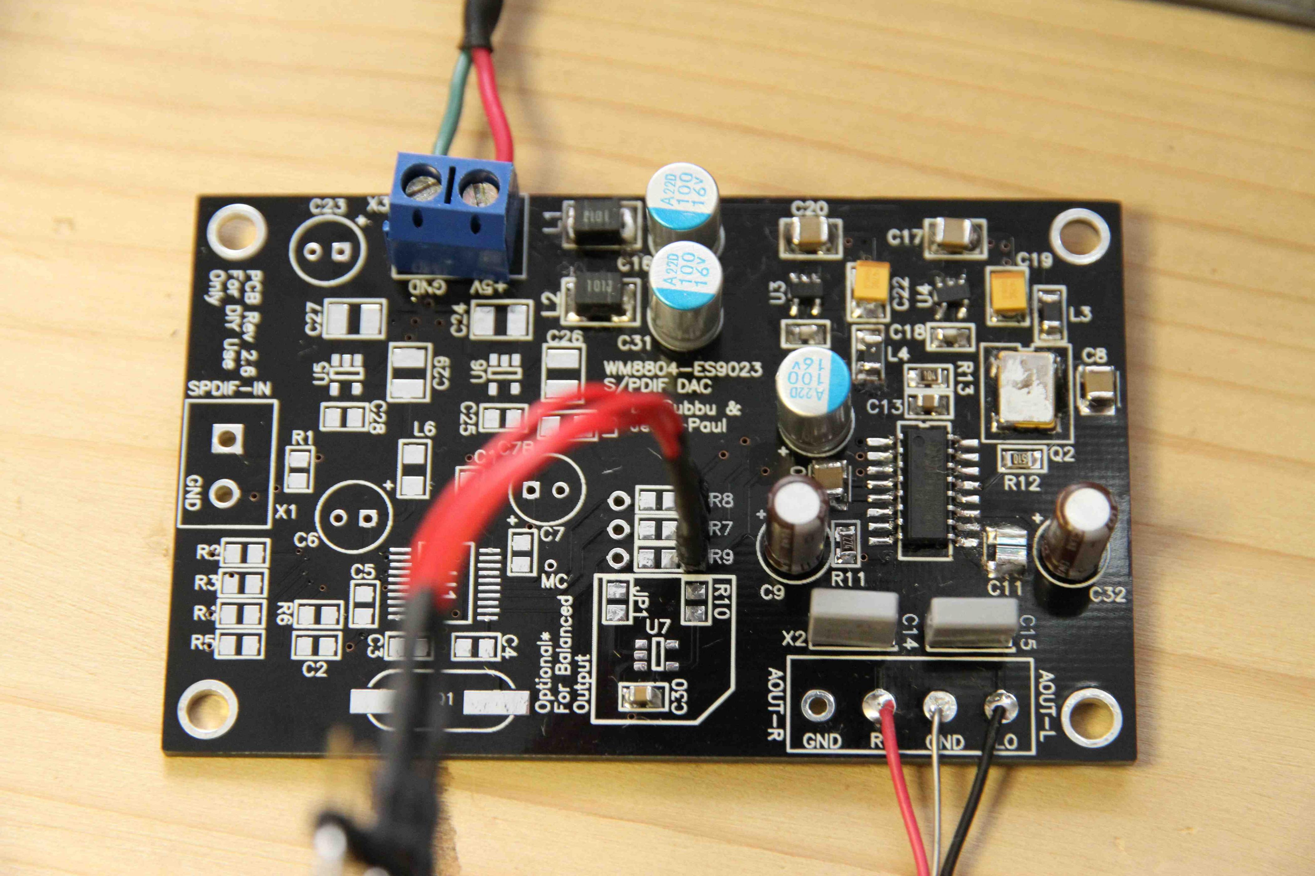

Marlowe, why don't you put the diodes inside the same box with the DAC? so that from the PSU Box to the DAC Box the power transmission is in AC...
Is there advantage of carry it in DC over AC? I thought carry electricity in the longer cable would be beneficial in AC, since AC do not induce electro magnetic stray....?
Hi dw1narso,
In fact, the cable is a long cable. The length is only 25cm.
I did not try to carry the power over AC. I found most power separated commercial productions transmission the power over DC (filtered or non-filtered).
I would recommend to put the smoother cap in the PSU box. The way you have it now, the charging pulses to the smoother cap are carried over the long PSU cable. Feed the DAC the raw DC and regulate it locally.
Ray
Marlowe I missed your post. Neat build again but Ray has a very good point regarding the charge pulses. Either go for a one box solution or make a separate DC supply. AC does pick up RF more easy than DC IMHO. So DC is the way to go. As a sidenote: switching DC is not favorable for known reasons. And I would not put my money on SC transformers. You were telling that the EUVL DAC and ours sound alike with all these nice parts on the EUVL DAC ? That is a positive message. Will you be tweaking our DAC too ? Please let us know how things develop.
And Syklab is called Syklab not Skylab but that can have been an error on his part 😉
Hi Ray and jean-paul,
Yes, filtering the DC in the power box may be good, but the power box is too small to fit additional capacitors.
In my other projects, I compared filtering the DC in the power box with filtering the DC in the load box. The difference is insignificant.
By the way, there is no smooth capacitors in 47 Lab power modules as well.

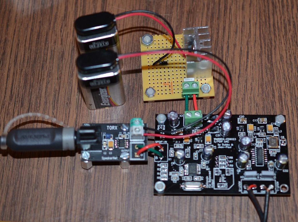

I threw together a PS and hooked everything up last night and got no sound. I found the voltage from the PS started at just below 5V, then dropped quickly. The decrease slowed as it approached 3V. Checked it with the scope there's no oscillation. It's a super simple design: An LM7805 with a 0.22uF ceramic cap to ground on the left pin and a 0.1uF polyester film cap to ground on the right pin. Power is a 9V battery. Regulator is well heatsinked and gets warm, but not hot. I've tried a few batteries, and the problem is not a dead battery.
So do I blame the lack of sound on the DAC or the PS? or maybe my TOSLINK module? Will the DAC work at all with 3V to 4V? I've ordered the Velleman kit, which should arrive by the end of the week.
Blame yourself 😉 This is not a project for SMD beginners. If you want to build it then build it as recommended which is not with a 9 V battery. I think the current is too much for a 9 V battery (this would be the best error of all as it is reversible easily) or there are shorts on the PCB or defective/overheated parts. Could be anything. TOSLINK module ? How is it connected ? To one of the onboard regs ? (oh no). The DAC can't work with 3 V as the regs need to deliver 3.3 and 3.6 V. But 4 V is no problem.
Pics would help considering all possibilities.

The TOSLINK is just a TOSLINK to S/PDIF converter: photons to electrons. TOSLINK Optical Input to S/PDIF Module | eBay I measured output as 1V peak-to peak, seen in the oscilloscope trace included in the photo.
If I can't use a 9V battery for a power supply I'll just wait for my Velleman kit to come in.
If I can't use a 9V battery for a power supply I'll just wait for my Velleman kit to come in.😴

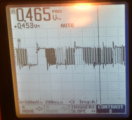

Can you take a better picture of the dac? Check the input and output voltage on each regulator.

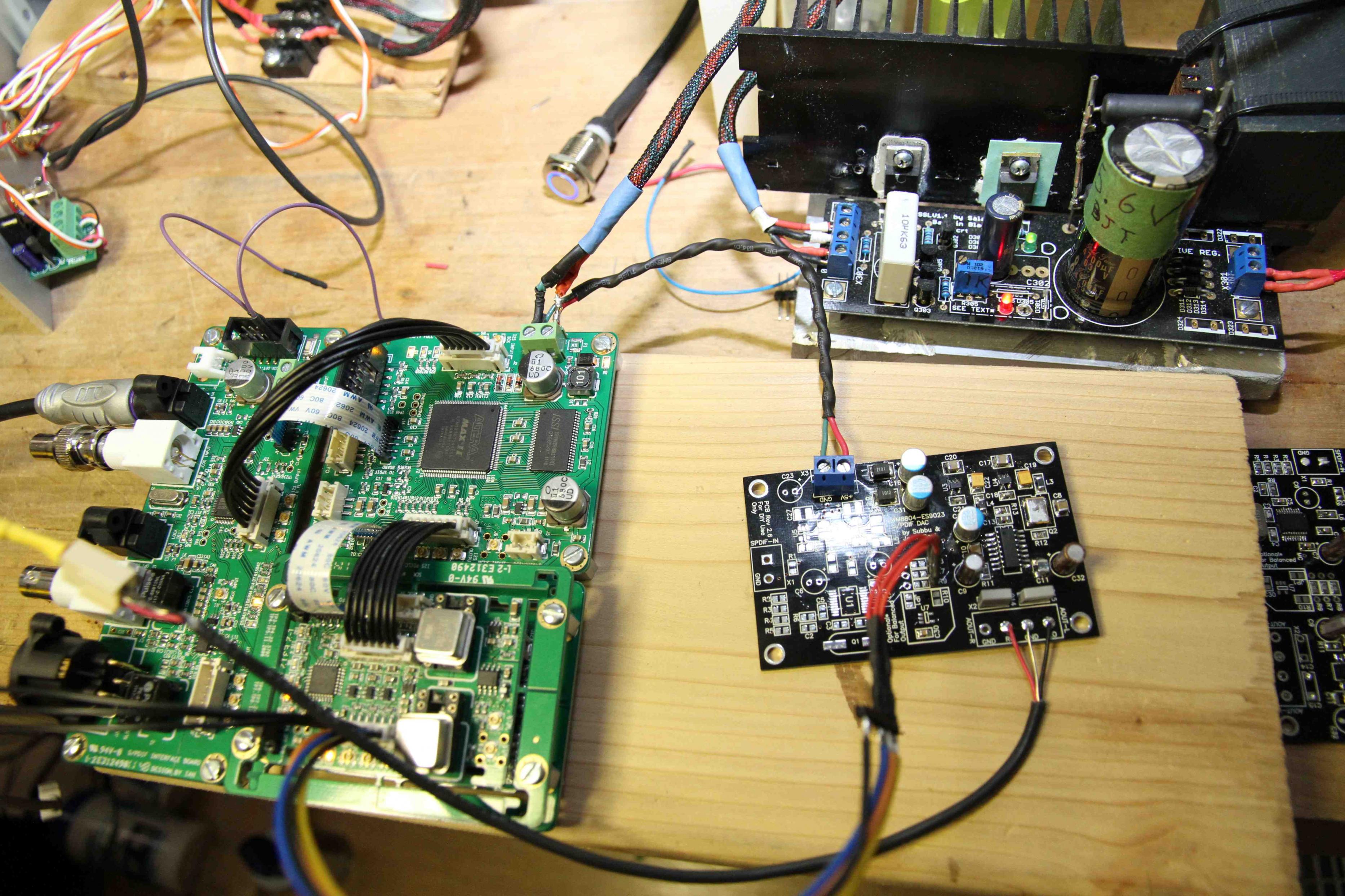

got one board working
ian's reclcoker as input, salas bib as power supply
I burnt the other board so I cannot complete the balanced mode.
lessons learned (especially when dealing with smd components):
1) don't populate everything and then start testing. this is what I did with the first board and could not find cause of failure. started desoldering and some traces were pulled off. this board is bricked
2) populate sections and test individually. In this case, the regulators can be populated and tested. once measurements are acceptable, solder the L components to each section I did this for the second board for the regs for dac and clock sections.
Thanks for this board as this is probably my best cost-effective dac ever built. Sound is very detailed and precise. Wish I had another board to test with balanced config. NOt using the spdif input section as you can see.
If ever there is a second board designed, please allow for external clock support.
Note: if anybody has an extra board to sell, please let me know.
regards

Hi what is ians reclocker ? It should not be a surpise that first soldering the regs and surrounding parts and then test it is normal procedure. Anyhow you got it working.
There won't be a new group buy revision with external clock support, sorry. And to be honest I don't see the benefit of added wiring, power supply and all problems that come with it. Choose the best XO that you can find and solder it to the board and you're done.
