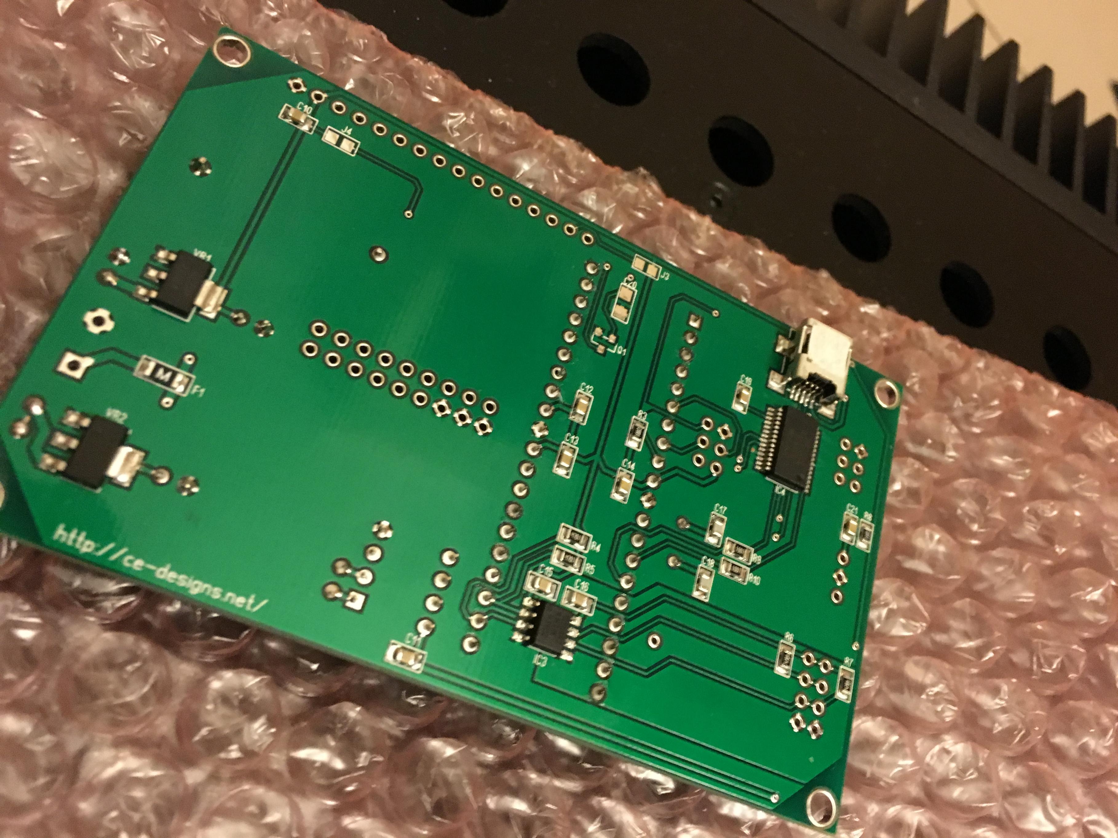

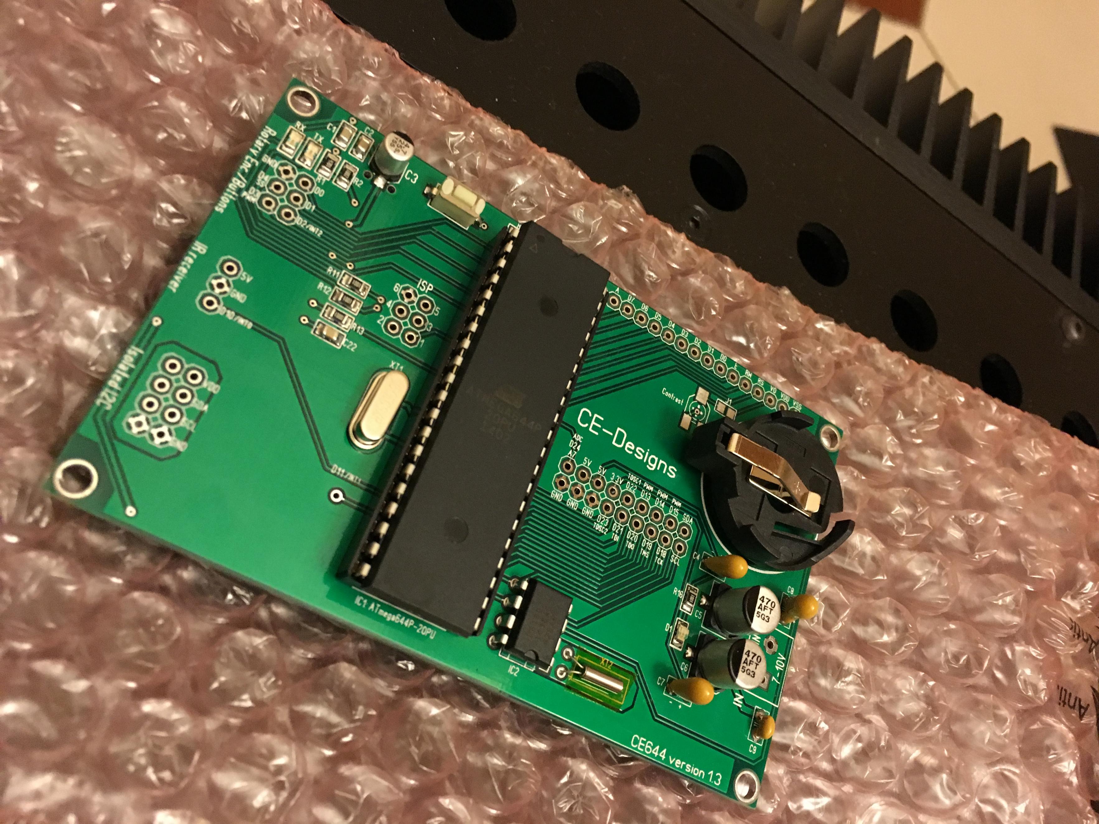

I managed to put together these days the V1.3 controller that I still have to program.
Can someone please give me a hand with this 😀

Hi schultzsch,
I am no expert but I did manage to build one and have it working now. What do you need help with?
Hello pixelpusher,
I need first to write a bootloader, I think...
Can this be done with the arduino app?
After I write the bootloader what files from Corpius site to I have to write and in which order? What program to use to write these files on the mcu?

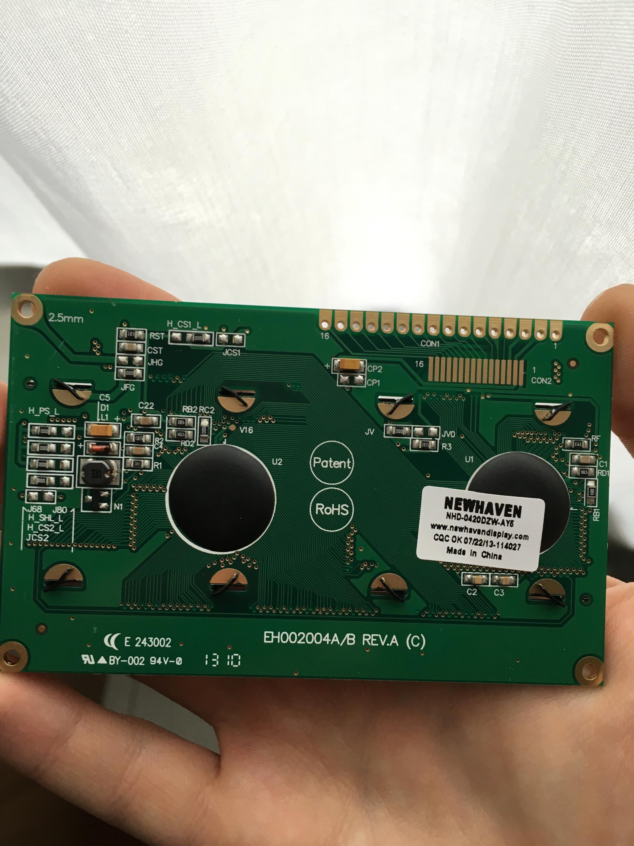

My oled display is version A, not sure but I wll attach a photo

If your chip does not have a boot loader you will need to "Burn" one using the ISP header. The USB/serial connector will not work without a boot loader present. The CE-Designs website has instructions and links to the files needed to do this. After you have the boot loader installed you can upload the firmware using the Arduino IDE.
I had to make a few adjustments to the firmware code to get it working. I am a programming novice so it has been quite the learning experience. The code is described as unfinished but seems to work for my needs. I am continuing to study the programming so I may be able to add some more controls in the future.
I can't comment on the encoder as I've not hooked it up yet. I did use one with the v1.2 controller. In the next few days I will try to get that working.
I managed to burn the boot loader with arduino mega using some tutorials found on the net 😀
Having Rev A OLED I had removed characterOLED library but when I try to compile the code it gives some errors 🙁
I do not have any ideas how to solve this.
Can you please share your working version?
My laptop doesn`t want to recognize the ftdi chip, maybe because is runnin win 7 64bit?
Or is there something else that I do wrong?
Thanks.
I compiled with arduino 1.0.1 and arduino 1.6.6
In arduino 101 fails to compile, in 166 it compiles but I can not find atmega644 in boards list, even if I copy atmega644 libraries in arduino hardware folder.
I will attach two text files from the two versions of arduino.
Those errors all seem to relate to multiple definitions. I suspect that it is trying to load too many libraries.
I am certainly no expert on programming these things. Here's what I did. I used Arduino IDE 1.01. All of the files from Github must be in a folder within the sketch folder. The libraries then will show up as tabs in the IDE. I did not install any libraries in the Arduino IDE program. I am using the Rev C OLED. I had to uncomment the line; #define CHARACTER_OLED in the file SabreController.h and comment out the line; #include “OLEDFourBit.h" in the file SabreCE.ino
One line was missing a ; on the end which threw a compiling error. I don't remember where this was but it should be easy to find once you remove all those errors for multiple definitions.
When I was finally able to upload the files the controller worked good but did not display the correct sample rate. Robert helped me out by sending me his working files. I was able to find the discrepancy by comparing his files to mine. I changed the line "controller.sabreDAC.getSampleRate();” in the .ino file to "controller.sabreDAC.setSampleRate();” and the correct sample rate displayed for PCM files. There is still an issue with the sample rate display for DSD files. I have a few ideas on a solution but have not yet tried to correct this.
