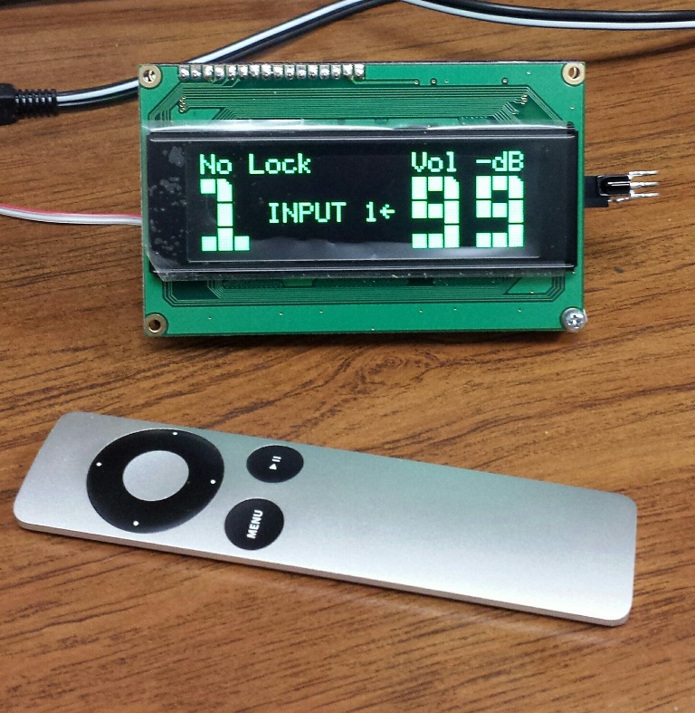

Got the Ardunio UNO and a 10uf cap delivered today. Hope to try this tonight.
Per Robert's instructions....
1) Install the Arduino IDE (version 1.01).
2) Click here to download Arduino software extension for the ATmega644.
3) Unzip and copy all folders and files to the Arduino 'hardware' folder.
4) Start the Arduino IDE.
5) Upload the 'ArduinoISP' sketch to your Arduino. (I found in Arduino v1.01 examples folder).
6)Select the ATmega644 under Tools→Board→ATmega644.
7)Now set the 'Arduino as ISP' programmer under Tools→Programmer→Arduino as ISP.
8)Install a 10uF capacitor between the reset pin and GND with the positive side facing the reset pin as in the image below.
9)Connect the Arduino to the ISP header according to the table below. Make sure that the controller is not powered by any source other than the Arduino!!!
10) Open and upload a sketch of your choice. Now the sketch is being uploaded to the controller's AVR
Just so I understand clearly...I presume after step 9) I would Burn Bootloader? Then after that I can use USB input to upload sketch?
Thanks,

One line was missing a ; on the end which threw a compiling error. I don't remember where this was but it should be easy to find once you remove all those errors for multiple definitions.
When I was finally able to upload the files the controller worked good but did not display the correct sample rate. Robert helped me out by sending me his working files. I was able to find the discrepancy by comparing his files to mine. I changed the line "controller.sabreDAC.getSampleRate();” in the .ino file to "controller.sabreDAC.setSampleRate();” and the correct sample rate displayed for PCM files. There is still an issue with the sample rate display for DSD files. I have a few ideas on a solution but have not yet tried to correct this.
Hope this helps!
It lives! Thanks for all the help.
I read the tab thing is a way to separate complex pieces of code from one sketch. Wonder how hard it would be to copy working encoder code to a new page and get the main sketch to see it.

Another question. Not that the clock is important to me, but I am unable to set date. Just wondering if it's the code or something might be wrong with my build.
After the two digit month, there is a digit that is fixed. Then I have two digits for date which only counts from 01 to 12. Then I have the four digits for year.
Like this 03[8]122016. I added brackets around fixed digit.
Thanks!
Remember that the European convention is Day/Month/Year.
