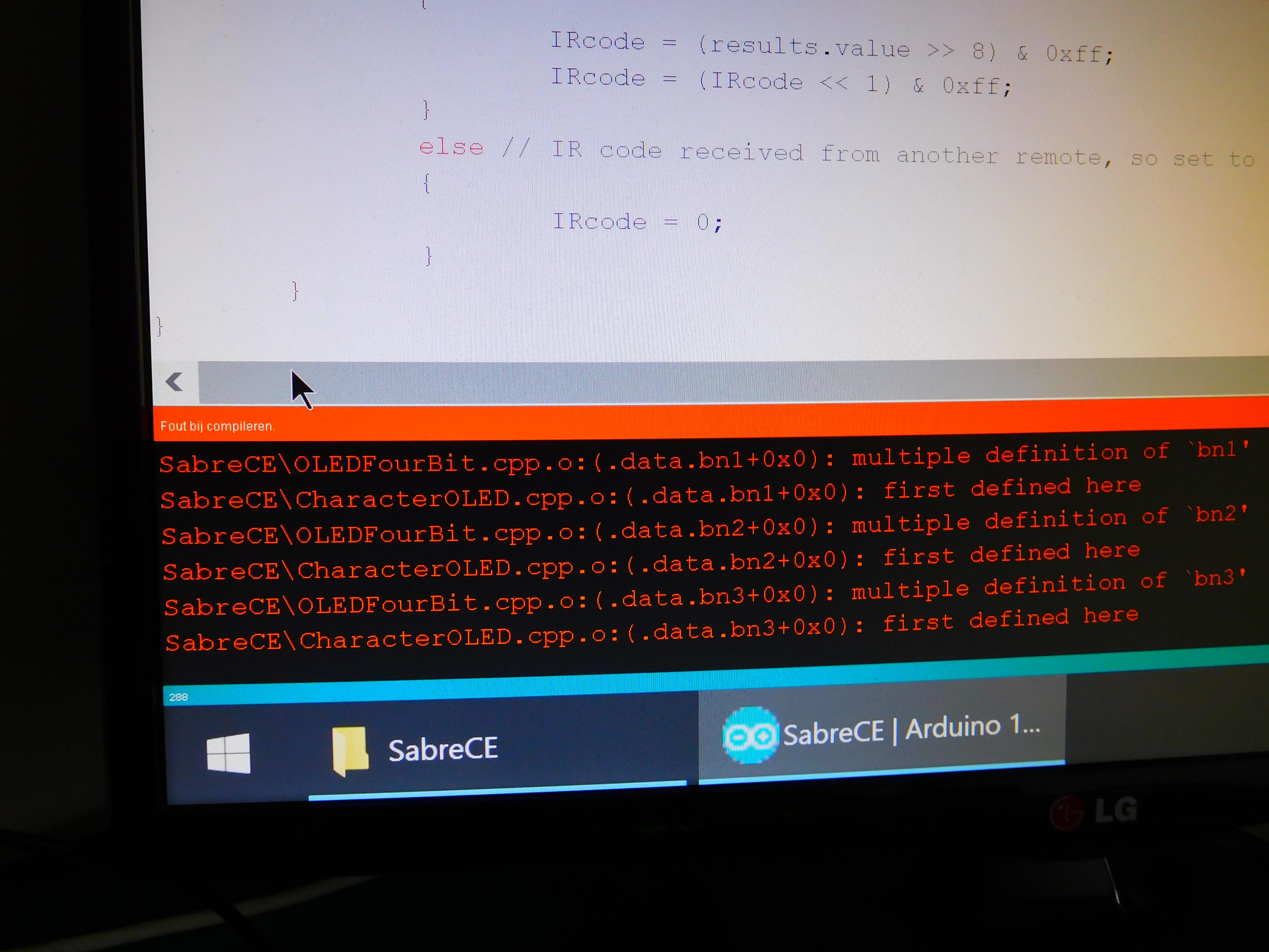

hi
On the picture you can see that on line 288 a fault is stated.
Fault while compiling, and in the black bar which fault.
Mine question, is here anyone who can tell me how to solve this problem?
Thanks.
If it's not too late, check the Post #236 for the solution:
ES9018 I2C controller
solution
Hi userguide,
Your explaination is right.
The problem was indeed that the libery files not stay in the right map.
When I attempt the last time, different error message appear, and when the stdio.h file (in a map whit the same name) was replaced, to the right map, the error message disappears, but the next error message appear. Again a libery fault.
Then I replace all the libery files to right map and let load again the code, and yes, its going right. So,after a lot of errors finaly a good working controller.
