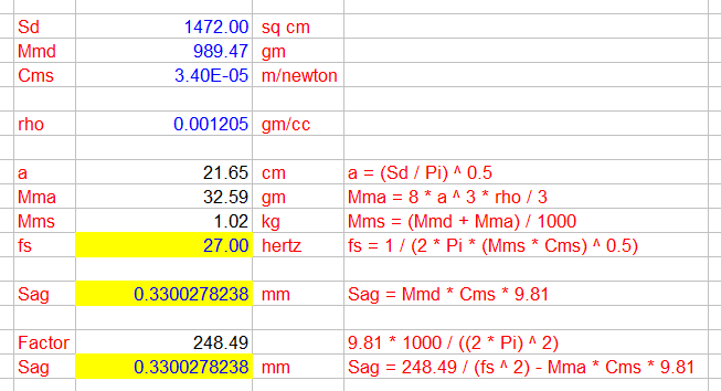

Rockford Fosgate Power T3S1-19 superwoofer:
Mmd = 989.47 grams
Cms = 3.40E-05 metres/newton
Sag = 989.47 * 3.40E-05 * 9.80665 = 0.33 millimetres (Xmax = 34 mm)
Alternate formula:
fs = 27 hertz
Sag = 248.49 / (fs ^ 2) = 248.49 / (27 ^ 2) = 0.34 millimetres
Mmd = 989.47 grams
Right, the suspension must compensate with added stiffness when the cone assembly weight is gross.
In both cases (20 gr and 989 gr) the sag is small but a lot bigger for the monster high-power driver (.09 mm versus .34 mm).
Some folks unfamiliar with SI will be interested to learn that the Fosgate super woofer cone assembly weighs 2.2 lbs.... which seems awfully heavy to waft about to me as you can compare the contrasting world-views of the Lotus and the Corvette

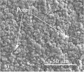

We all know that an air filled balloon is not totally sealed. Air molecules escape through pores in the balloon walls.
The size of an air molecule compared to the size of a pore is like that of a bee to the Clyde tunnel, a traffic crossing beneath the River Clyde in Glasgow.
Attached is a scanning electron microscope image showing the pores in rubber. The pore sizes are in the order of 10-3 mm, much larger than air molecules which are in the order of 10-7 mm.

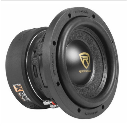

I bought one of these to make a pneumatic driver - basically I want a 6" syringe with an attached voice coil. Should be easy; they claim a solid, strong dust cap and the cone appears to be solid, thick piece of plastic. I put a shallow solid plastic cap over it to constrain the output to a 1/4" hose barb.
Leaks, leaks, leaks and leaks some more. I noticed the surround is sewn to the cone, so I covered that with GOOP cement, still leaks. I covered the dust cap, still leaks. Getting really frustrated, I painted the entire foam surround with this GOOP adhesive, made sure all the mounting holes were plugged, then glued the cap directly to the basket after removing the rubber gasket completely...
...Still leaks. I dont know what kind of drivers y'all are worried about not equalizing pressure in hours of time due to a barometric change, but I cant seem to make a given driver be airtight between front and back, no matter what I try.
I'm pretty sure the surround is porous. It's still porous after my glue treatment. Cant think of any possible path for the air pressure to get past that dustcap, cone and surround - but there is. Easily discernible just blowing into the hose barb with my mouth; better than before I went nuts with the GOOP, but nowhere near airtight.
