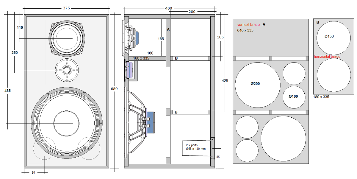

No, the OP (me) gave an example of SL with 50 liters = 1.76 ft3 and wants to know if you were right to use a slightly larger hole diameter.
(1.25mm instead of 1mm) in its own sealed enclosure which is 5.29 ft3 = 150 liters
