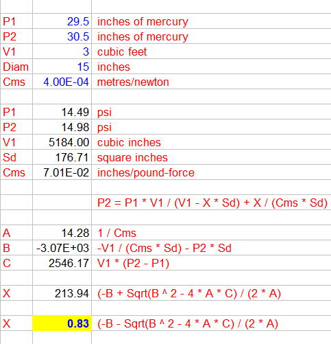

Hi Galu,
Just to make sure, I have now checked how much the the displacement value would actually change if Cms was indeed taken into account :).
The relationship between the various parameters is as follows:
P2 = P1 * V1 / (V1 - X * Sd) + X / (Cms * Sd)
The expression is a quadratic equation and can solved for displacement X directly.
If we assume the following:
P1 = 29.5 inches of mercury
P2 = 30.5 inches of mercury
V1 = 3 cubic feet
Sd = 176.71 square inches (15 inch diaphragm diameter)
Cms = 4.00E-04 metres/newton
Then after converting all units as appropriate, rearranging and manipulating the quadratic equation, and working through the calculations, for a linear system the value of the displacement becomes 0.83 inches, compared to the figure of 0.96 inches previously obtained when Cms was not taken into account.
Kind regards,
David
EDIT
There is a bracket missing in the worksheet formula (-B + Sqrt(B ^ 2 - 4 * A * C) / (2 * A) it should be (-B + Sqrt(B ^ 2 - 4 * A * C)) / (2 * A).
Similarly for (-B - Sqrt(B ^ 2 - 4 * A * C) / (2 * A).
The formulas used in the actual calculations are correct.

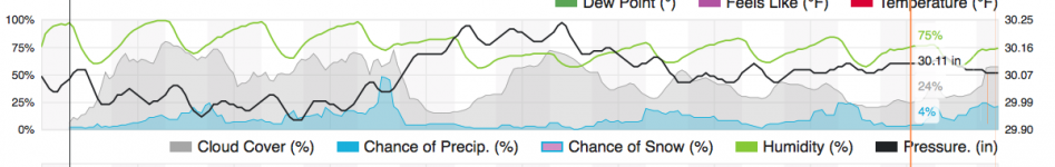

Now to try to answer OP's original question, attached is the height of mercury in Delray Beach, FL, predicted this coming 10 days. See the heavy black line.
The cross-section of the pin hole must accommodate the mostly slow rate of change of the barometric pressure illustrated in this prediction, using David's calculation.
Easy.
B.
