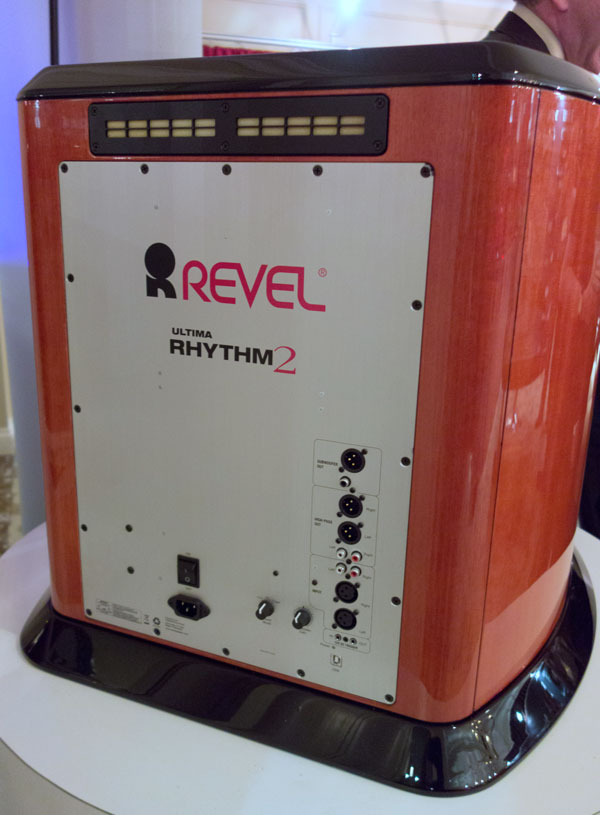

You may be interested to see that this issue was addressed by Revel in at least one of their subwoofers, and Harman decided it was worth patenting.
Wow. I think I'll consider reinventing the wheel! Well maybe just sliced bread🙄I hadn’t ever run in to issue with sealed enclosures being “sealed” enough to show cone offsets from slowly changing barometric pressure. But, I have experienced similar issue due to rapid heat build-up in subwoofer enclosures, particularly in car audio. Adding the recommended “small” leak without generating an annoying whistle is easier said than done. I found a slightly larger hole stuffed tightly with dense foam did the trick.
" The box is completely sealed except for a small pin hole (<1 mm diameter) to equalize internal with external static pressure and to prevent displacing the cone from its normal resting position."
