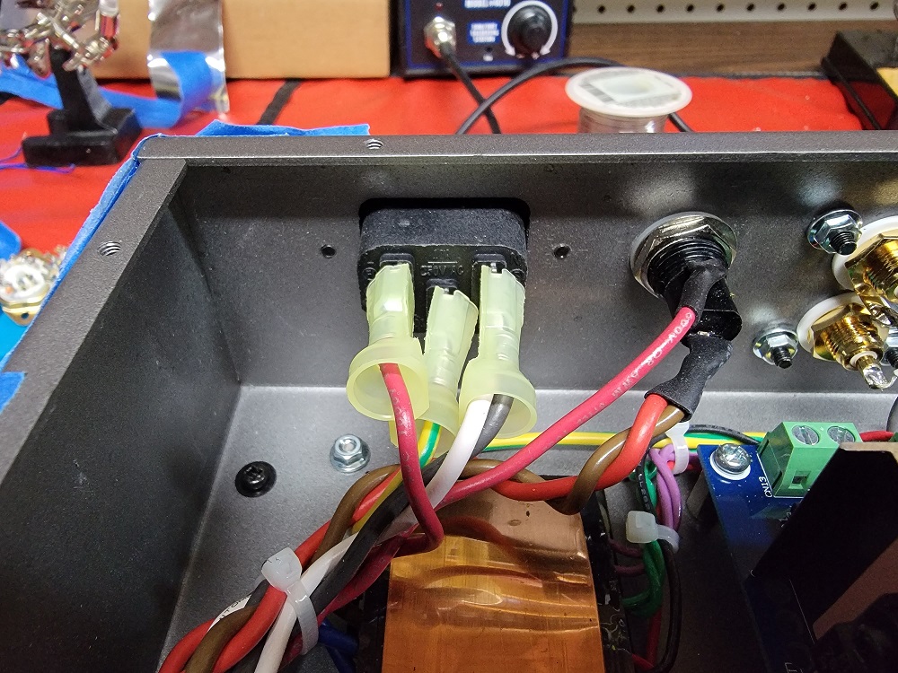

I also upgraded the IEC to 3 prong IEC and took the ground directly to the ground screw under power pcb.
@Neville Thanks 🙂, you brought my attention to the ground, and you mentioned another couple of tweaks you made but I couldn't. This one is a must especially if your going to lift the hood and upgrade later. I'm getting one that is already assembled, that is my concern. I have worked on guitar amps and F15 jets years ago but never Hi Fidelity.
We did swap-tronics on diagnostic yes /no computers, not depot level repair. That was 35 yeas ago. 😀I could do it but I couldn't do as good a job as a professional.
The only differences from professionals VS you is just experiences. You have all the basic foundations that is needed and even more. Practicing makes perfects 😉
First ask Victor if this will void warranty !
It will be pretty easy:
1. take photo of the wires soldered to the IEC
2. de-solder them
3. remove the 2 screws holding the IEC from the back
4. insert 3 prong IEC, and screw back
5. resolder the wires correctly

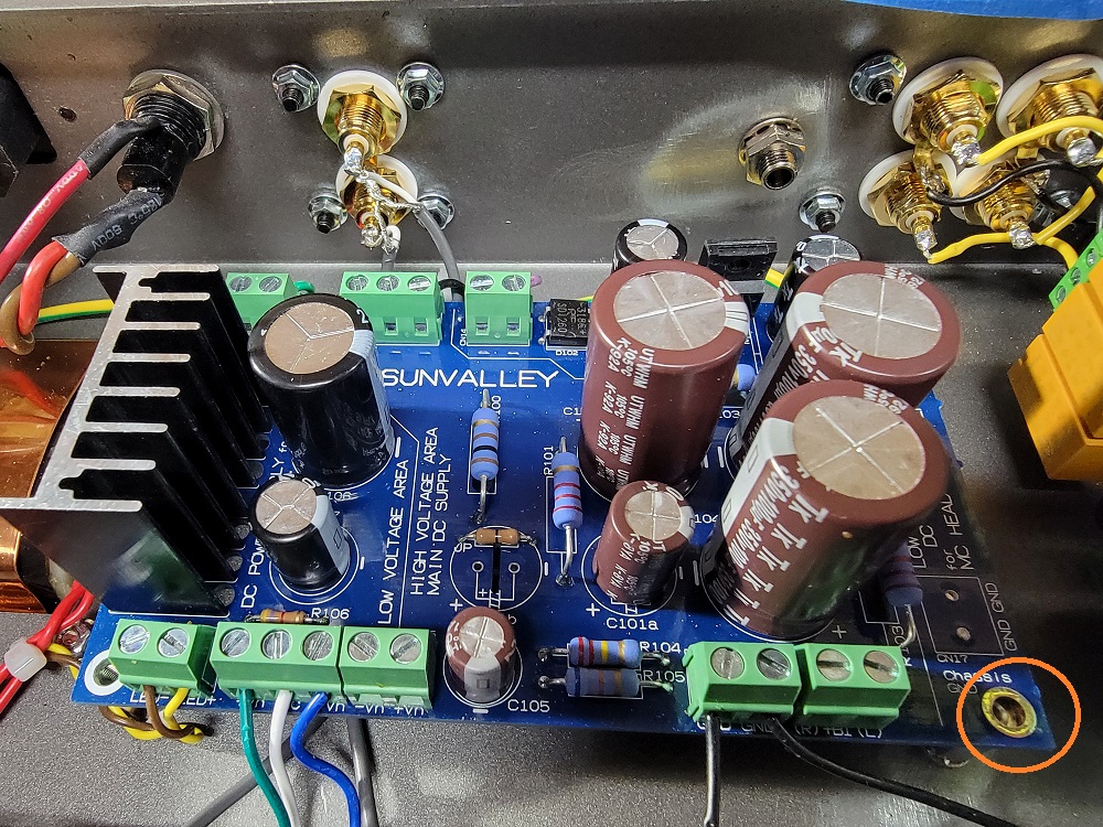

6. attach new ground wire to ground connector and wire it to the screw that has a teeth washer (if you looking at the IEC and its top left, then the ground screw under power pcb is bottom right.
If you worked on such $$$ kits 🙂 I am sure you can do this.

Does anyone have the DC voltage on the power supply input? This is the voltage from pin 8 on the rectifier and the black ground from the transformer (+BO and GND on the power supply board.) I'm seeing higher voltages on P1L1 and P2R1 than expected. Both are around 275VDC where the manual states they should be around 162VDC. I'm seeing 304.6VDC coming off the rectifier. My AC line voltage is around 124VAC, so a little on the high side. Tubes are Gold Lion 12AX7 and Brimar 12AU7.
Is 304v coming in to the power supply expected? which test point..
Each test point must with in the range.
Please check all your wiring..
