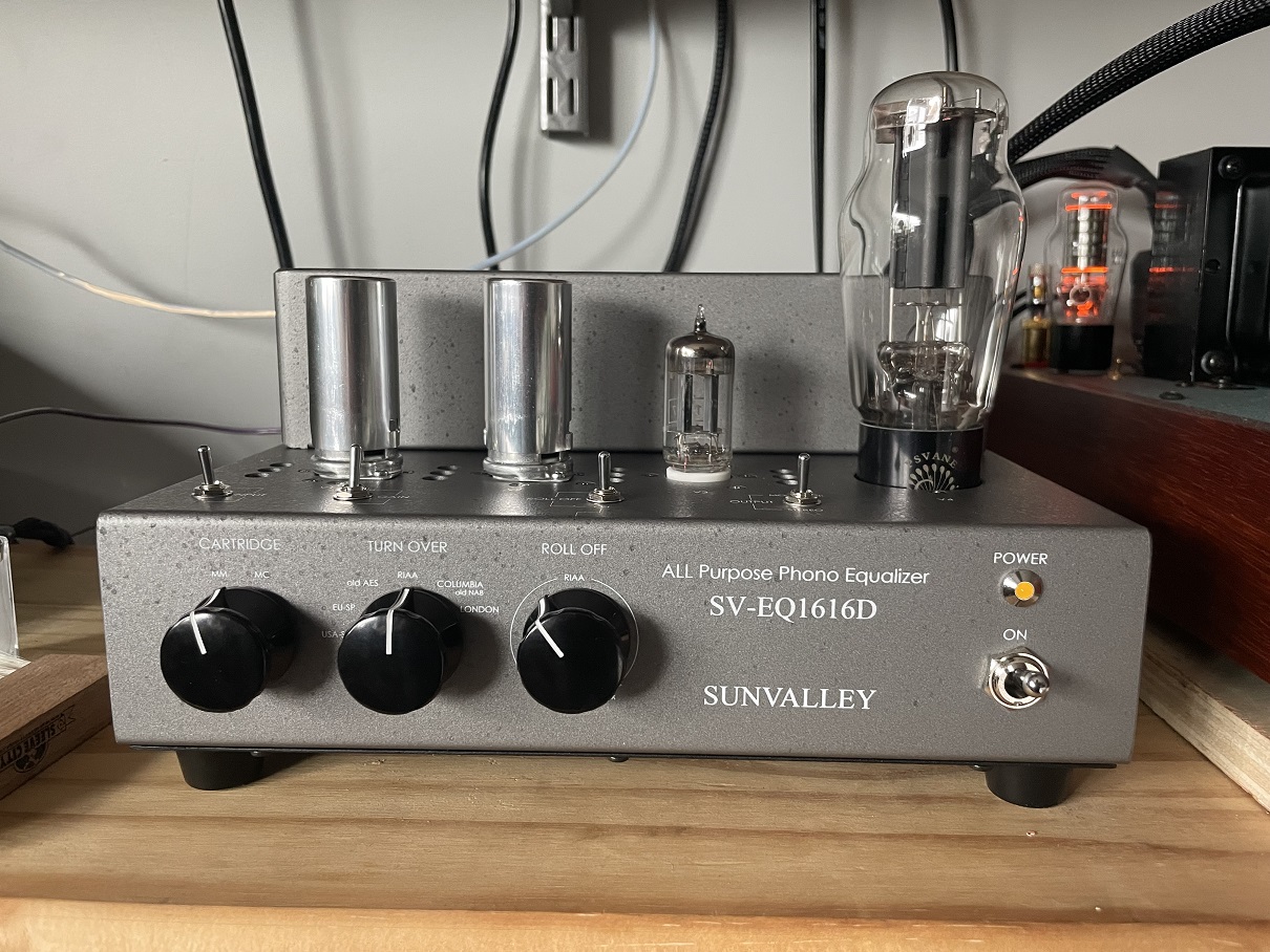

Following up on my troubles previously reported: I got a replacement relay switch and that solved the problem. I also think it improved the sound - either that or break in - because this thing sounds amazing now.

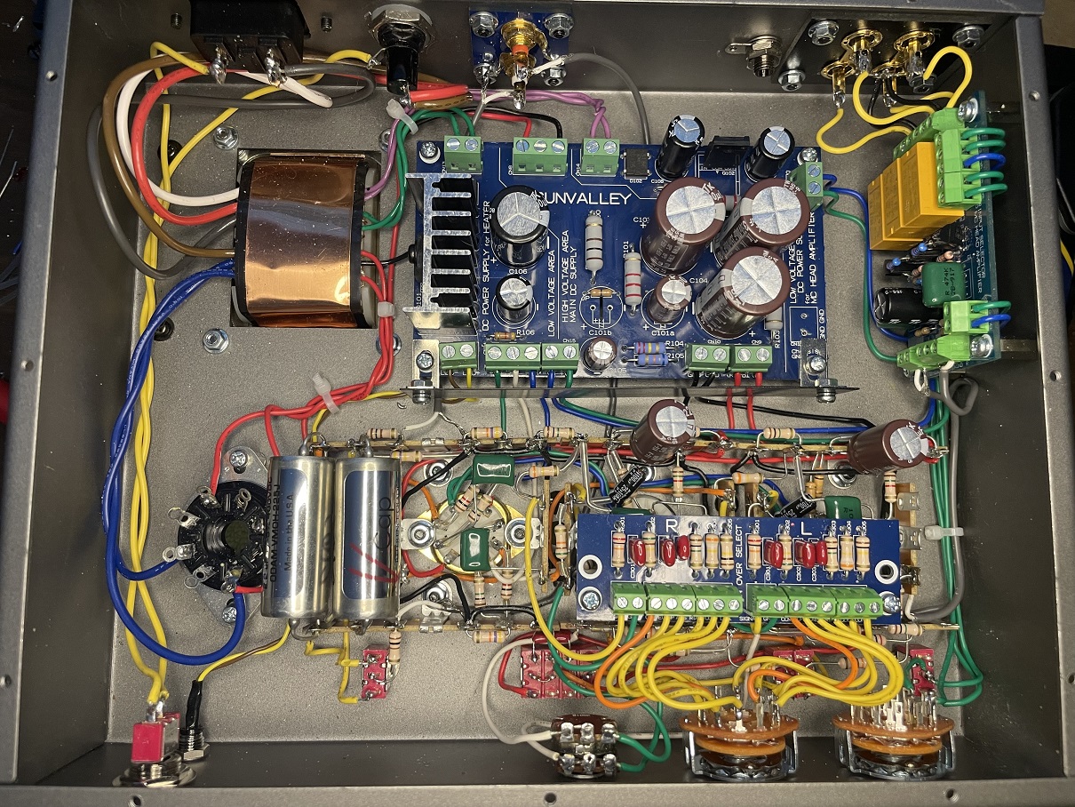

Waiting for my tu8900 to arrive, I assembled an EAR 834p clone I bought off eBay before the world went crazy and it has been sitting in a to-do pile. After assembling it and testing it in my lab rig, I added it to my main rig with 8600s and eq1616d. After 15 minutes, I packed it away. It has poor part quality parts that probably contributed to its over warmth and dull sound, There are threads that go into hundreds of pages when modding the clone but what is the point when the eq1616d has it all in one kit with good parts….. At least I now have a nice chassis that could be used for another project. Chinese tubes I will use for testing new gear but that’s all they good for.

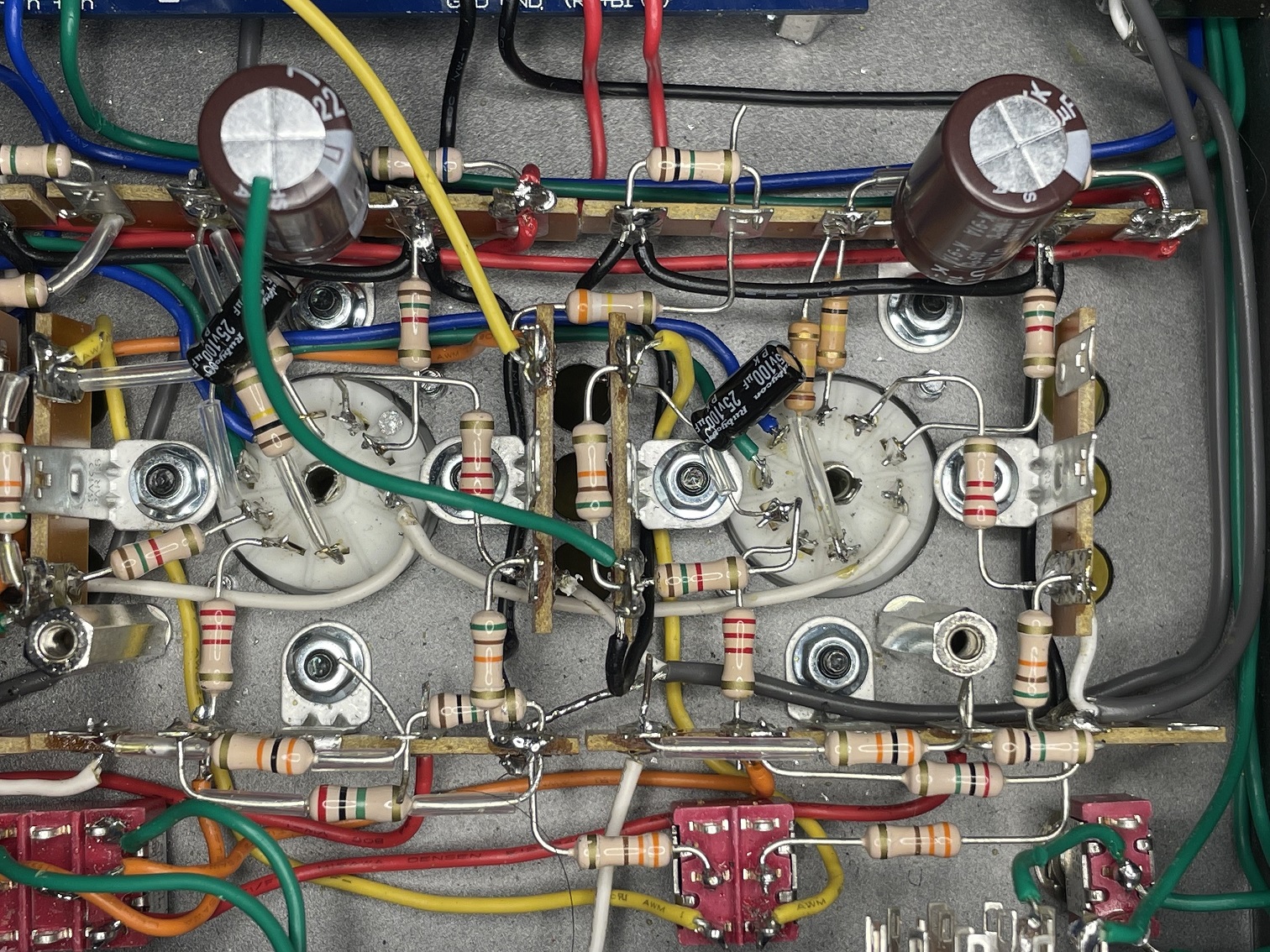

I am in the early stages of building the EQ1616D. As for me...I have upgraded the parts for EQ1616D. While the parts are overall fine...The interconnect wire is too small (26awg?), Tube Sockets, Volume switch, RCA connectors, Caps and Resistors will be upgraded to what I have used in SV-Pre1616D. The films for the EQ1616D will be V-CAP ODAM.

I completed my build a few days ago and want to say a few things.
1. This is a wonderful kit and a real joy to build. I’m not very experienced in DIY (yet), but after building 3 Bottlehead kits this year the SV-EQ1616D was very straightforward. It’s also worth noting that the manual is now 100% in English. I had zero issues and she fired right up passing all checks from the start.
2. Viktor is equally wonderful. I called him Tuesday afternoon and placed my order. He shipped on Wednesday, the kit arrived on Friday and I was listening with a big smile on Monday ��!
3. I’ll withhold thorough impressions until I get more hours on it (I’m familiar with VCaps and how they change over time), but the unit is extremely capable particularly with tube rectification. My chain is VPI Prime Scout w/Ortofon 2M Black => SV-EQ1616D => Bottlehead BeePre2 (Genelex Gold Lion and VCaps) => Belles Aria Monoblocks => Vandersteen Quatro Woods.

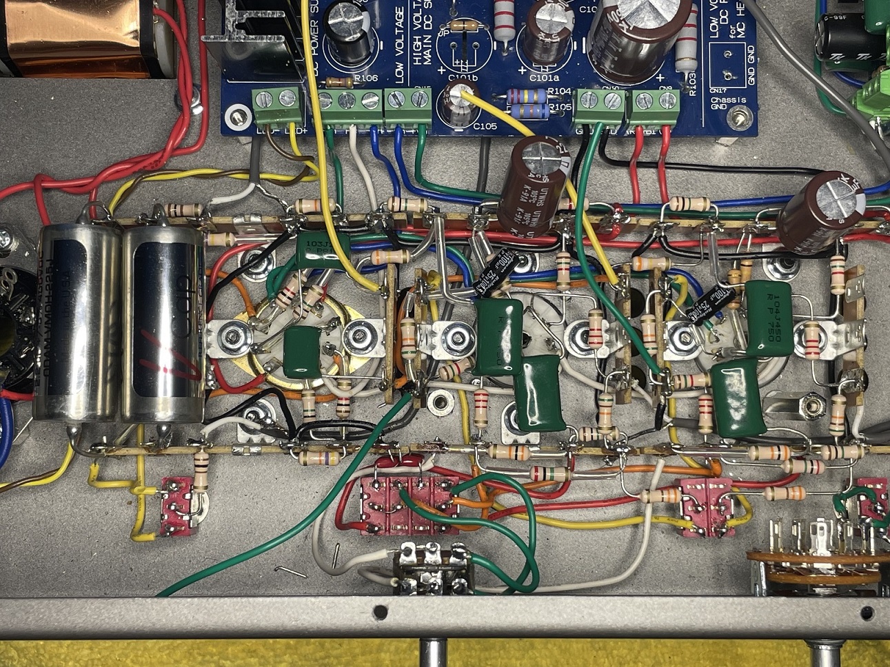

Just finished building my phono stage and its burning in as we speak. I would like to echo the sentiment that you should really take your time with this thing. I know how eager we are to have this up and running as soon as possible but the fact is that if you want this to work with no issues you have to put time and thought into your wiring. Mine didn't come out as picturesque as some of the builds I've seen on this forum but I am proud of the final result. I am now looking forward to reacquainting with my Exotica records. Now I am trying to decide if I want to go ahead with a 300B kit and if I do, which one since they all look really good
I forgot to mention I did get one bad reading. For the MC voltage I got 16.5V not sure if this is just a bad regulator or what but what can I do to fix this?
