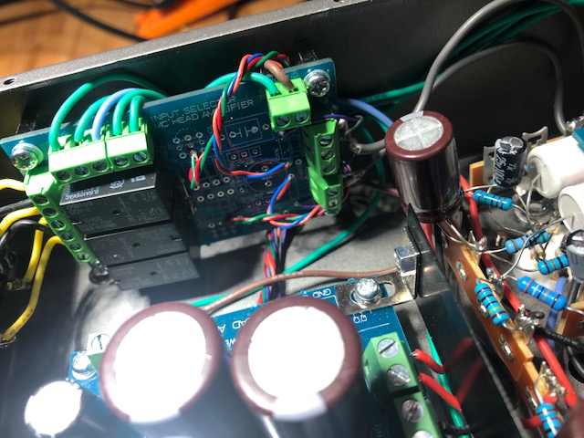

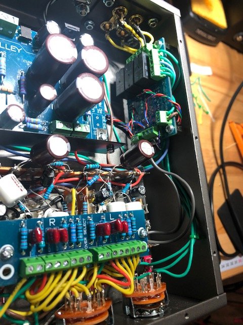

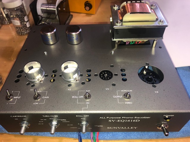

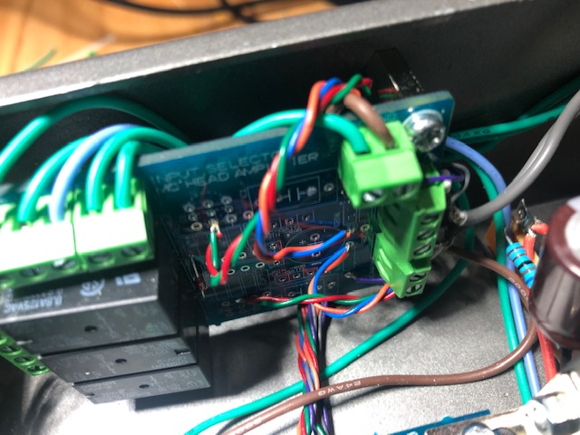

I finished my build last week, and used internal SKY 20 SUTs instead of the MC Board. Here are some photos. It sounds superb. Oh, I also used all Metal Film Resistors, VCap Odam and Mundorf MCap EVO Aluminum Oil Caps instead of the supplied film caps. Still doing some tube rolling. So far, I am happy with the Bugle Boy tubes and the PSVane 274b. Still breaking in, but The SKY 20 is a perfect match for the Koetsu Rosewood Signature Platinum.
