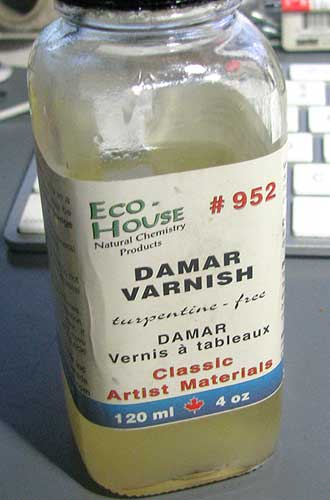

sts9fan said:
what is damar? I don'tsee this mentioned in Bud's thread.
No you won't see it here. It is part of what i took from my old driver mods for the FE126/127. Using it to form the trifoil pattern helps supress to a certain degree the 2 big cone resonances in the 126/127.
Damar is an artists varnish for coating oil paintings. A $10 bottle from the art supply store will last a lifetime.
dave
frugal-phile™
Joined 2001
Here is a pic of the label from my bottle...still 2/3rds full after a couple hundred drivers (and a few spills)
dave

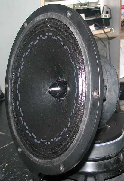

DougL said:
I was wondering if the treatment details had been worked out for the B200?
Double ring at the surround... a triple ring at the voice coil (because of the left overs from the dustcap), and 3 double rings on the phase plug plus the tip treatment.
1 coat puzzlekoat pre-coat, 3 50% gloss after.
Bud gets a hold of one he may detail it slightly differently. Drivers now on a boat to Jakarta,
dave
Dave,
I think that what you have on the ship bound B200's is the correct thing to do. These additional interim rings I have cautioned everyone about, with respect to the Hemp FR8 are showing some difficult characteristics. Difficult enough that I am going to hang on to the FR8 drivers for a bit more experimentation.
When I first applied the mid cone and mid whizzer rings, the sonic character changed markedly. Much less tolerance for harsh and nasal sounds. Paradoxically, the amount of detail and musical nuance is definitely greater than with the single sets of rings at start and finish of the cones, or triple set in the B200's case and others.
I am going to have to purchase and sacrifice some inexpensive cones to figure out what the odd harsh character is. Sounded almost like what you would expect to hear, from looking at Soongsc CSD plot, for the pattern that fully dissipated the nodal standing wave ringing. But, it was also tantalizingly more capable. The Gloss smoothed that harshness away, with just a slight edge showing occasionally.
I continued to use musically more dense test material, though still pretty smooth in nature, and was satisfied that I was on to something very useful. Then Tate, from the Hawthorne Audio forum, stopped by, bringing a collection of much more raucous, hard edged music, on Red Book CD only, with unknown quality in transfer. Still, a more benign EnABL pattern would not have stumbled here. I also use Red Book during the last phase of treating something new, I just hadn't done that yet.
This music definitely woke up the harsh side of things, so I am glad he came and brought what he did. I want to reinforce a warning about these new mid rings, DON"T USE THEM.... just yet.
Meanwhile, back with the 200B's. Doug, If Dave is satisfied with the quality from the treatment he performed, I am quite confident I would end up with the same patterns in the same places, so, go for it.
Bud
