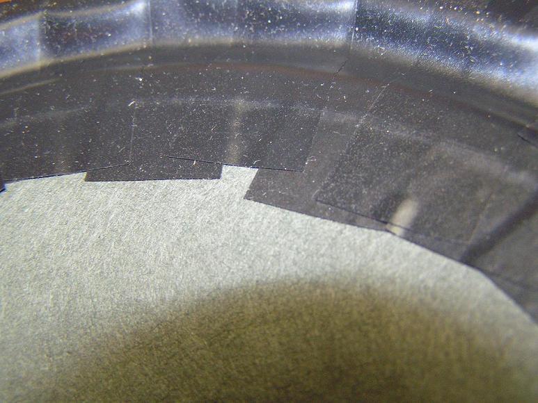

It took me a while to find out about this EnABL process everyone's talking about it. I suppose just nothing gathered my interest until I talked to planet10 about it.
I was about to try EnABL-ing one of my sets of speakers until I took one apart and realized I'd already done something else to it which sort of makes the process difficult.
....Then I noticed something interesting going on. The sound of these speakers after I modified them was absolutely astounding(still is). They cleaned right up, all through the band, and are so dynamic and well-detailed.
This is a big change because as original, they sounded like absolute garbage, not even worthy of intercom use in my opinion.
I wonder if what I did had a similar effect to the EnABL process, along with increasing the driver's compliance as I expected. My endeavor was entirely to increase the compliance of the driver's suspension to allow for some low-end use. This worked out extremely well, however I noticed a great improvement in the mid-hi area.
Here's a picture of what I did to change them. The original surrounds were barbarically cut out with a sharp box cutter, and replaced with my rather un-neat application of electrical tape.
I wonder if the tape, and its pattern of application, is effectually reducing standing waves in the way the EnABL process does.
Hi Duo,
Maybe not in the same format as EnABL, but certainly with the same general aim, to break up standing waves, before they can become so. Go here and read from post # 20.
http://www.diyaudio.com/forums/showthread.php?s=&threadid=100390&perpage=25&pagenumber=1
I think what you are doing is closer to what Dr Mamboni discovered. We do discuss it pretty thoroughly, along with EnABL.
Lynn Olson chimed in with a hint about using Fibonacci numbers to develop an "irregular" edge treatment out of the Mamboni devices.
I suggest you obtain some of Planet 10's neat Fonkens and FE 126 or 127 drivers so you know what the EnABL baseline is. And also because they just flat reproduce an engaging musical event. Then begin to really experiment on your own, with your tape idea, maybe crossed with some Mambon and Fibonacci.
We would all be interested in you finding out if there is an even better way to do this task. But, until you have a baseline we all know, well, an increasing number of us anyway, as Dave gets his work out into the world, none of us can judge your relative progress, nor can you.
Soongsc noted, a few hundred posts back that virtually any form of displacement will perform some of the EnABL functions, just because it creates turmoil rather than ringing, which is a very structured event.
So, read about Mamboni and see what happens in your head. We will all be interested.
And welcome to the clan.
Bud

Yes, I will continue to study your work and that of others here.
My intentions with the tape were nothing even remotely similar to your work. Just to increase compliance and lower Fs.
