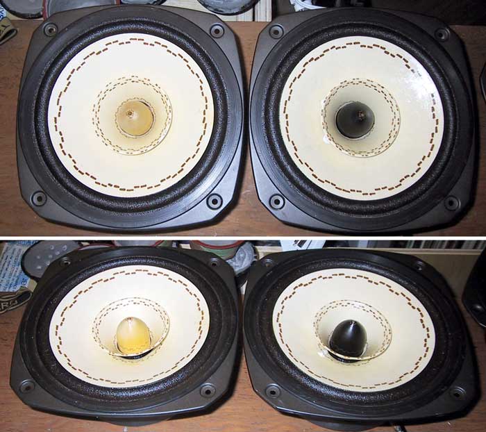

Here are some pictures...
'Black" FE207eN

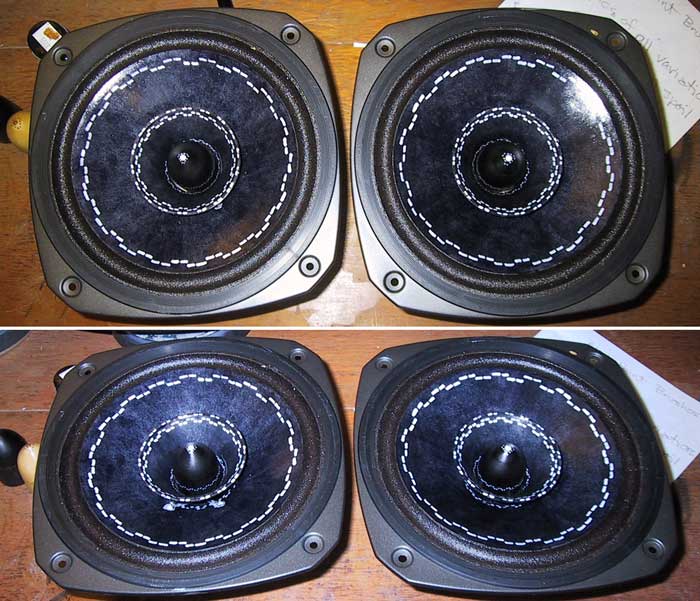

OzMikeH said:
Planet10: Are you willing to share the recipie for the nice marbled black finish on those 207s?
All the stuff i sell is always be fully described... at least when i get a chance to....
the marbled black is actually dark dark blue, and the marbling is just the way the banana paper takes the under treatment.
My experiments with the FE127 showed that the Fostex benefit from an undercoat of puzzlecoat. (on the 126 & 127 there is also a trifoil pattern in dammar under that). To get "black" i have been using some vintage Peerless black ink (left overs from the estate of the father-in-law). Instead of water to thin the PK, i used the ink... also thinned the PK more than usual so that i could get 2 coats on -- black food colouring should do the trick too. I was pleased that this worked because it means the cone can be coloured and then the rings can blend, or contrast or with 7 main rings (2 under the whizzer -- most difficult ones to apply -- aren't visible and the ones on the phase plugs are small, you could even rainbow the rings...
Then white spots and 3 50% layers of gloss on the main cone. Whizzer gets 1. Back of the whizzer ledge gets 1. Phase plugs are still being fine tuned.

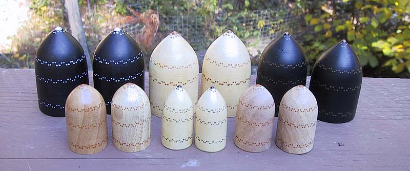

2. The driver I want to treat is a modded B&W 7" kevlar woofer from the 602S3 (I removed the dustcap and installed a phase plug- in itself a very effective mod). In the original, it was crossed over at 4kHz, now it's at 2.8 kHz.
One thing is that I could not remover the dustcap altogether (was affraid to use solvents) but only "circumcised" it, thus leaving a ring of plastic at the cone/voice coil joint. How would you suggest to apply a EnabLE treatment ? How about mamboni ?
bzfcocon
Look here for the mamboni process. They are all involved in Walsh /Ohm drivers and it has been a while since anyone posted to that thread.
http://www.diyaudio.com/forums/showthread.php?s=&threadid=100390&highlight=

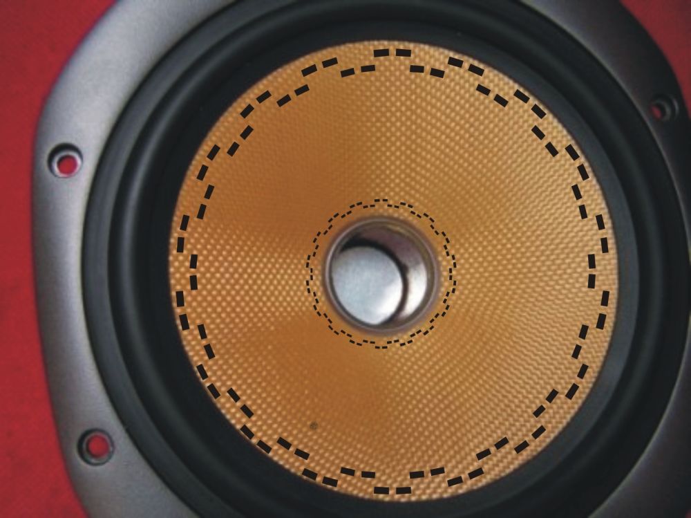

Can you post a more or less face on picture of your drivers, in their current state? Maybe 20 degrees off axis, so we can get an idea of surface irregularities, please? Should be able to photo shop a pattern set or two on the picture, to show you where to position the pattern rings. Be sure to plan on patterning your phase plugs too, it becomes quite important.
Glad you are joining us.
Bud
Thanks Bud !
To avoid posting pictures twice, here's my thread with the mods to B&W:
http://www.diyaudio.com/forums/showthread.php?postid=968241#post968241
However, the plugs do not look like that anymore. At some point, I decided that they are not thick enough and, as I couldn't remove them, I "thickened" them with stripes of alu-bitum (I'll try to post a picture tomorrow). This, of course, is in itself a "treatment", since the plug surface is not smooth, but that is reversible.
bzfcocon,
Here is a pic of where the patterns should reside. I can also attach a Corel Draw 10 file of two ring patterns you can resize to use as guides, assuming you have access to Corel or Illustrator. Dave has an Auto Cad 12 pattern he hands out. Both can be dropped into gif format too. Let me know which works for you.
Bud
