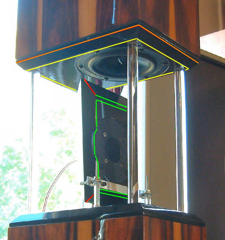

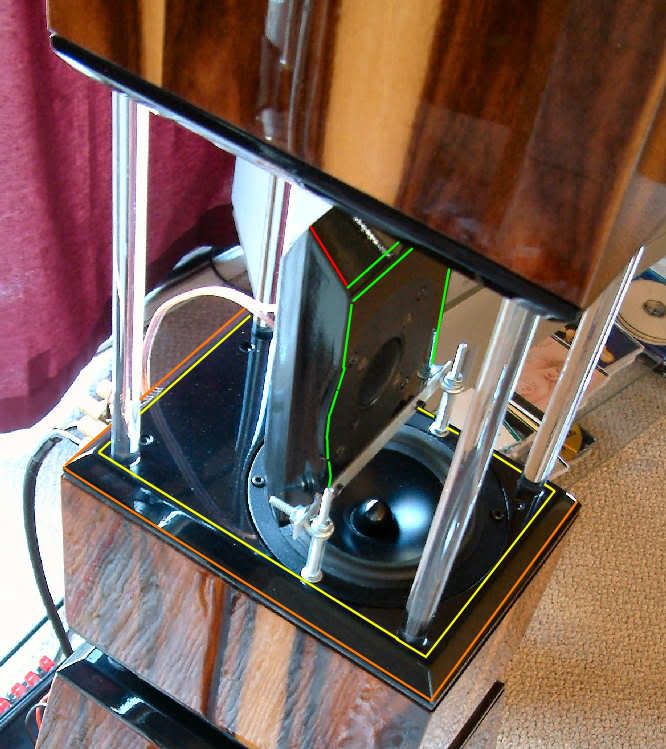

Sorry for being so dense, but I'm still having trouble following your description of where to best put the EnABLpatterns on my driver baffles. Attached are two different photos that may make it clearer how these are configured. On the tweeter baffle, the green is where I have put it so far (also on the back side of the top chamfer). I believe you may be telling me to add the red up and over the top chamfer. Is that correct?
Also, I'm wondering about treating the up and down firing mid baffles. Should I do so, and if so, should they be were the yellow line is or where the orange line is?
Thanks for your patience and guidance.

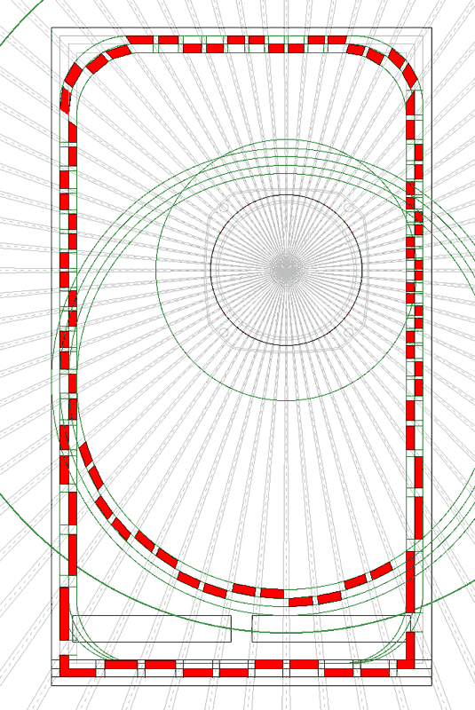

You would treat the pattern as you would a rectangular box face. Take the perimeter, and use it as a circumference to figure block size and go from there with equal size blocks... or you can get fancy and just use the circular array and 4 inscribed rectangles to generate a more complex pattern. green (or blue) painters masking tape can be used to set the limits of the blocks.
dave
fancy pattern for GR Fonken attached
And while i'm at it here is an AutoCad 12 dwg of a basic circular enable pattern... i just scale it to the size of the cone i am EnABLing print that to choose a nib sze, and then print at 90% to get a template to lay down the 1st set of blocks (depending on where you need the template to sit other scaling might be appropriate.
Let me know how well it translates... (there are line weights and line colors and line patterns that the old version of AC might choke on -- i can save as a newer AC if needed.
dave
