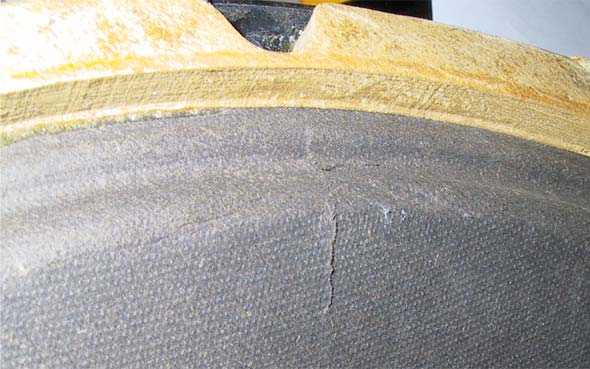

Jim Shearer said:I've begun to experiment w/ some old drivers. Couldn't get the calligraphy pens to work well w/ Testors flat enamel model paint.
BudP said:Did you find the note buried in the avalanche rubble, of the preceding pages, about needing to burn the wax coating off of the pen tips? Also, using them, at least the A series, with the bent tip pointing down is much more satisfactory.
I think your bigger problem may be the ENAMEL model paint; it is way too thick. Watery acrylic, suitable for airbrushing, is what is needed to flow.

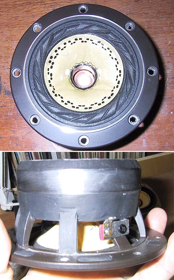

Scottmoose said:Speaking of Sigmas, quick question: how would one best apply EnABL to the hyperbolic paraboliod cones of the ESigma series? The surround & spines appear to be for a similar purpose, but I suspect these might demand slightly different positioning of the EnABL pattern?
Don't you dare treat the 208eS before you get a chance to compare them to treated FE206.207 & FE167
The feedback is important.
Here is a pic of our mule FE108eS, as i asked Bud the same question before starting this one.
Also notethe extreme basket shaping/damping (4-5 months in process that one)
dave

planet10 said:Don't you dare treat the 208eS before you get a chance to compare them to treated FE206.207 & FE167
Also note the extreme basket shaping/damping (4-5 months in process that one)
Cheers Dave.
The 167s & 126s will be done first so I'll be able to let you know how things compare to unmodified Sigs. Be an interesting comaprison to Marc's EnABLed 207s too.
