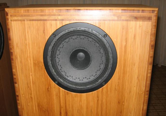

Here are a couple of photos of the EnABL treated Hemp FR8c that we played at RMAF. Done by yours truly in the hotel room.

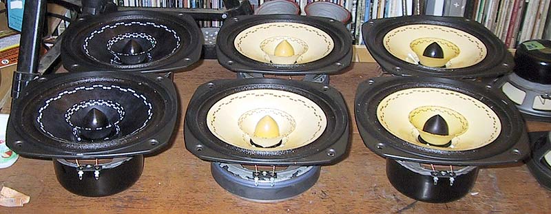

I did have much luck in my earlier experiments with calligraphy pens, so I've done 2 sets with brushes instead. Not the prettiest work you'll ever see, but it works. No glue drop on the dust cap (I do have it on my home drivers). No conformal coating, either. That will come.
The box is made of bamboo plywood and is really beautiful, the photos don't' do the color justice.
Planet10 Dave thinks that the cabinet face is a good candidate for the EnABL, too.

panomaniac said:box design is from Planet10.... "Demetri"
http://www.planet10-hifi.com/boxes-fostex.html#demetri
dave
peterbrorsson said:These edges looks like intarsia,
It is actually the end grain of the bamboo ply... Chris is working up a set of Fonkens right now, i'm very interested to see how they turn out.
Wow, they will probably look stunning knowing Chris's handywork.

The bamboo end grain is very pretty and very unusual. I like it. Will have to have a pair for my living room. They'll fit just right with our tropical decor. The bamboo plywood we used has been caramelized, so it has a lovely honey brown color. In the photos I posted it looks too green. It's not.

I've begun to experiment w/ some old drivers. Couldn't get the calligraphy pens to work well w/ Testors flat enamel model paint. The wide tips did fairly well, but the small tips for the center areas and small domes either wouldn't write or made blotches. So I switched to a brush: "000 Series 7 Finest Sable Winsor & Newton England". About the smallest brush I've ever seen. Now I can get those little dots!
Cheers, Jim

Did you find the note buried in the avalanche rubble, of the preceding pages, about needing to burn the wax coating off of the pen tips? Also, using them, at least the A series, with the bent tip pointing down is much more satisfactory.
I just use the Rapidiograph pens for small dots, but I am used to them and have a huge number of tips.

BudP said:Did you find the note buried in the avalanche rubble, of the preceding pages, about needing to burn the wax coating off of the pen tips?
Nope. Explains why they work better after a good wash in hot water.
I have foud the 56 tip to be good for the little bits. For FE206/207, i use A3, A4, A5 and 56.

I have found the 56 tip to be good for the little bits. For FE206/207, i use A3, A4, A5 and 56.
I couldn't get the #56 tip to flow at all, even after thinning the paint. The wax coating that I see mentioned was probably the reason. I used a whittled down bamboo barbecue skewer for the tiny dots, actually worked ok. The A4 tip worked quite well. Thanks guys.
