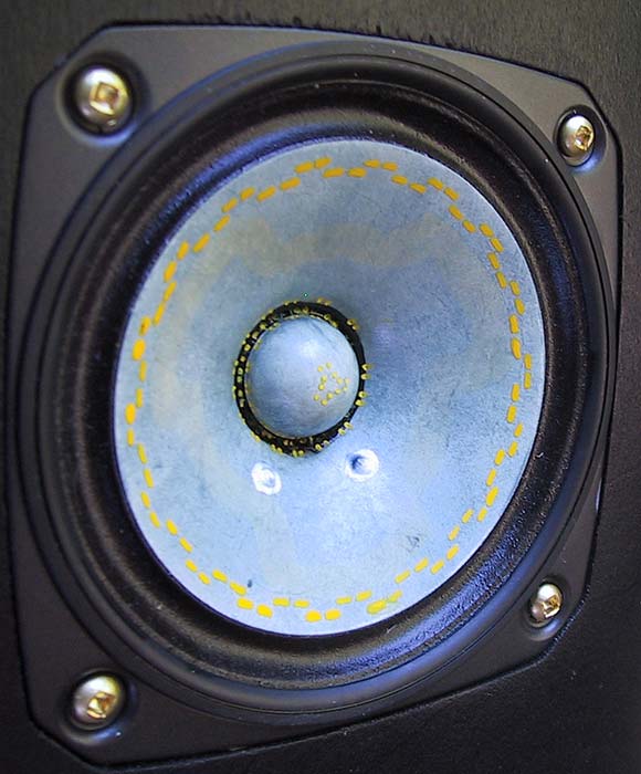

Zen,
Looks like very good workmanship.
Now, you need to put a dot in the middle of those central block rings. The dot should be paint first and then, when dry, a drop of PVA (white wood glue or speaker surround to frame glue).
This PVA dot is going to enforce maximum lateral dispersion for highs.
The end result will be that, as you move from an angle that allows you to just look into the cone, all the way to the voice coil, all the way across to the other side of that cone described arc, there will not be any hot spots or any cone specific location clues, even directly in front of the dome. All sound will seem to arise from behind the driver and will be coherent to that sound field, without ever seeming to come from the driver, at all regardless of your angle to the cone.
You use the gloss to enhance this performance by using between 1 to 3 times as much on the cone as on the dome. You are correct to listen before applying the gloss. If the bare treated cone already has no hot spots, then a 50% coating of gloss on dome and cone may be all you need.
Another 50% coating on the cone will not harm matters, but may cause a "tight" sense to the sound until break in is done. Any more will provide a very hard and somehow edged sound that some folks like, but has little to do with reproducing music.
Minimum application and careful listening, to understand what the first coat has provided, is needed here. I always listen to increasingly "dense" music, until I either run out of torture tracks or the music suddenly gets corrupted in politeness.
This corruption will get down to some very small issues. The difference between a pair of soprano's and an alto horn being three voices or swirled up into one, is a useful marker here. Piano's embedded in a violin wash are also excellent torture. If the piano sounds sick or flat, but is still quite distinct from the violins, you need a couple of Electron Pools, not more gloss.
When the corruption no longer occurs, I stop applying gloss coat, and this has always been just enough.
You are proceeding exactly as I would, with an unknown driver. Just take tiny steps from here on, listen carefully and learn to hear what "politeness" might mean from treated speakers.
