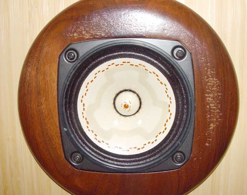

Here are the driver's after the last round of upgrades...
The EnablED drivers are in. They DO sound better – MUCH!
Cleaner in the upper regions, more solid in the lower-mid. Better tonal balance.
As far as I am concerned, this is an A+ upgrade.
dave

Yay my first enabled drivers
Finally got around to trying the Enable process out on some old philips 7 x 5" fullrange drivers (around 1970s)
Used some deep yellow acrylic model paint (Acrylicos Vallejo) and managed to find the Microscale Micro Gloss that Bud uses for the conformal coating.
My inital impressions, after only modding one driver with the pattern (was just done freehand, as I found it a bit trick to do a oval pattern). I was quite surprised how much cleaner the sound was, all the instruments were far easier to differentiate, I heard some quieter sounds I couldn't hear before, treble and midrange was definitely louder, bass was tighter but seemed not as low, but that might be because it was no where near as bloomy.
So I did the other driver and apply the 50/50 thinned single conformal coat to one of the drivers. The conformal coat seems to bring more balance into the frequency response, treble and midrange levels seem to be lower a little, it made it all a little smooth but a little more microdetail seems to be able to be heard.
I do have a question though, how do I know how many coats of the conformal coating I need? what should I be listening for?
I will also try the Mamboni triangles on the backside of the speaker once I get some felt. What thickness felt should I use? doesn't the felt add a lot of weight to the cone? is it better to use it only with larger drivers? At the very least I might try the triangles on the inside of the basket legs.
The additonal clarity is astonishing, it makes me wonder how much clearer a driver can get that is already very clear, but I will practise on some cheaper drivers before I try my fostexs.
zBuff,
Congratulations, you have joined a still very select clique.
The EnABL pattern provides the same format of improvement to all drivers, does not matter their provenance. Certainly the better the driver, in terms of typical piston theory based tests, the better the end product.
Percentage of overall gain in listenability does not change however. Even the Lowthers are altered to the point that Jon Ver Halen of Lowther America makes the same complaint as Planet 10. That it is very difficult to listen to untreated drivers, once you have been infected with the EnABL variety.
Lucky me, I have been listening to EnABL'd drivers for 34 years. Lucky you, you get to listen to them from now on.
Wonder how long it will take to get the rest of the world to get this lucky?
As for Mamboni felt, I was advised to go to a Female style craft store and look for the thinnest cotton felt available. Then to lightly coat it with PVA and coat the surface of the cone with PVA and stick it on.
Stopped me cold every time I have thought about it. PVA is essentially Elmer's white wood glue and you can thin it down to a very thin coating. Planet 10 knows about this, I have never done any work with the thinned variety of PVA. (Poly Vinyl Acrylic) Lot's of experience with it full strength on cone woofers, though.
As for how many coats of Gloss? The fewer the better. Typical application runs from three full strength coats on thick felted cones to three 50% coat's, using less by half for every layer, for the thin calendered paper as used in Fostex and Lowther drivers.
Your older cones, with a thin felted cone, will probably top out with three 50% coats. Really though, if you like what you hear now, leave it alone.
I know what you mean by saying how astonishing it is to hear music from treated drivers for the first time. Like you finally got to go inside of the concert hall and sit in a good seat, for the first time ever. Even with cheap drivers, that just squawked and grated on nerve ends before, and you never knew how bad they were.
