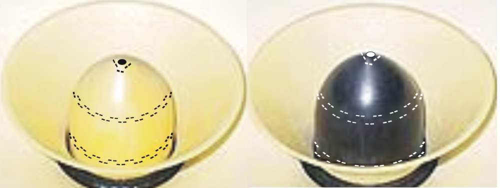

Dave,
Here is how I would deal with the phase plugs.
Bud
In the spirit of how Bud is approaching this (and the way i tend to be anyway), templates will be freely downloadable. Once i get a handle on the quickest way to generate them, i'll also generate a pattern for most anything -- at least the flat disk templates.
Actually, taking any template and fiddling with the size percentage in your page setup dialog (don't know if that is what it is called in Windoz-land), you can pretty much scale any existing disk into the size needed for any other driver (ovals are a bit special)
I will also be selling EnABLEd drivers (i'm working on a licence with Bud), and doing drivers after the fact. With EnABLE there is a lot to be said for some experience in applying the patterns (i have some drivers already available for cheap that sound REALLY good, but are less than stellar cosmetically). It has taken me about 20 drivers to get to the point where cosmetic glitches are down to acceptable levels.
dave

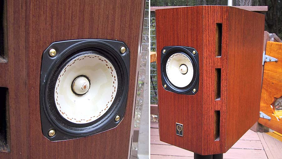

Hello Bud,
I have finally fully EnABLed the 6.5 Hemps and I must say that they sound much more civilized now.
See: http://www.diyaudio.com/forums/showthread.php?postid=1288466#post1288466
The upper midrange peak or shout does not call attention to itself as it did before. Not that it was a big problem - you really had to listen for it and it didn't get in the way of the music. I guess the hemp has good dampening properties.
Sibliant sounds are not grainy anymore and the soundstage is less constrained to the speaker. By this I mean that certain instruments such as violin or sax would at times zip back into the speaker cone during loud passages. The conformal coating (micro gloss) really did its job, it's a must!
I have a question for you Bud; did the FR 4.5's cone soak up a lot of the micro gloss? Because the whizzer of the 6.5 reacted nicely to the coating, not so the main cone. It took in more of the coating than I expected, however the sound seemed to benefit from the treatment, excessive coating or not. Just a heads up before you start on the hemp FR 8 driver.
Best
Kris

hasselbaink,
Good news. Another success story.
The pressed fiber cones, regardless of their material base, soak up mad amounts of gloss. Trick is to allow them to dry for 48 hours before applying subsequent coats and listen to make sure you really want more.
Three coatings, 100% material, is the most I have ever needed. That, only on the large thick woofer cones, which then became astoundingly clear and capable. Along with producing bass that uses the entire house as it's projection volume, instead of politely using the walls of the alleged listening room as a boundary. WAF can become a major problem.
If I wasn't so lazy I would go back and copy the information on coating the 4.5 and put it here. I will say that the hemp cone material is much better behaved than the typical paper slurry materials. Not quite as good as the filled and calendered paper for Lowthers, but still very respectable. I would also point out that all slurry cones will benefit from two sets of pattern rings on the back side of the cone. They do not have to be neat and precise and you only want to use one coat of the gloss material.
Listen to what you have for a good long time before you do this. You will gain about 30% in clarity, mostly in parsing of fine detail and finesse in handling transient spikes. Only draw back is absolute transparency to backside reflection, from cabinet walls and standing waves from OB baffle boards. This is what interested me so strongly about the Mamboni part of this thread. Control of the back side, without this transparency drawback.
Very happy to hear you have civilized those wild weeds...
Bud
