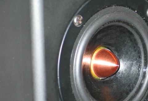

Here is a pic of the treated FR125's with stealth block patterns for what it is worth (not much).If you squint really hard you can just make out some of the pattern at the top right of the picture.
I would never use black paint on dark cones again it was very difficult to apply as the light had to be just right to see the blocks already applied. Next time I would use a contrasting colour and then maybe use a black marker pen to colour over the blocks.
I haven't done anything about the phase plug as you can see.
