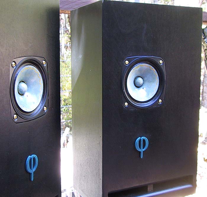

Hi Dave,
Thanks!
I'm extremely happy with the sound. The soundstage is astounding, yet the transition from omni to direct firing in the tweeter makes for excellent imaging as well, IMO, that is.
There has been a lot of hours testing, building, finishing, etc., so I'm always looking for any way, especailly something relatively simple, to improve them. I'm not afriad of the time it would take to do the enable. I will probably want to try something temporary on the woodworking parts, because I don't want to mess with that until I'm certain if will be a worthwhile improvment.
Thanks!

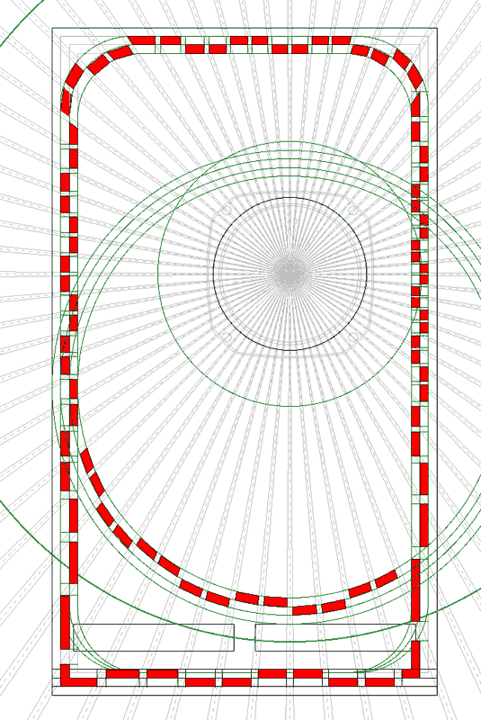

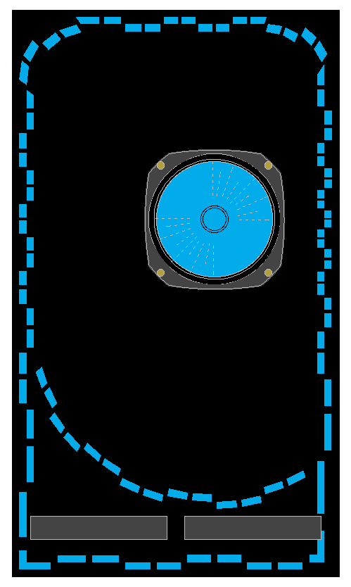

I'm prepping to EnABL my 1st box... i want to start with the GR Fonkens (image attached) as they are already a show-piece. Instead of just doing constant size blocks i decided to try my hand at something a little more artsy-fartsy. I've already discussed pros & cons with Bud about average length vrs "official" length blocks & the opinion is that it doesn't matter... before i go ahead i want to pass the patterm past Bud and thot everyone else might get something out of it. more next post
dave
dave
Here are the guides i used to generate the pattern. You can see the radial pattern generating shape underneath as well as guides for the block height. I used the avaerage of the longest & the shortest block divide by 2 to get the block height. I figyred that the blocks needed to be above the ports, but for cosmetic completness (with sides & back) they also needed to be under. The arc patterns on the top corners, and above the port are intended to reflect the underlying radial pattern generator.

Looks fine to me, You may find that a ring on the basket of the driver, just before the gap to the baffle, will also help get the pressure wave to expand uniformly. Not usually critical but that is a very definite boundary layer interruption and it is really easy to get anal about this procedure.

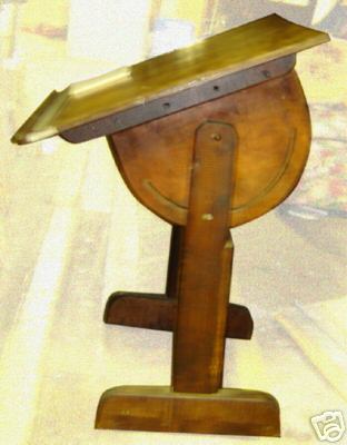

Hi Ed!
I'm thinking of something along the lines of the drafting table in the attached photo should work. Mount a rotating platter on to it and mark off 2 degree increments on the platter. Getting the speaker centered and held in place could be a little tricky tho -
