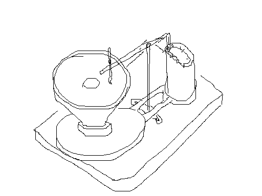

Silly Contraption
Heres my best very silly contraption after have some fun mulling over a few ideas lastnight.
You have 2 turntables connected together with a belt which has equal size cogs on the underneath, causing the 2 turntables to turn around at the same rate of degrees.
One turntable goes a centred speaker driver, on the other goes inversed wooden(or something else solid) template. Inspired by the Dave's picture, between the 2 turntables is lever arm with a paint applicator of some sort on the speaker end, and a weighted guide that moves up and down on the wooden template.
With multiple lever arm applicators you could all the patterns across the whole driver in one revolution. It should also be possible to apply patterns underneath whizzer cones easier with such a device.

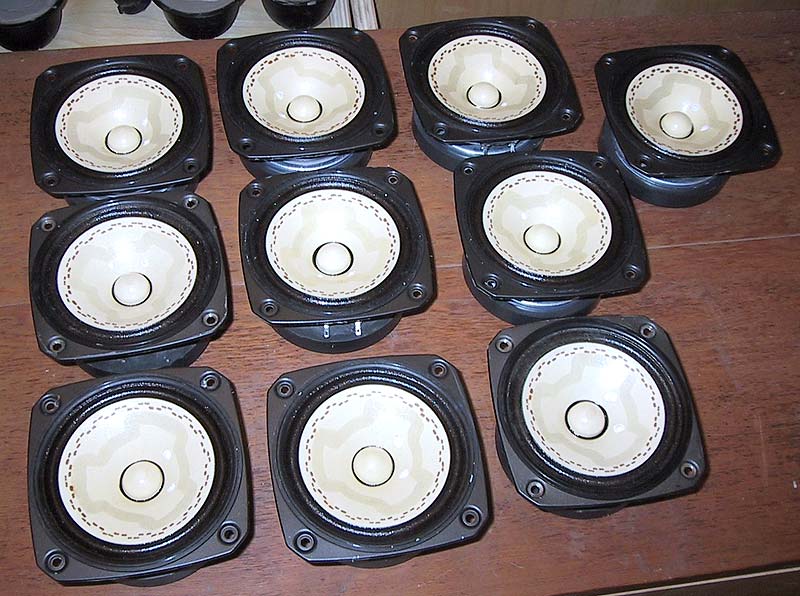

Whew...
it is 2 1/2 hrs later and i have just done the inside rings on 14 more drivers. I had in the past procrastinated at tackling inner rings because it was by far the hardest part... 1st batch i used the 0.6 pen that Bud had suggested ($35 at Island Blue Print), I spent more time cleaning it than using it. Part way thru the 2nd batch i adandoned the pen and tried the smallest calligraphy tip that came with the cheap-*** caligraphy starter kit from Michael's. That was a lot easier, but control wasn't quite as good as the pen (when the pen worked). Today i used a higher quality 56 round point calligraphy pen (<$2 -- picked out as the smallest practical caligraphy nib i could find at Island Blue). It worked a charm....
So until "the contraption" is perfected, add a 56 round point as a substitute for the pen in your manual EnABL tool kit.

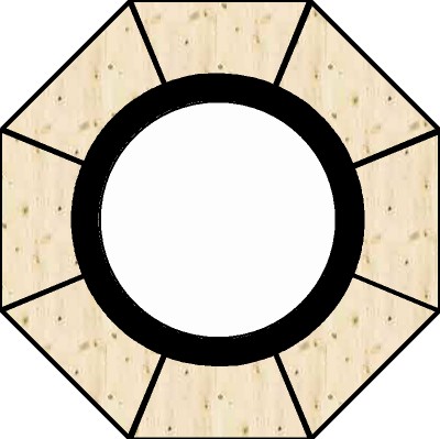

Thoughts for today regarding some type of fixture upon which to mount a speaker that is to undergo BudP's EnABLE pattern mod.
I wanted to do something simple and low cost that could be easily stored after use and came up with the idea of using an octagon shaped "baffle" like "contraption" (Hi Dave!) 😉
You would need to make one for each size of speaker to be modified as the center cut out allows the speaker to pass through the device and be secured to it with regular mounting screws. The speaker then rest on the magnet assembly in the rear and the rim of the "contraption" - (Hmmm - I think I'll name it "Lazy Ed" in honor of Mongo). The "tilt" in elevation could be adjusted by placing some type of spacer beneath the front rim. With 8 sides you get 12 degrees (more or less) to work with before you rotate it and go to work on the next section.
