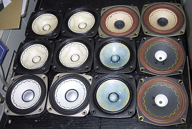

Did my 1st rings tonight. 2 sets of practise drivers + some test mules (3 variations on the FE127 treatment + the lone set of FF125 i have) All colour coded. Hopefully i'll get better with practise.
dave

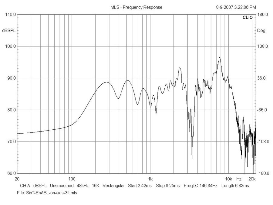

EnABL frequency response
OK, repeating myself. On axis, 3' away, no smoothing. Lowthers are much better when off axis, but these measurements were meant to show the difference between EnAbLD and standard. So, in essence, I am saying these are ugly and I know it.
