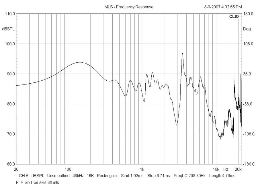

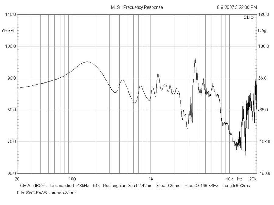

Frequency response - standard
Same exact specifications except no EnABL on cone

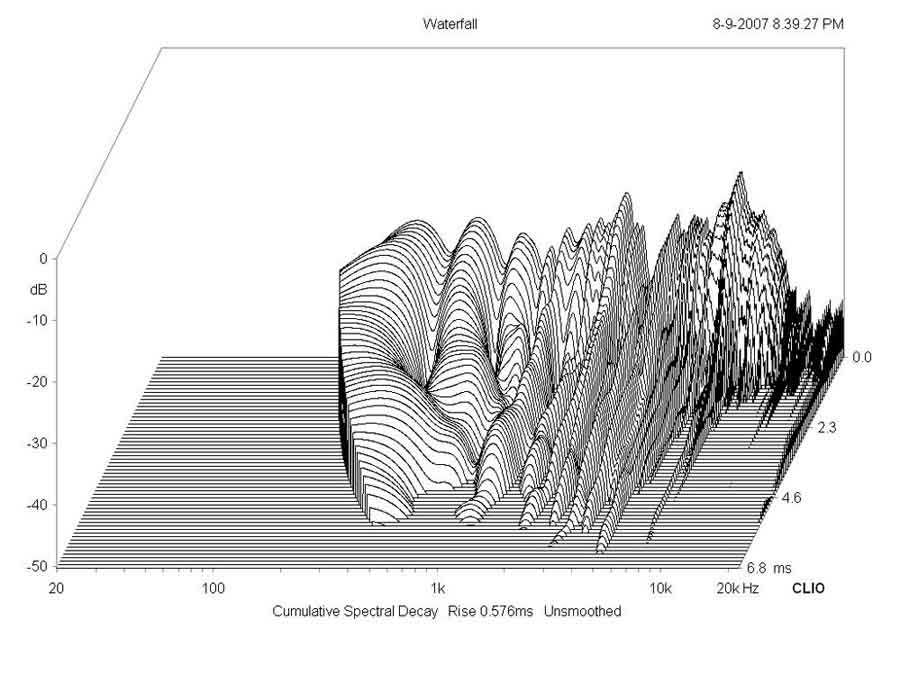

Standard Cone Waterfall
Finally, the standard cone waterfall. Note that there is a difference in the time scale between this graph and the EnABLed cone. My mistake, but you can see the difference easily.
Now would someone look at these and tell me why I hear any difference. I printed them up, held each one up to the light with its Standard/EnABL cone up to the light to look for significant differences, and could not find anything of note.
Have some fun with these! I guess I should post some smoothed off-axis graphs so you can camper these to standard manufacturers graphs.

Re: Standard Cone Waterfall

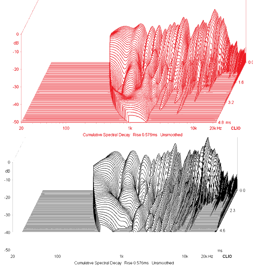

To do a really good compare, the scales do need to be the same. Also if you save these files as low-bit gifs they will be easier to manipulate (& smaller file size)
Here is the waterfalls -- all i could do is chop off the EnABLEd one (black) at the same place as the stock
(It would also make things more obvious if Clio was able to do waterfalls with a time scale of periods instead of sec)
On the whole the EnABLEd cone doesn't look as good in these waterfalls as the stock one -- particularily above 1k.
dave

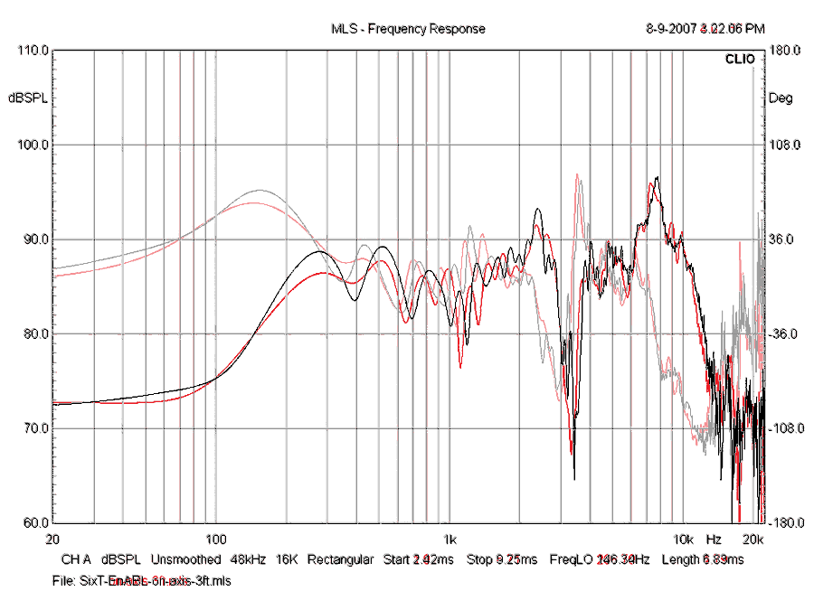

And FR & Phase. EnABLE is black, the "grayed" curves are phase. Be nice to see off-axis curves where we would have flat as a reference. Not much to grab between these 2, again if one had to choose, stock looks a tiny bit smoother (ie in most cases peaks & valleys have slightly less amplitude)
dave

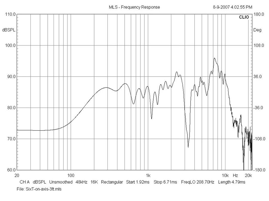

Re: EnABL frequency response
Jon Ver Halen said:
OK, repeating myself. On axis, 3' away, no smoothing. Lowthers are much better when off axis, but these measurements were meant to show the difference between EnAbLD and standard. So, in essence, I am saying these are ugly and I know it.
Jon, I kind of get the feeling your are still getting some reflections in your data. If you used MLS signals for testing, might try reduing window size to see if the camel humps on the left side goes away.

Looking at Jon's data, I really cannot tell whether it's better or worse. Perhaps someone and elaborate on that?
