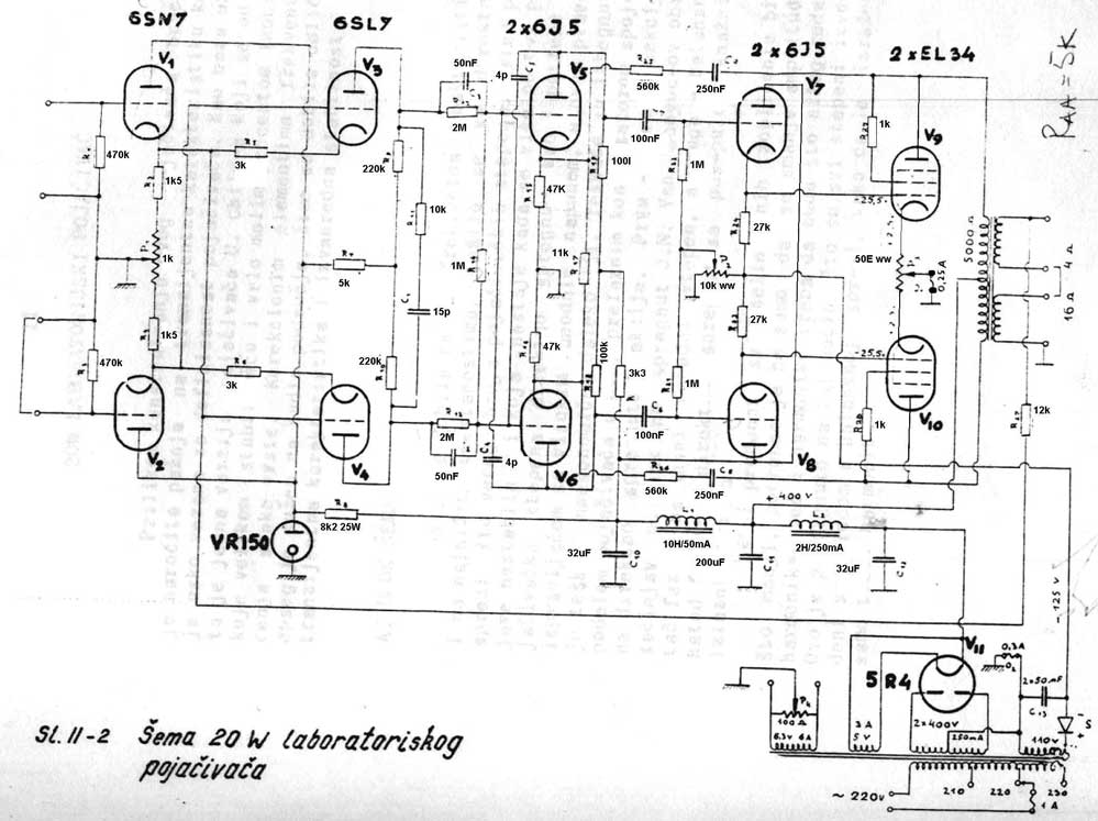

BudP said:
for starters
rest on PM in a few days........
nightmare of Photoshop-ing to make scans readable and reasonably small

Thanks Choky,
A simple amplifier circuit from the Master....... I am encouraged to build it already. I hope the trade was sufficient? If not, let me know and I will scramble around and invent some new foolishness, to frighten off self respecting engineers with.

I promised entire book to you,and you'll get it 😉
it's little slower than I thought , from many reasons, but I'll send it...
mebbe because you already are foolish enough to deserve it ?
