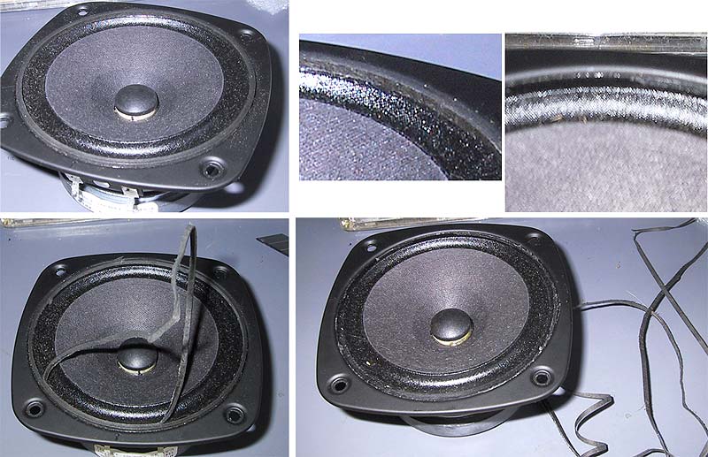

Hemp FR 4.5 C
Here is the real meat of the thing. This is an obscenely good speaker. Everything was looked after with true professionalism..... except one little detail.
For some reason Hemp and designers got to the place where they had everything done correctly. Then, someone, or no one, decided to put the finishing touch on and added a little vertical walled trim ring over the surround glued edge.
Now, everyone does this, some use a flat smooth piece, others use a molded piece. Whats the problem you ask? They all create a Raleigh wave at their frequencies of interest. In most speakers you would never know. In all speakers this foolish act inhibits stage width and adds a peculiar sound to the final event. Almost the same ear twisting torture as IM distortion, except there is only one frequency involved. Usually you can't hear this over the rest of the problems no one took care of. In this driver there are no other problems to cover it up with.
In this Hemp driver it is the only problem. Once treated to EnABL and it's explosive release of dynamics and color and stage width to die for, they still somehow sounded like "Pixie" speakers. Truly low distortion sweet extremely finely detailed sound, in a huge sound field, but every object was ....tiny.
I went ahead and coated the mounting frame, to see if this would disturb the situation enough that I could ignore it. Nope, just accentuated the Raleigh wave running around inside that damn piece of cardboard tube, edge glued to the surround perimeter.
I then looked very closely and finally noticed how much this piece stuck up above everything else. Curses!
However, EnABL is up to even this task. When you peruse the pics you will notice a very unusual looking pattern, half on the side wall of this ugly trim hoop and half on top. This does kill the Raleigh wave, it does also unleash the hounds of Hemp ..... Boy, if poor Limono thought he had a nuclear weapon on his hands, just wait till Richard gets these things back.

To treat this wonderful speaker you are going to have to come up with an 0.050 Rapidiograph tip, for the lower ring and the dome ring set's. The dome ring set would be infinitely easier to do with an 0.035 pin tip, but Planet ten tells me they are scarce nowadays. So, when you go to pattern the dome use a very quick stroke, to get the minimu8m possible dot size from the pen tip. Also, keep using your finger nail edges to carefully remove the excess paint build up around the tip end. This is Poly S paint of course, thinned to 50% solution so it will pass through the pen tip.
The upper and outer ring were done with an A4 calligraphy pen tip and that's all there is to this part.
The Gloss coat is another thing entirely. All surfaces need a single coating of 50% strength Gloss coat cut with pure water not alcohol, and absolutely no more. Had I been alert enough to place the outer ring on, before I put on the cone Gloss coat, I might very well not have applied any Gloss coating, anywhere. That is how good these things are.
So, if you are going to treat yours, and I really do recommend it, if for no other reason than that you can startle folks with how immense a sound field they throw up, from such tiny drivers. Plus, all of the designed in goodness shows up.

Re Hemp 4.5 trim ring
Hi Bud, after reading about that cardboard ring being a problem i found it easy to remove it.I inserted the tip of a knife GENTLY through it flush with the frame to split it. then I cut through most of the way from the top at that point. I found that it would lift off the surround. Once i had about 1/4 inch off the surround and could complete the cut through it was just a matter of gently twisting toward the outside edge of the frame. It let go quite easily without pulling much on the surround material it's glued to. The adhesive seems quite soft. Everything looks neat and clean with it gone.
Pictures of Surgery?
Jim_G,
Could you post some pics of the process, or at least the final outcome?
Richard
Jim_G,
Richard
Re: Re Hemp 4.5 trim ring
After looking at mine & poking it a bit, i think i accomplished the same thing a bit differently.
