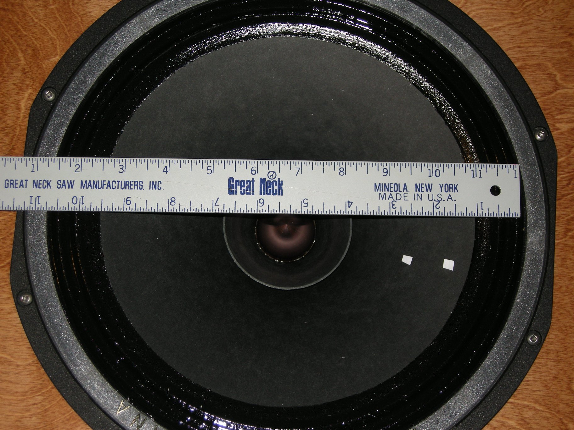

Cone tapping result
Bud,
After couple weeks tapping, I have the attached photo shows with white dots of where I found the tone different from other area, and dimension are as below.
Main cone dia. 9.25"
first white dot is about 12-13 mm from the first pleat of surround.
second white dot is about 25 mm from the first dot.
Whizzer cone dia. 3"
I can clearly hear the tone different at the cone right under the outer edge of the whizzer.
Can I just simple make the pattern to size that you have for super 8 for my application ??
Albert

Sorry to not respond, I am not receiving notifications about posts to this thread and am unusually busy at this time with audio transformers. Please give me a couple of days to perform the processes I have to and I will provide you with pattern sets for the cone dimensions you have provided. I am faintly suspicious of these dimensions as they do correspond to possible changes in timbre of the resultant tap, but might not be the locations for change of direction in the decay.
Right at or just under the whizzer is a typical placement for one set of rings by the way.
In any event you will not harm the driver by adding these ring sets where you have indicated, just pointing to the possibility that you will uncover further needs once these have done their work.
Bud
