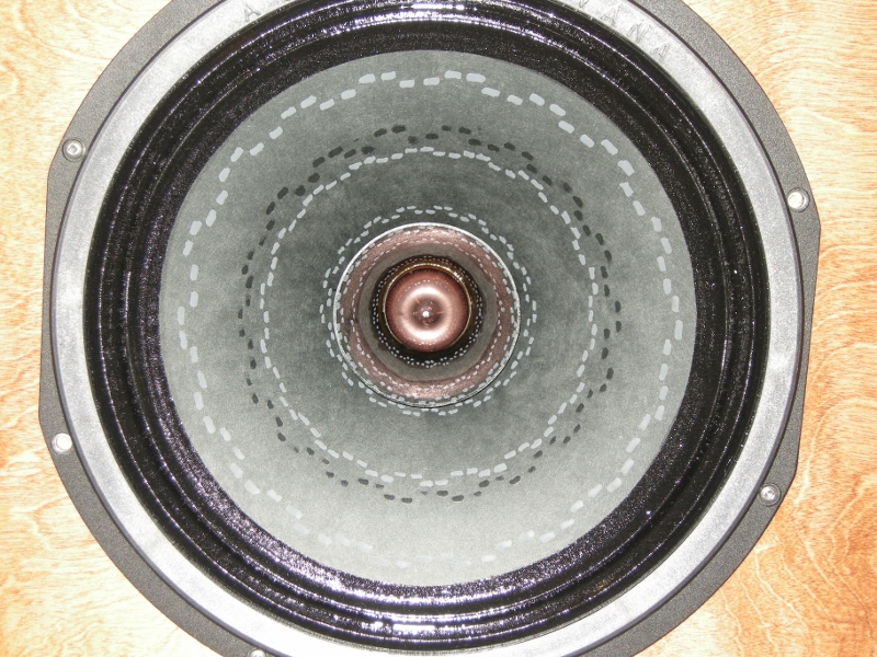

Pattern finished
Bud,
I have my AN12 pattern finished. Please take a look and see if there is anything I can do better before I apply glue on the cone.
I know I have to put glue to the back and front of the whizzer and at the back of the main cone from surround down 25%.
1/10 gloss to the back of the whizzer and cover the glue at back of the main cone. 50/50 one coat at front of whizzer, 2 coats at main cone. Please correct me if I was wrong.
Should I do anything purposely to kill the 1.2k, 2.5k and 5k as of the advise from Michael Chau, especially the 2.5k.
Albert

Alberti,
This looks like a very good start.
I am pretty sure you will need two more ring sets on the main cone, between the mid cone ring and outer ring to address the frequency issues you note. You will have to apply yourself to the tap test subtleties to find these, though your applied rings will make it easier to do. Then, please listen to the drivers mounted in their enclosures before applying anything else. No glue, no gloss coat.
Doing this will allow you to learn what EnABL is teaching about reproduced intelligible signals. It does take a while to get up to speed and initially you are likely to be confused about what you hear. The drivers will no longer sound like speakers and you have to get used to this more natural presentation before you alter the whizzer output and correct for the Raleigh wave out on the outer 25% of the cone.
This is the way I go about treating new to me drivers and I will be able to help you decide what and how much of the glue and gloss to apply after you are familiar with the sound and have begun to isolate what is still incorrect in the time alignment presentation of note and transient specific gradient of tone.
Bud

Bud,
Thanks for the encouragement.
OK now I have 3 sets of rings on the main cone. You said I should test and add 2 more sets of ring in between these 3 sets of ring. Am I right ??
Albert

Alberti,
It is unlikely that you will need more rings between the innermost ring and the middle ring. Most high frequency disasters occur between the mid cone ring and the outer ring. I realize that it is counter intuitive to a pistonic understanding of drivers, but the outermost ring controls the highest frequency dispersion. As frequency drops so do the sizes of rings needed to disperse the disruptions caused at those frequencies, that narrow their dispersion. These disruptions also create the sharp FR peaks and valleys, shown in a CSD plot, that interfere with the coherence of phase or timing within notes etc. These are notes and transients have a portion of their time structure disturbed by these non pistonic activities on the surface of the cone and in adjacent air.
The added rings on the main cone, if needed, will come between the outer ring and the mid ring. It is possible that a fourth ring will need to be added to the whizzer in the corresponding area of the whizzer cone. All of this to be determined by tap test results and listening. Do the listening fiurst please, just as they are now.
Bud

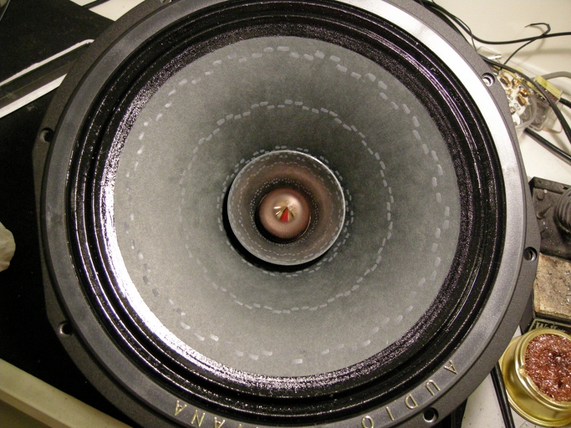

ncdrawl,
Here is your pattern guide and a pic of where the final patterns must go for EnABL 1.0. Note that the inner ring pattern guide is bigger than the patterns you will apply at the dome / cone junction so use the inside of the ring guide.
You will need to add a third ring as shown on the pic, up on the beginning of the wall of the dome, so three rings here rather than two as out at the surround.
Should you want to step up to EnABL 2.0, a tap test and additional ring sets will be needed. The applied ring sets will not need to be altered.
Also note the center dome pattern shown on the pic, though most of it is on the ruler. This will be a necessary addition that does not have a pattern guide.
Likely two coats of 30% Gloss to water will be needed for the cone and a single coat for the dome.
You must practice your pen techniques before treating these speakers. Buy some cheap 4 inch junk and practice the upside down technique for block applications.
Bud

Bud,
Thanks and I'll have a listening test first and see if I'll need another ring between the outer and mid ring. tap to determine the location if needed. Will post the listening result.
Thanks again
Albert

Bud,
After listening for almost 20 hours and I should say I wholeheartedly respect your innovation. It works for me and the patterns kill almost 90% of those problem areas. The speakers are almost disappearing and I could only feel the wide sound stage. The sound come in layers and the imaging is very good indeed. I don't know how to tell the sound, but I really like it.
I can still find the glare/shout on the highest note of the violin and the soprano. There is also a kind of congestion on complex music. I don't know what frequency that areas belong to and I test the cone again in between the outer/ mid ring and I tap found that is a area just above 8mm on top of the mid ring. I put a ring on that area - the one with darker color. Please take a look and see if I have done anything wrong. Will test it tomorrow night.
