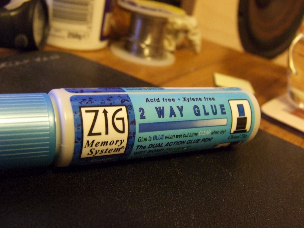

Ed & Albert,
Albert is going to need a bottle of the 2 way zig glue to deal with the subduction zones in the cone and whizzer of the AN driver. Ed if you can provide this I am sure it will help. If not, Albert, start digging!
Bud
Bud

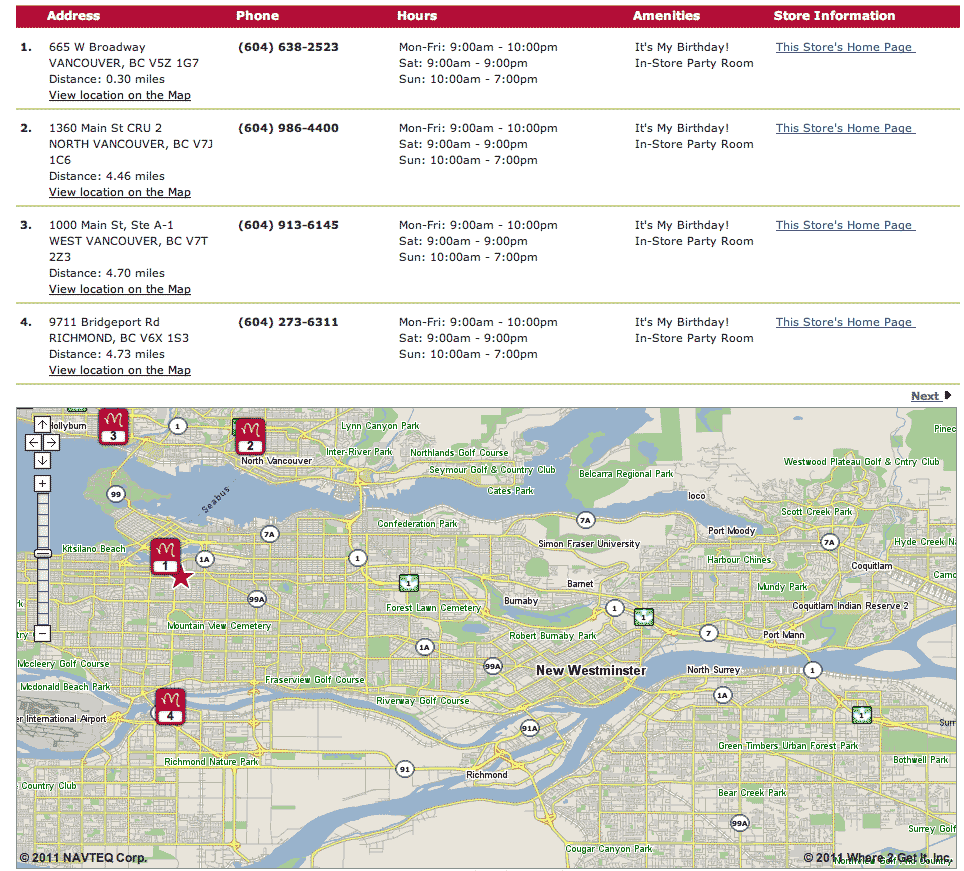

This is available at any Michael's craft store, there are 4 stores in the greater Vancouver area.
dave

Do I simply ask for ' 2 way zig glue ' at the shop, or there is a name for it.
Albert
dave
Dave,
Thanks and I know there is one close to where I work.
Albert
Take a picture with you...
dave
"scrapbooking" is a key word for your search. Those who cut and paste, literally, love it...
A Michael's store would also have brushes and mixing containers to choose from...
