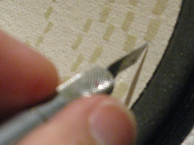

A couple of comments on that proprietary white factory coating on the LE8T-H: It is fairly thick and quite hard. I feel it is significantly harder than the gloss coating that went on the 2235 woofers - probably because of the pigment. I guess the white pigment is aluminum oxide rather than titanium dioxide because of a little trick I tried. First the rationale, then the trick and finally the evidence for Al203. I thought it best to use fairly heavy paint spots because of the hardness of the white coating, which would give the outer surface very different properties from the normal paper rear layer. Sometimes those generous acrylic paint dashes would flow a bit where I didn't really want them. Solution? After the paint was dry but not cured, simply scrape it off with an Xacto knife! The white JBL substrate was immune to this scraping. In fact, it would discolor slightly due to residual steel from the Xacto knife blade showing that the pigment was abrasive. Aluminum Oxide is certainly hard enough to do this. I attached a slightly fuzzy demonstrative photo.
So if you see some 'impossibly' square ends to a few of my paint dashes, that's how they were achieved. BTW, if a dot got too much paint on it? I let it dry and then scraped the entire surface side-to-side with the knife edge of the Xacto. The paint will abrade to dust. Simple and safe...
However, I recommend extreme caution scraping against any other cone surface substrate!
