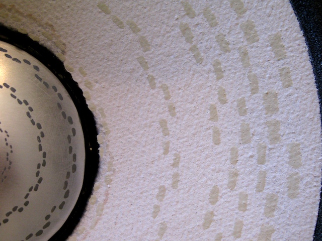

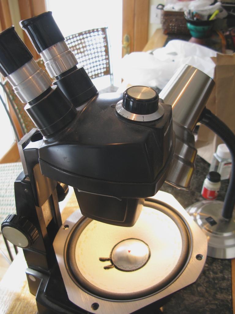

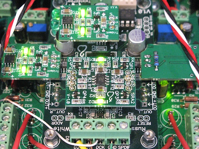

I thought I'd check in with a little update on the JBL LE8T-H drivers with which your help was so pivotal. They were dialed-in to perfection for my Twisted Pear Buffalo II DAC / Legato I/V stage / balanced amps. I had been hoping to add the optional shunt regulated power circuits (called 'Tridents') to the Buffalo DAC. Finally a new batch became available last week - mine were installed by Thursday. The effect of the shunt regulators on the analog signal 'coherence' (for lack of a better term) sounded *identical* to the the effects of EnABLing the midrange drivers! That was pretty cool except - unfortunately - the LE8Ts weren't dialed-in any more! Significant 4-5kHz resonance was killing all the listening pleasure. With enough sampling I isolated the problem to the 2" aluminum midrange domes so I added another ring pattern in the 16 mm untreated gap. This resolved 85% of the resonant misbehavior. The last ~15% I erased with a mid-cone ring pattern at the edge of the rear damping material, as we had discussed previously. Now the drivers sound no brighter than before all of the 're-tweaking', but they coherently manage a signal that is truly 'put together'! The 'wall of sound' illusion (etc.) took a quantum step. The shunt regs for the DAC were a surprising upgrade. I'm glad I had to go back and re-tweak the drivers because the sound is becoming nigh unto breathtaking - at least until I've worked through my music collection a couple of times. For reference I attach photos. A) the current dome treatment, B) the current cone treatment, and C, the little glowing 'heaters' on the DAC.

Hi Frank,
Really nice workmanship! Can I talk you into laying a ruler across the LE8T and taking a picture of the whole driver please? That would allow me to develop a set of ring application guides specific to the driver, so others with slightly less native courage can benefit.
I would bet that one more ring set, on the LE8T drivers, will eliminate all of the remaining "slightly uncomfortable" output. I have just recently been back to a driver / Fonken box combination I had not listened through for perhaps 10 months. Mark Audio has released a series of drivers, of which I was able to treat and listen to the Alpair 7. These were dealt with using the techniques that arose from George Soon's investigations four years ago. Being the tap test you have been introduced to, though George was much more incrementally thorough in his treatment of a Jordan JX92s driver, with ever greater in diameter and ,or, number of EnABL pattern rings, made from toothpaste.
Addition of one more ring set to a Fostex F 127eN driver pair I have had here, has completely removed ALL drawbacks to a single full range driver use of these delightful little speakers. The last three upper register piano notes that were not perfect, the removal of a blurring to the leading edge of ride cymbals and another level of depth of field and placement of instruments within, has resulted from adding just one more ring set to the cone and dome. You have done the dome, but it may be useful for you to investigate the area, between where the backside glue left off ring set is applied and the final outer ring set. Having had success with five different drivers, including the F 200 A with adding this fourth ring set, I suspect you will find a useful improvement. One of diminishing returns, compared to the initial success, but one adding a final improvement and a finish to your investigations of this driver.
For the 126 and 127 fans here I have attached a PDF set of additional and original ring patterns to this post. The three additional rings, added since the origianal treatment years ago is almost unbelievably worthwhile. These little drivers will become fault free from a musical perspective, without suffering any drawbacks in output.

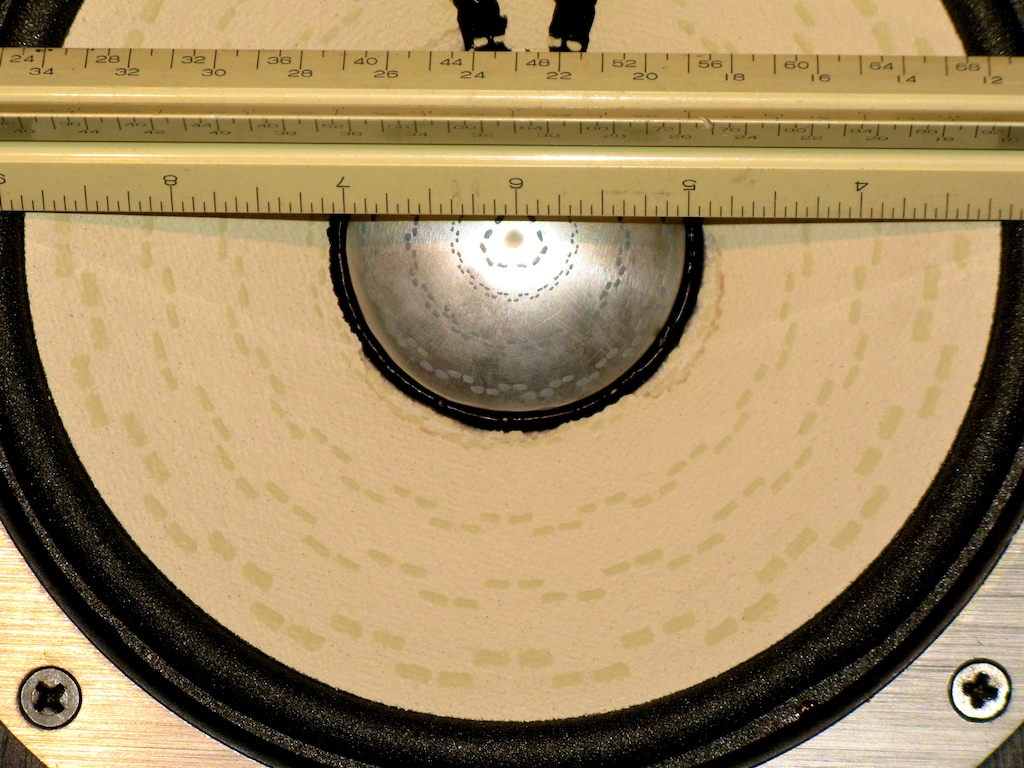

It's a pleasure to collaborate with you on these older drivers, Bud! 😉
It was quite surprising to me that the LE8T-H drivers could be playing absolutely smoothly and beautifully, whereupon after adding shunt regulators to the DAC circuit board the 'leading edges' of the signal became so challenging that the signal caused pervasive resonances in the midranges! The tweeters remained fine as they were. I think this demonstrates that the tweaks one might want or need are definitely dictated by what's on the other end of the speaker cable. So it's a step-wise process of refinement, as your approach clearly shows.
Since that last communication I did add one more ring to the cone but it was as near as feasible to the dome. The test track that I find most revealing by far is the Allegro from Bach's Concerto for 2 harpsichords, oboe, strings and continuo. [Track 11 - https://www.hdtracks.com/index.php?file=catalogdetail&valbum_code=HD00028947419921 (88kHz, 24 bit)] That oboe signal is *tough work* because there seems to be a resonant surface near to the oboe in the recording area. The latest inner cone ring on the LE8Ts smoothed out pretty much all of the little resonant trills. I like what I hear and would like to listen critically to a lot of different samples now before I decide on more paint. Piano, cymbals, bandoneon, tenor sax, (Willie Nelson's voice? 😛 ) ... everything else is completely mesmerizing.
[BTW, I have some raw F 126s that are just waiting their turn - no rush just now.]
On the photo I needed flash so the dome is tricky. The inner cone ring is somewhat obscured by a little bleeding of black dome glue solvent, but you can see it on the left side. I agree with what you said earlier that there are some strong advantages to a larger diameter midrange IF they are well behaved because you can cross them into a woofer almost anywhere you want at the demands of room acoustics and woofer performance. That's rather a luxury...
I wish you could drop by and hear this thing! (I wish my dad, who when I was a kid let me help build his Heathkits, were around to hear it.) A friend of a friend came over last night totin' some HD FLAC files he knew well. As they played, he kept laughing out loud because he could hear so much or because a coherent, punchy transient would shift him in his seat... 😛 So I'm deriving really great enjoyment from the process you have developed. IIRC, was it Terry O who once referred to LE8Ts as the 'holy grail of midranges'? With these mods I couldn't disagree...

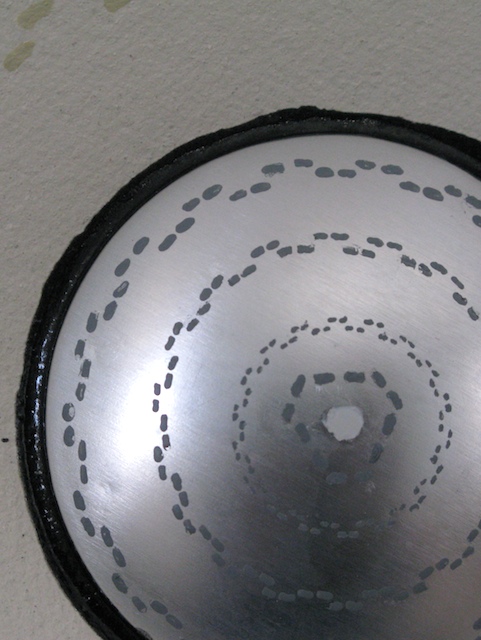

Thanks Bud and Alex!
A couple of follow-on points...
1) If there is still a problem in the driver per se, I want to base any decisions on the best possible data so I added a lovely reference to my library: Esperanza Spalding's "Chamber Music Society" (in 96/24). ...lots of reference potential in this well-made jazz recording.
2) Extensive survey of female vocals last night - nnnnnot much of a 'problem'! I also repeated the C. Bartoli tracks (redbook). This time I could hear more clearly that the opera singer was occasionally overwhelming the acoustics of the studio. [Plus, I'm willing to bet that I've figured out that oboe reference track. I think it's a music stand causing the reflections, because I can now clearly imagine when the oboist would look up at the conductor and clearly hear when they turn to look over at the violin soloist.] An inch away I can hear a tiny bit of smearing by the surround, but not from normal distances. The domes are bright but oh-so-clear. There might be a little 'glassy' halo around the sharper voices, like Christina Aguilera or India, or Misia.
3) Rear reflections within the sealed cabinets are a real possibility but they would have to come from the spider or baffle free edge. Everything else is quite shut-down. But I could damp and/or EnABL the inner baffle edge.
4) Every previous ring pattern I have added has helped. I'm getting tremendous energy transfer from these drivers! (...and tremendous energy 'packaging' by the DAC!) Today I'll add the 'in between' edge ring, follow up on Alex's suggestions, and possibly experiment with EnABL patterns on my left ear canal, which seems to have a higher impedance than the right. 😛
Well... my goodness, Bud! More "polish" is a nice way to refer to the effect of that last ring pattern on the driver itself. But that doesn't begin to tell the whole story. The listening "comfort envelope" has been significantly expanded - in the dimension of managing poorer quality recordings and in the dimension of being able to enjoy more volume or energy when the music calls for it. And these last 'details' in the iteration of mods, though seemingly small, are having a logarithmic impact in imparting the emotion and artistic impact of the music. I seem to be enjoying music more and forgetting to listen critically to the sound. 😀
Alex, the 4 basket legs are 8mm X 30mm cast aluminum - i.e. broad and stiff. For lack of anything better on hand, I padded them with about 8 mm of folded cotton medical gauze. I think it helped that touch of smearing I heard near the surrounds. Thanks for the suggestion. Now I am clearly up against the design limitations of my flat-sided DIY enclosures. That's the way we'll stay until I have time for a thorough literature review because my old bag of tricks is not that full.
