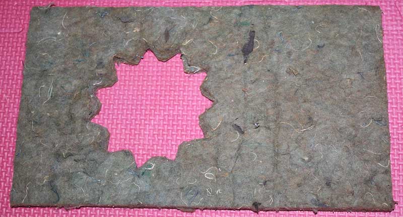

I would experiment with a multi-point star shaped cut on the inside circle cut of the donut to ease the transition and avoid any semblance of cavity resonances.
Like this?
dave

Like this?
dave
Pretty much, except I pictured more extreme points. What you pictured would be much better than a round hole in the centre, though, I would think.

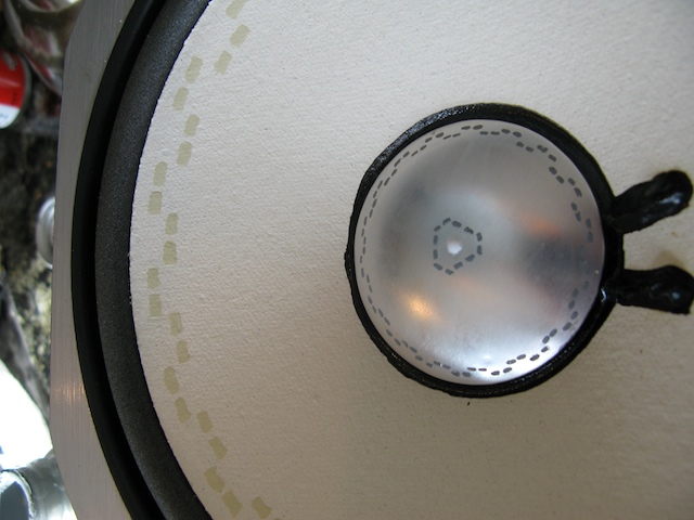

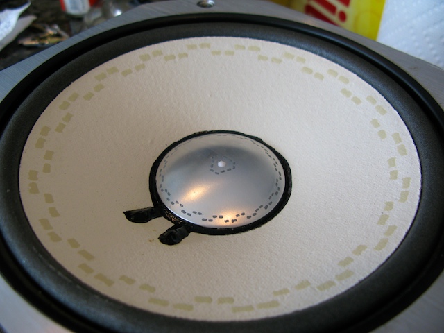

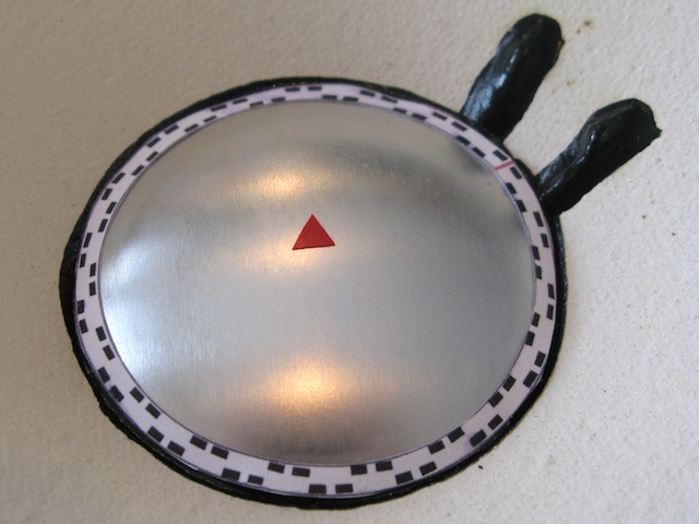

LE8T treatment - first steps
OK, here's how my EnABLed LE8Ts look thus far... I had been playing the drivers with a decent-sized electrical tape triangle on the domes and it helped significantly. Also, the central 'echo zone' of the domes, before any edge treatment, was fairly large. Thus, I went ahead and made the center pattern rather large. I was prepared to put a ring pattern on the cone just outside the dome but after putting the border pattern on the dome it seemed to also eliminate the small increase in cone resonance I had noticed tapping on the other side of the black glue. The particular radius of the outer dome pattern was where the resonance gradient became obvious. I don't know if it would be better closer to the margin of the aluminum, but now there is no resonance gradient so we'll have to audition them - starting later tonight. If highs are too muted I can either remove the acrylic and make the triangluar pattern smaller, or even bring the tweeter crossover point (fill-in, no filter on the 8's) farther down. I'll work through some reference recordings in the next few days and report back on the quality and personality of the sound.
Frank

Now you know.
When you turn your attention to the JBL 2235 the results will be a complete lack of noise in low frequencies, bass with an actual leading edge and texture everywhere. Transient attack will exactly match that of the LE8T.
Back to the the LE8T. I strongly suspect that a ring set, placed right after the curve flattens out onto the rest of the cone, will uncover yet another level of detail and liquidity in the sound field. You are fortunate to have a driver that is large enough to provide the weight of upper bass notes, without need for a crossover / woofer blend to help.
With the 4 inch drivers I have and a pair of slant line terminated transmission line bass towers I have from Planet 10, I can get that weight and power. However there are tiny miscues in perceived location within the illusion of a sound field, due to the driver offsets (bass drivers on the sides) that shorten the depth of the sound field to something less than 30 miles or so.....

Now you know. ...I strongly suspect that a ring set, placed right after the curve flattens out onto the rest of the cone, will uncover yet another level of detail and liquidity in the sound field.
I will add that mid-cone ring, maybe positioned just outside the coil leads. Also there is now an obvious need to center-treat my 1" silk dome tweeters (Morel). They stand out in the 'sound wall' as foci of HF information.
FWIW, the treated LE8Ts now *seem* to output less upper-bass than before. Attack and fidelity of the 15" woofers has always been very pleasing, each channel originating from a WM8741 DAC chip in mono mode into separate balanced amps. BUT... I found an HD recording that the 2235s don't follow well so later on I will consider this specific flaw and its correction. [It's Ron Carter's acoustic jazz bass in Rosa Passos' - 'Entre Amigos' (96kHz/24 bit).]
Also FWIW, my standards and performance targets are primarily dictated by HD recordings. The midrange+HF channels (to the LE8Ts + tweeters) originate in a TPA Buffalo 2/Legato (one sweet DAC!).

Silk dome tweeters respond to EnABL like no other form of tweeter. If you place a ring set at the very beginning of the actual dome and the triangular six block pattern, with tiny PVA dome at the tip of the dome,just as you did with the LE8T dome, they will have almost a 180 radiation, unless there is a focusing horn.
For flat plate mounted domes the addition of a 50% or less mix of gloss to pure water will bring that radiation to a true 180 degrees. In amy event they will disappear, high frequencies will be buried in information, with leading edges no longer disassociated from the rest of the musical event.
