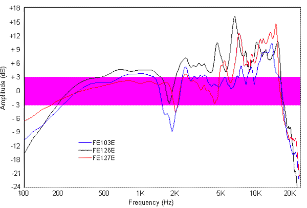

Please excuse, but...
This pic shows the 127 driver having a remarkable flat response between about 150Hz ans 1.5kHz (+/- 1.5dB) then it takes off at an approx linear 5dB/Oct up to about13kHz, then suddenly drops off about 15dBoff.
Is this normal for this driver, or is it the way the measurements are done (mike? baffle size?, reflections?, etc), or the amp's response, or ....?
Doesn't seem reasonable the way it's shown here.

jameshillj said:This pic shows the 127 driver having a remarkable flat response between about 150Hz ans 1.5kHz (+/- 1.5dB) then it takes off at an approx linear 5dB/Oct up to about13kHz, then suddenly drops off about 15dBoff.
Denis' graph is of an FE126... and i'm still not sure that something isn't quite right. Be nice to see what happens off axis with Denis' kit.

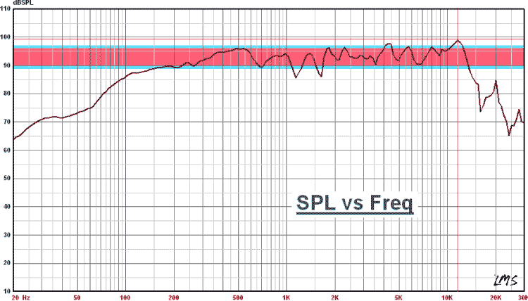

Here is an on axis FR of an FE127eN taken by Mark Fenlon in the anechoic chamber he has access to.
dave
Even assuming some differences in measuring methods, the change in the performance it startling - so this is actually what the EnABLing does - nothing suble about the transformation, either.

This is what EnABL and Planet 10 processes together, do to a Fostex 127 driver. The 126 is a different kettle of fish and while the peaks are contained, that driver is just a lot more explosive than I am willing to listen to. Very much like a Lowther DX4 and A45 drivers before or after treatment. Meanwhile, the Lowther PM6A, 16 ohm silver voice coil, is a wonderful driver treated and not at all bad, but for a bit of shrieking, before treatment.
The loss of the peaks in the 127 are from application of songsc's discovery of how to use the patterns to eliminate the nasty peak on the Jordan JX92s drivers. His comments are ones I pay very close attention to, but he teaches in the oriental way, you have to think about the subject before you begin to see where he is pointing you.

The Horn Shoppe folks were discussing the relative merits of treated and untreated 126 drivers and the comment was made that an EnABL'd 126 was very similar in character of response and loss of shriekiness, to a well aged, untreated driver.
I wonder, looking at the factory vs EnABL plots for the 127, how much age the factory driver had when tested, and if this "aging" is an actual change in the driver response due to materials fatigue? I had always assumed it was just the normal adjustment made by our threat correlator and conscious mind, to what was assumed to be "normal" performance, after a period of time.
The HS folks did remark upon the much lower threshold for downward dynamics found on the EnABL'd drivers as not being available from a well broken in driver, but that in overall presentation, they were very similar. And this without the Planet 10 improvements.
