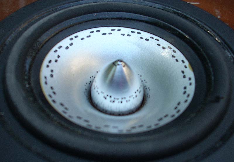

Here is a larger pic of 871 (these in black)
dave
planet10 said:
And even thou out-of-focus, probably informative
Because this 871 is a 3" I need to ask:
Which nib are you using to get that fine of dot? ( hope the pic reprints.)
On my 3.5 inchers I'm not getting things small enough. I can put on a trace amount but that isn't getting anywhere. But a full dot spreads to beyond the template.
Other thing I am going to try eventually is decorating the phase plug I made for the Pioneer. My technique is not very good yet.
