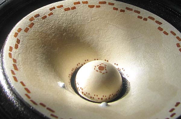

ugh. i really hope its very very forgiving! this driving is soo small esp the one around the phase plug. some of my dots blurred together into a line. i even went to use a needle!
nukaidee,
No caffeine for at least a couple of hours before you try to do the patterns. These tiny movements are just too hard when your nervous system is hopped up. When the paint on the phase plug dries, use a pointed wooden toothpick to scrape an opening back into the line. If you are very careful and your hands are steady you can use the point of an exacto knife, laid over on it's side so that the edge angle is flat to the cone, to pick out the center section of paint on a cone.
You might stop back at that hobby shop with the paint and see if they have some cheap magnefier glasses. Made of plastic, with a flip down set of plastic lenses to add to the ones that are permanent and an adjustable head band, they will fit over glasses, are cheap, and make the small dots easy to do, well, easier to do.
Bud
Bud
lol. no caffine for me ever. i wonder if i can take that paint off with alchohol.. i will probably have to try again. its the curve that makes it that much harder
Alcohol and a Q tip will work well on the phase plug. Might remove the aluminum paint from the cone though. Isopropyl, 99% pure is the best for this and in one or two droplet amounts, can keep the paint liquid for years. Just remember to always wipe out the lid and the top of the bottle before you begin to use the freshly shaken paint. If you put it away unclean the seal will not mate properly and the paint will dry out rather quickly.

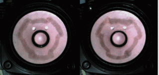

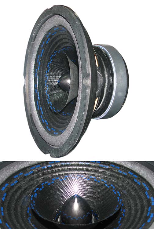

planet10 said:A double row of 3 pairs -- 12 spots all together.
I like to put a spot under the PVA too...

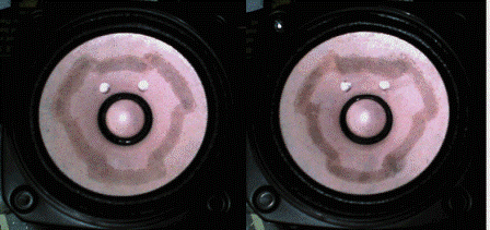

so I've tried to remove the enabl dots with rubbing alchohol.. apparently it doesn't remove it =( so i took a knife and tried to scrape it apart such as Bud suggested, some of it worked, but i think its pretty dangerous. however.. even with all this ugliness and mistakes. i can definitely hear a difference. =)
One of my test speakers has not ribs but circular brush strokes from the Modpdge, thick version. I was skeptical on even playing it. Now i think I will connect it up.
I find it useful to have q-tips and a bit of water at hand for glitches like the merging of 2 dots. I find that it is best to just let the Q-tip suck up the paint while still wet. Trying to rub it off right off the bat can make the mess worse. This is one of the bonuses of having a pre-coated or metal cone -- it is possible (to mostly) to recover from glitches.
