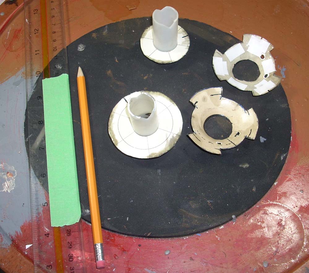

loninappleton said:Where is the picture of the trifoil pattern template?
Patience grasshopper.
4 generations of templates shown. The most recent 2 are made from donor FE127. The most recent has slits and bridges to make it lie flatter on the cone.

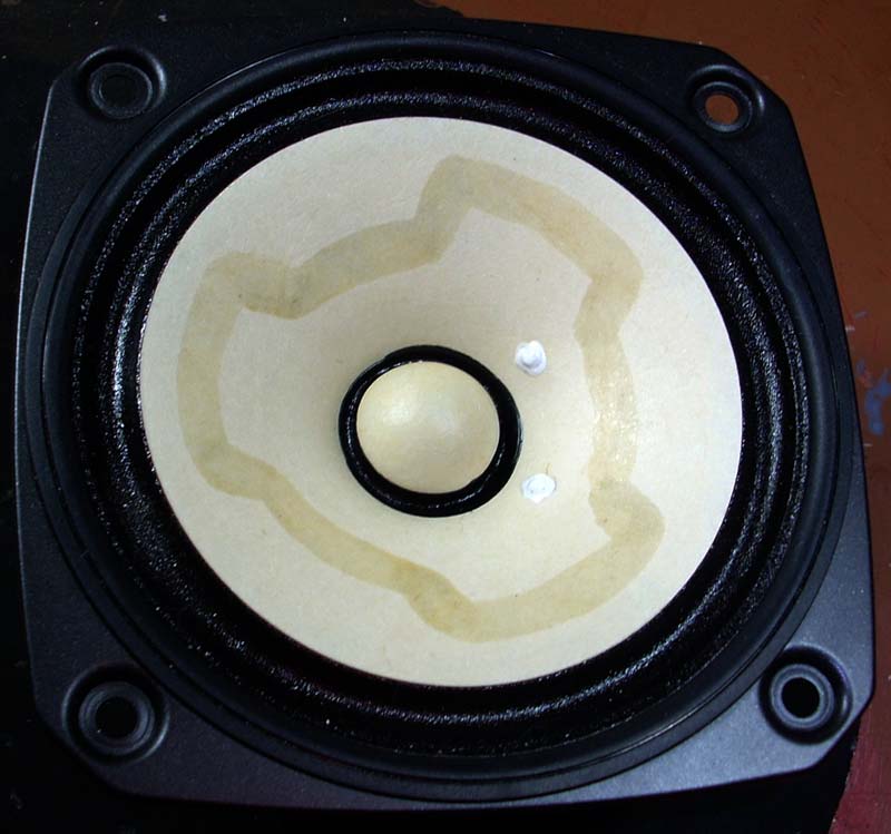

loninappleton said:Where is the picture of the trifoil pattern?
A driver-in-progress from my bench with just the trifoil applied

"Radial" strokes are from centre to outer edge of cone/dustcap brush strokes. "Arc/sweep" are the circular painting strokes.
"Lazy Susan" is rotating flat plate support. The Calligraphy pentips are used with "the 2 tips to surface".
Still unclear -
Before the PolyScale " EnABL dots" are applied, the cone/dustcap has 1, or more, base coats (of the ModgePodge) applied, and after the dots, the finish coats, yes?
- and if the Trifoil pattern (Danmar Varnish) is used, this also has a base coat applied before the pattern, and then the "EnABL dots" are applied directly on top of that, followed by the finishing thinned "ModgePodge" coating(s)?
Trifoil (Danmar Varnish only?) <-> extra "centre cone" ring of dots?
As a total novice, I find myself having to seperate the different parts of the EnABLing system into what appears to be 5 seperate processes.
1.Trifoil pattern (and/or Pretreatment) 2. Cone surface painting(s) 3. Dustcap/Phase plug surface coating(s) 4.EnABL pattern application 5. Final coating(s)
Does this make sense?
Still unclear -
jameshillj said:As a total novice, I find myself having to seperate the different parts of the EnABLing system into what appears to be 5 seperate processes.
Speaking only on the FE126/127
We have two processes, each taking a number of steps:
a/ pretreatment
1/ trifoil (uses damar)
2/ 2 thin coats thinned puzzleoat
b/ EnABL
1/ spots (outer ring (72). dustcap rings (2x72), centre rings (13)
2/ 3 coats 59% gloss (only 1 on the dustcap)
3/ PVA spot on the tip of the dustcap
4/ coat just that with just a small brush of gloss.
5/ add the "stealth" spots -- mid ring (72).
